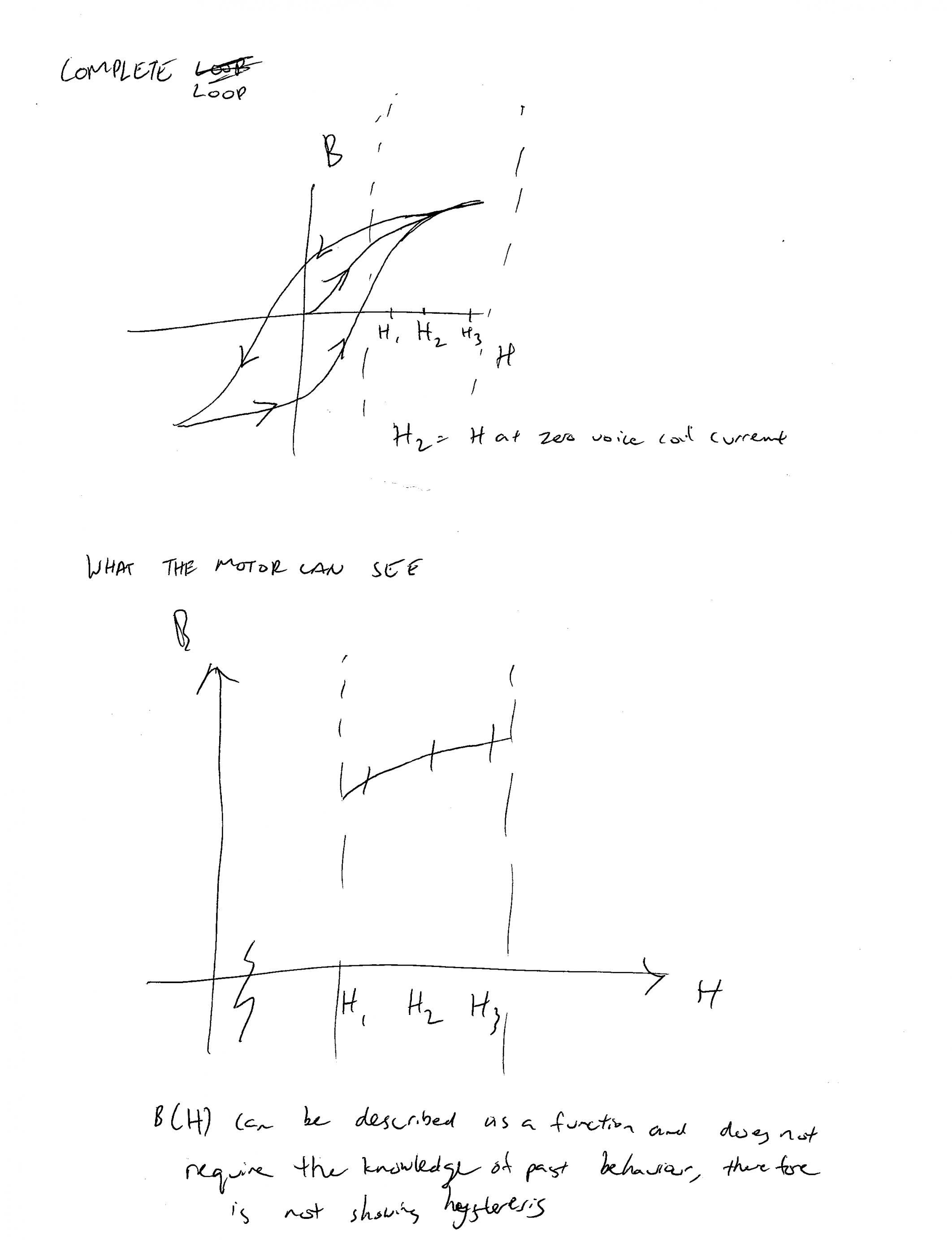

Then I guess I'm being dense today. To say that B is non constant is to say that the DC operating point is driven somewhat by the AC signal. This may be true but doesn't require or force nonlinearity. If all the materials in the structure were hysteresis and nonlinearity free, then the opperating point could be somewhat soft and we might see a level drop from the theoretical output, but no distortion because of it.
Finally, I can imagine a system with nonlinearity but free from hysteresis, but why would we conjecture this to be the case when we know that hysteresis is present and inherent in the magnetic material?
David S.
Maybe we are not talking about the same thing. I hope this makes sense. Pardon my calligraphy.
Casull
Your understanding is the same as mine. Between H1 and H3 there can be a small hysteresis loop, but the major effect is what you show. It has to be remebered that the flux changes act instantaneously and so will distort the waveform not just change the gain.
Hysteresis in the steel is completely insignificant.
