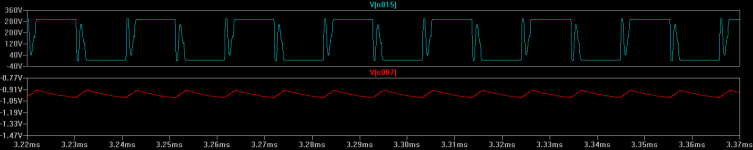

Hi all,

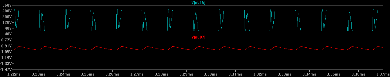

I am working again over average current mode control with half bridge. And I am surprised again from unbalanced currents in the output. I start reading again and I found confuse in this two well known papers:

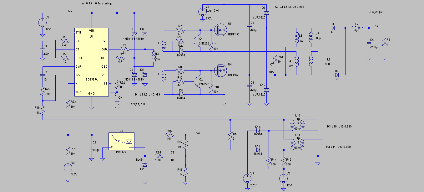

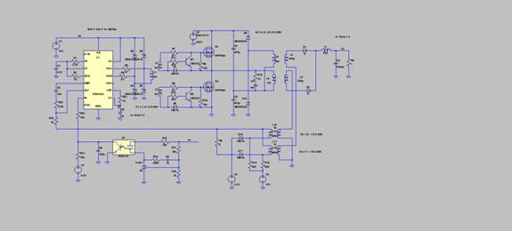

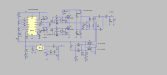

There is another way of doing it and that is to set up a voltage divider to give half voltage and use that as a reference signal to test the half bridge centre voltage the error can then be used to alter the set point of the current comparators. The schematic is too small to read.

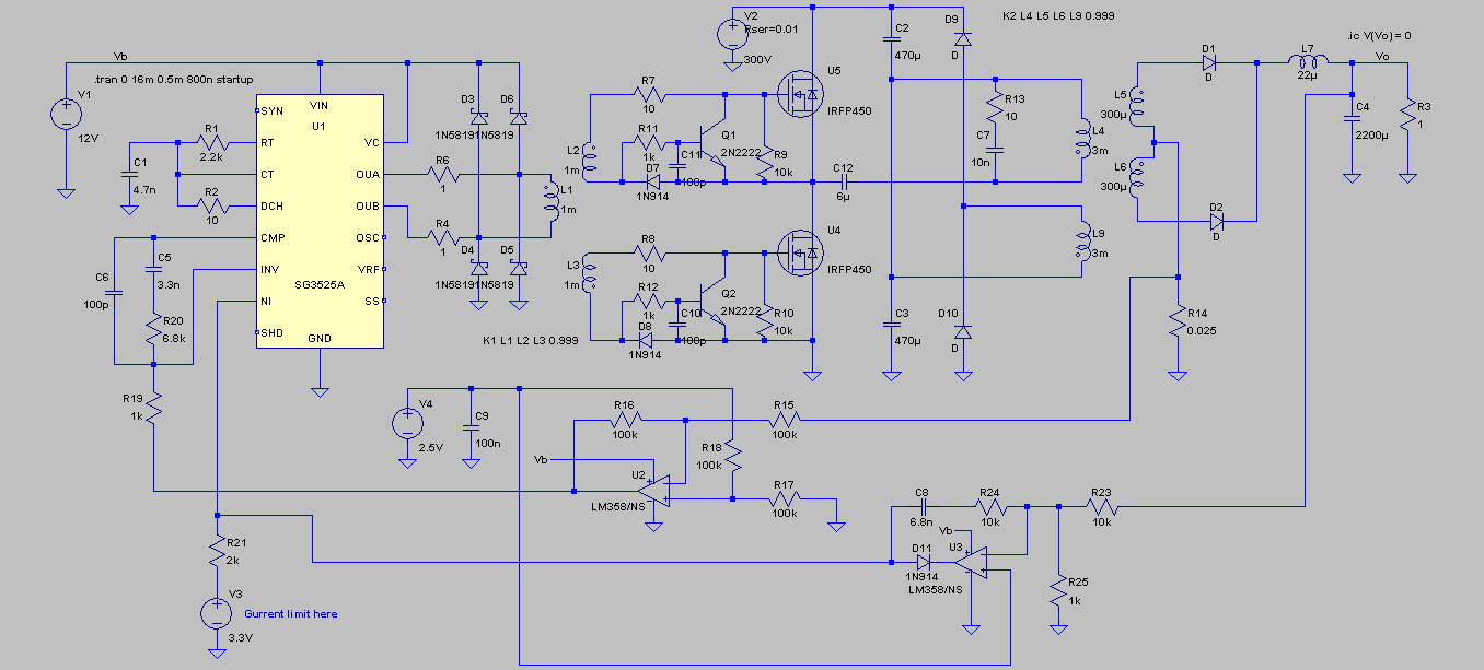

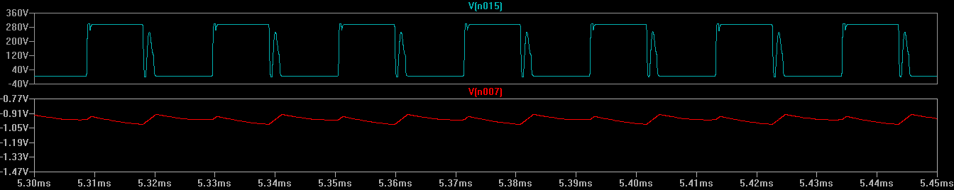

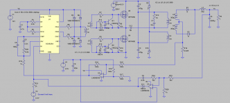

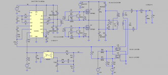

I’m sorry, its very small indeed. This is a bigger and worked variant. It works even without the additional winding and without series cap. But when I try to measure currents with current transformers then after a while the circuit start behaving like pure “one transistor forward”!
I was expecting to see current sense resistors on the drains of the switching devices.
Using transformers to sense current in a system with possible DC can be a problem, saturation of the CT core is one problem the other is saturation of the main transformer core reducing the coupling to the current sense winding (secondary I believe in this case). Using current transformers designed to handle some DC might improve things. This type of CT is common in AC variable speed drives but they are often quite large. A hall effect current sensor might be an option as well.
I have not looked at the AN or data sheet for the control chip so I might not fully understand your circuit.
CTs handling pulsed DC are quite typical in SMPS, and they do a fine job. A diode is used on the secondary, so the burden resistance is effectively very high in the reverse direction, allowing magnetic reset.
Anyway, flux walking with a coupling capacitor doesn't happen. You're fine. There's no good way to control it on an SG3525, anyway -- you aren't given a differential balance, you'd have to inject charge into the timing capacitor every other cycle, and you don't know which cycles those are until it happens.
