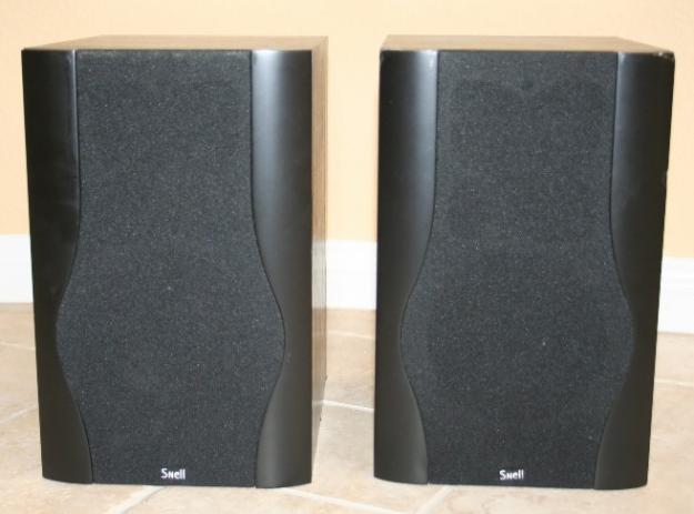

Avid did a "low diffraction" series that did this. At Snell I designed a QBX series that had the grille flush into the baffle. Where I had to cut a recess around the tweeter I gave it an irregular 4 lobe shape to randomize the reflection distance. In the photo, that is the faint butterfly outline that you can see on the right speaker. This worked very well.
Good luck with your approach, it should work well.
