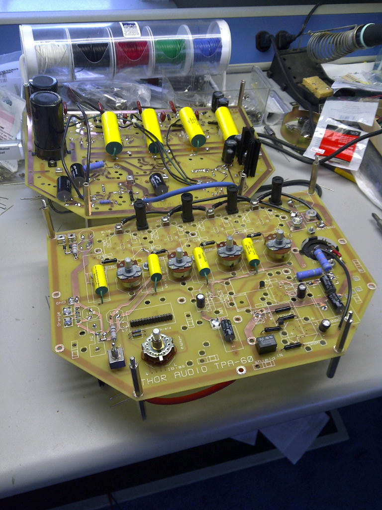

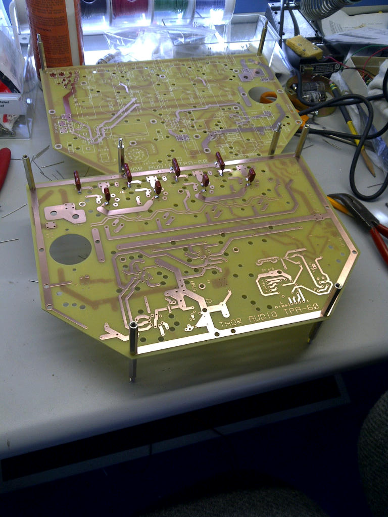

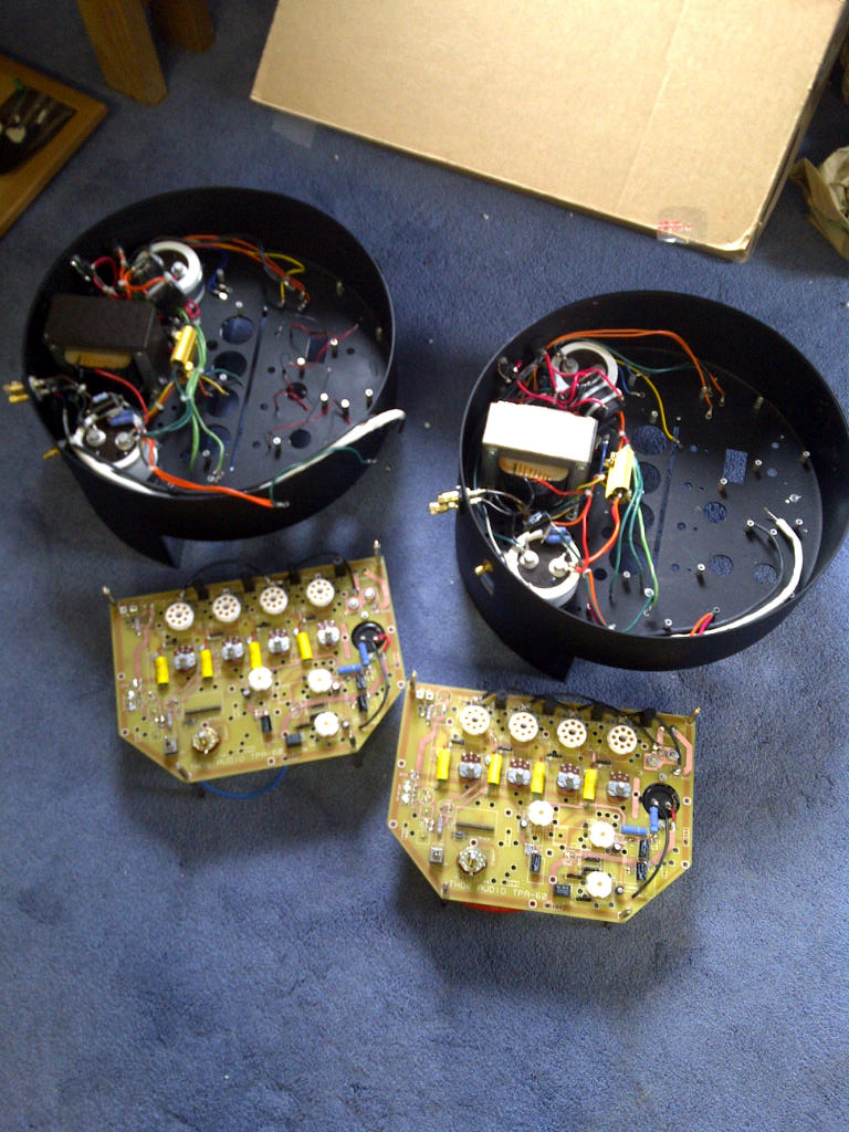

Plasticisgood: The amp has a built in LED meter to read the bias on each of the 4 tubes. Flipping a switch shunts the input to ground and allows me to read and adjust the bias on each tube individually. With all pots turned down I got the following readings from left to right 0.68, 0.97, 115, 140. If I switch the tubes around the value of that tube pretty much stays the same without regard to what position it is in. I am attempting to add some pics of when the amp was rebuilt. I don't have schematics but could possibly get them from the tech.
This amp has completely new boards installed by the new owner of the company. It is the only pair of amps with this new board and they installed most of the old components on to it. I don't know the age of the amps but probably only 6 to 8 years.
