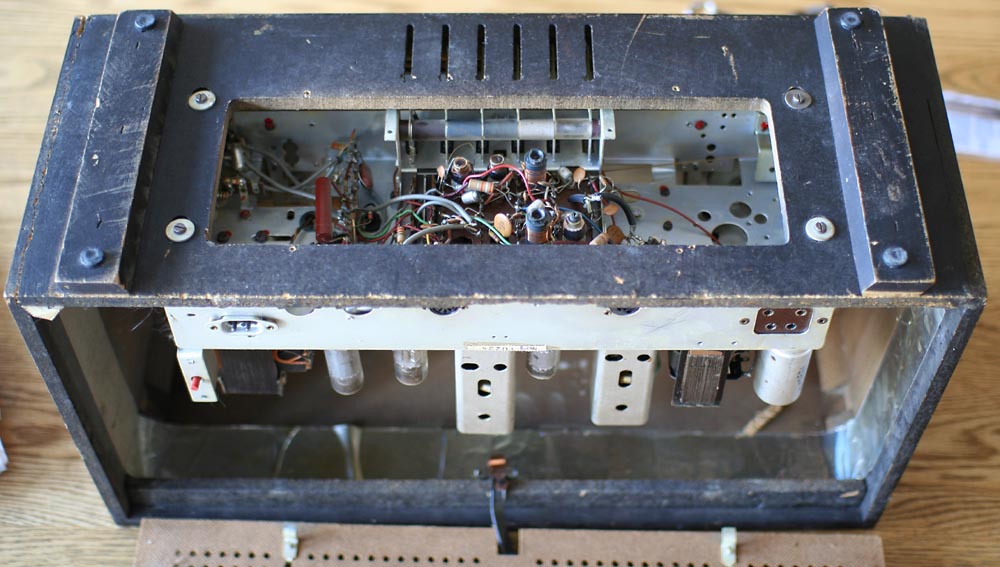

I came to the same conclusion. If any of the tubes are original the numbers and brands may give a clue to the radios origin. Is there any information on the back panel? Tube chart? The two prong plug receptacle isn't too uncommon and looks a lot like the one used of just about every TV set made from the late 40's through the 70's.
OK, I've worked out that it was made in Yugoslavia. It has a sticker on it from the Canadian certification people. No dates.
There's a safety interlock, a red push button held in by the back cover. There's also a notice on the back cover referencing a circuit breaker too. Seems like two good safety features.
The tube compliment is shown: ECC85, ECH81, EF89, EABC80 and an EL84.
There's also a tube EM84 strapped sideways against the front grill.
Speaker is 4Ohm.
The red push button IS the circuit breaker. The safety interlock is the two prong power recepticle which should mate with a power cord attached to the back cover. Remove the cover and there is no power inside the radio. This was standard on US made TV sets for 30+ years.

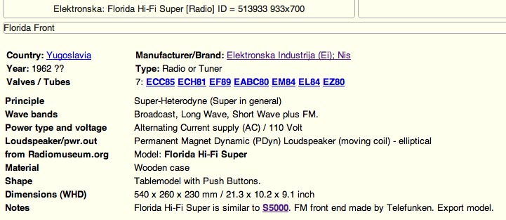

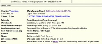

Davorin,
Thanks for the lead ! - I found some information from searching under Ei-Nis. Seems the factory is still in business and making tubes.
The radio I have is called the Florida Hi-Fi Super, made sometime around 1962. It's a couple of years older than I am.
If you have a schematic that would be of interest.
