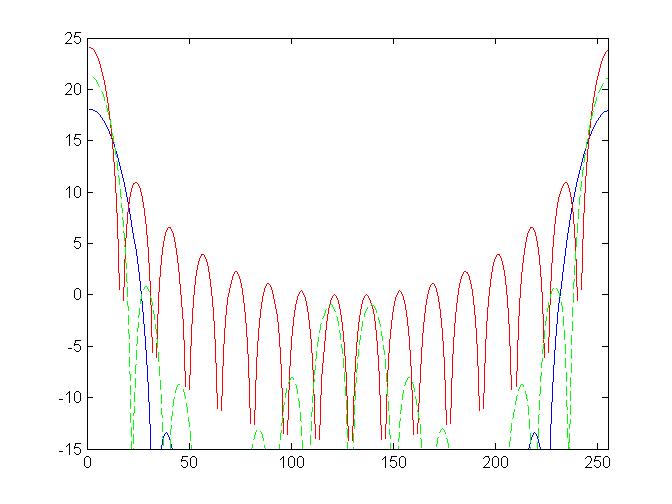

Array weighting
Here is a little bit of a look at weighting schemes.
These are quick simulations of 16 element arrays, similar to the one I developed at McIntosh.
The plot is of the FFT of the weighting sequence. As such it gives the far field polar response of the array, at least for an angle sequence ranging from the front lobe to the first alias lobe.
If you are not familiar with array theory, arrays with a constant spacing typically have lobes that develop at the 90 degree angles and bend inward at higher frequencies (this is why we like to have good point density, i.e. lots of small drivers). Whatever the frequency of your polar, you will see this pattern mapped between the 0 degree point and wherever the first lobe is, then again from the first lobe to second, etc..
The takeaway is that looking at the weighting sequences we can compare the relative width of the front beam and the level of adjacent side lobes. A clean pattern with low side lobes is best.
Near field performance will be related to this but the lobes will be much wider (good).
Shown are 3 schemes for the shading of the 16 tweeters.
Red is 16 elements of equal strength. It has the highest gain (24dB over the strength of 1 tweeter) but the narrowest front beam and highest side lobes. This is what you get with an unshaded array.
Green dashed is the the McIntosh array. It was a simplified approach with 4 drive levels across the 16 tweeters. The drives were .3 .3 .7 .7 .9 .9 1 1 1 1 .9 .9 .7 .7 .3 3. That is the center tweeters were full strength. The first surrounding group was -1dB. The second surrounding group was -3dB and the outer group was -10dB. You can see it only loses a little bit of level on axis (maybe 3 dB) and is a little wider and also has a first side lobe of over 20 dB down. It comes back a little in the middle because I have the tweeters arranged with paired coefficients (the .3 .3 .7 .7, etc.). If those were split into individual weights then the middle rise would improve, but it is of no consequency in the near field at typical listening heights.
The black curve is a 16 coefficient raised cosine weighting. It has lost nearly 6dB from the unweighted array. It has clearly wider response and exemplary side lobe performance.
You pays your money and makes your choice.
I hope that makes sense and gives you a flavor for how this all works, and again, the far field performance that this represents looks much worse than performance nearer in.
David

This is essentially a polar plot laid out as an XY rectangular plot. The left edge is the main lobe of the array (or at least half of it) and then to the right is the polar response as you move left or right of the on axis beam.
Now the width of this scales with frequency, but the basic shape is constant for all frequencies. For low frequencies the whole polar may just be defined by the first lobe of the plot. For higher frequencies the curve compresses (in polar space) until the full plot is contained in the 0 to 90 degrees of a polar curve (the emergence of the first major side lobe). At still higher frequencies you will see repetitions of the pattern. In theory the back half of the polar is identical, except for the fundamental polar curve of the drivers themselves suppress the back radiation.
The vertical axis is response level for a given angle and is relative to a the strength of a single element (a single element is 0 db).
This is probably hard to absorb if you haven't played with array modeling but looking at the diagrams of my McIntosh paper should clarify it some.
David
If I'm reading this right:
1) the unshaded array is sending a significant fraction of the output into the floor and the ceiling, about 80%
2) The McIntosh array isn't sending much into the floor and the ceiling, but there are strong lobes off-axis. IE, there are vertical angles where the output is significant.
3) The newest array is almost like a flashlight. Nearly nothing is hitting the floor and ceiling. But the price is efficiency and maximum output. (I'll bet the crossover and processing is more complex also.)

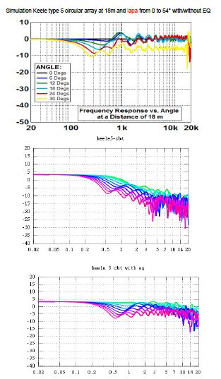

I'm sorry, I come late on this topic but I have a basic question abour Keele's CBT.
I did simulations with my own software of various Keele's arrays presented in the 2011 AES paper "Performance Ranking of Loudspeaker Line Arrays", using same number of speakers, distances, angles,...
On some of those arrays, I don't get at all same results (see two examples). Especially for the one he ranked as best, the CBT circular shaded. Ie, in that special case, I have to eq considerably to get comparable responses.
Maybe my software does somethings wrong but when I compare with other published simulations (Ureda, Button, QSC), I get same results.
So, I'm interested if somebody has done same simulations (Dave ?) and got same curves as Keele's.
The whole set of Keele's array : here
If someone is interested, I can also give impulse responses of those simulations.

Hi jlo,
Sorry but I have not made cirect simulations of Keele's designs and have tended to take his data at face value. Your simulations look somewhat like his but clearly exhibit differences too.
I do see that Don is plotting normalized plots, i.e. he subtracts/divides every curve by the response of the zero degree curve. Is it as simple as that?
What program are you using? Do you have any code you would want to share?
If your simulations match others well then I assume your approach is good and likely yours and Don's are based on different assumptions. You might contact Don at his web site as he is generally aproachable and would probably be interested in comparing designs.
David

I'm afraid it is'nt, because even when I normalize, I get different results from DB Keele.I do see that Don is plotting normalized plots. Is it as simple as that?
You're right, I should contact him, thanks for this good idea. I remember his study of Bessel's array : I got exactly same curves for some arrays but not for all Maybe I haven't understood all his assumptions or maybe my simulations have to be improved ?
It is my own program and I cannot share it now due to some NDA's.What program are you using? Do you have any code you would want to share?
But if somebody wants me to simulate one special case, I can easily do it for a max of 16 point sources or 16 arrays of each 50 "Huygens" point sources.

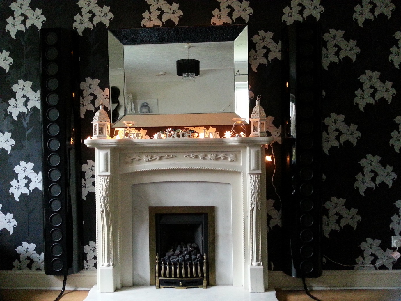

I have attached a pic of the LA 16's.
Can your software cope with the following scenario?...:
We are testing large panel arrays for live sound applications with up to 60 BMR's per panel (12 BMR's tall by 5 BMR's wide) with a separate sub below each panel (Xover 80Hz). Depending on size of audience we can stack the panels to create giant line arrays.
Each panel has 1 mic feed ie one panel on vocals, one on drums, one on keyboards, one on lead guitar etc.
Would you be able to simulate this...?
Thanks and all the best
Derek.
