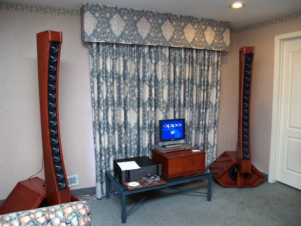

I have mor or less settled on the quasi infinite array, and this comment from Monte Kay on his home page mfk-projects theater main speakers pretty much nails it:
The main left/right speakers are "near" infinite line. The array is 8' tall mounted 1' off the floor thus leaving a 1' gap between array and boundary at each end. There are eighteen Dayton Reference 6” truncated frame mid-bass drivers and forty two 2” Aura mid-tweeters in the array. Originally no shading was used but with encouragement from Don Keele I later added Hann shading to the array. I no longer believe that shading is the best approach nor is CBT. (Sorry Don) I believe instead that in a situation where a true infinite line is possible, it is the better approach. Problem with any line array other than CBT is that they only work well if the listening position is in the center. With an infinite line, no matter where you are, you are in the center so problem solved. Where infinite line is not possible however, CBT is definitely the best approach. I view the CBT as the perfect solution for finite line arrays, in fact CBT is really the only mathematically correct way to build a finite line array.

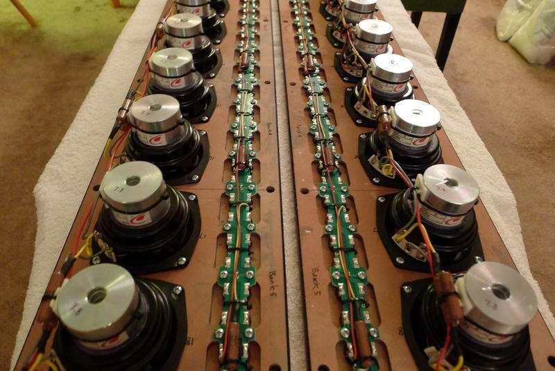

I've currently got a pair of floor-to-ceiling arrays in my living room. They use thirty 3" full-range drivers a side. Below 80 hz my subs take over. The speakers sound very nice: they sound very big in a natural way, cause little listening fatigue and I like that they don't get much louder as you approach them. However, I do miss some precision and detail. They don't have that see-through quality my unidirectional (cardioid + waveguide) speakers have. Perhaps that would be better if the speaker had tweeters as well.
Interesting, could that be because of high frequency lobing due to the full range drivers? I also think of starting out with fullrangers and maybe add tweeters later.

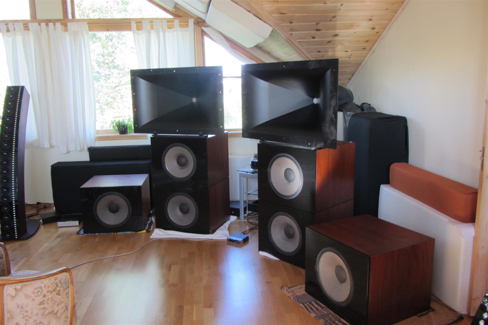

Omholt:
Nice horns! Are those Klipsch K-402? What drivers are you using? Unfortunately I don't have room for horns in my living room for the time being. I'll try line arrays to have horn like sensitivety and headroom in a small foot print.
Omholt:
jeno:
That's correct. Klipsch K-402. I'm temporarily using the K69 original driver while I'm waiting for JBL 2446 with Truextent Be to arrive.
I'm sure you will pleased with a CBT or an infinite array (if latter measures as well or better). So far and without the best EQ settings for K-402, I would say CBT36 and the K-402 sound more similar then different. In this room and with this spesific placement, the early reflections are taking care of without any treatment with both of them.

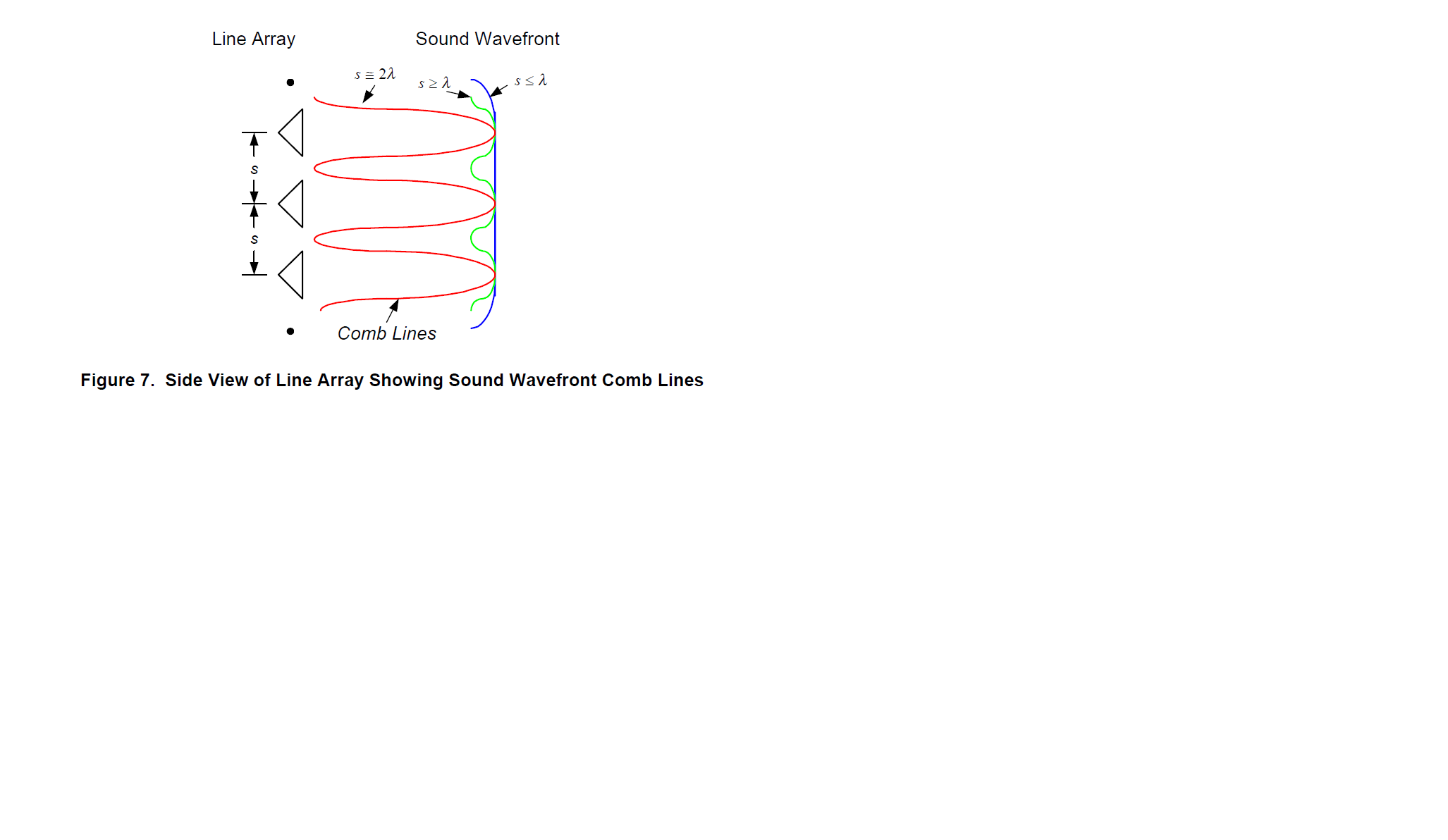

It's basic geometry:
If you have two sources playing 17,000hz, as soon as the pathlength difference between those two sources is more than half a centimeter they're going to interfere destructively.
With a line array, that's basically every position in the room.
This is why we have curved arrays and why we have shaded arrays. You can't change the fact that the two sources will interfere, but you can reduce the effect of that interference by moving and/or reducing the level of the other source. Amplitude shading and curvature does that.

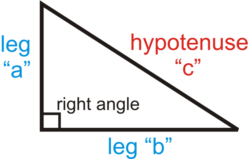

This is basic pythagorean theorem:
The distance to the top of the array will be longer than the distance to the center of the array. The center to center spacing doesn't change that.
You could have a center-to-center spacing of 1/4", and that would still be true.
