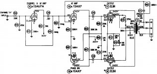

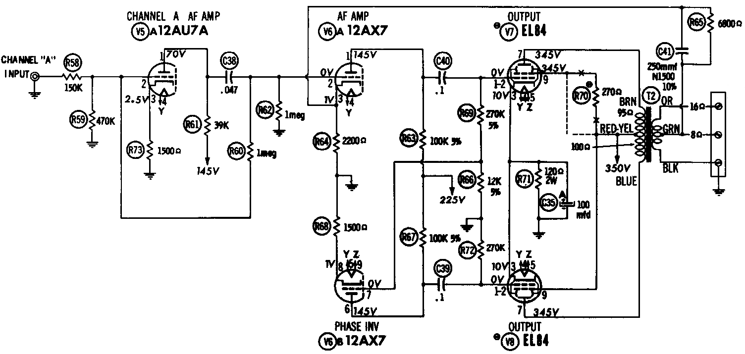

Here's a circuit I'm emulating and for the life of me I can't figure out how to adjust the gain of the second tube. I would think R9 would control the gain but that's also the grid resistor for the output tube. I would have to change R6 as well to keep the output tubes grids the same impedance. 😕 But that puts me back where I started.
Your circuit reminds me of the Pilot 232 circuit, minus the 12AU7 line stage section. It's not a "floating" paraphase but still paraphase. The value of R66 is crucial to the balance of the two phases. I would use 220kΩ for R69 in series with a 50kΩ pot to equate 270kΩ of R72 as the grid leak. Adjust wiper of pot to get the balance.

Thank you for that. That just showed me how easy it is to apply negative feedback to this type of PI when a common cathode resistor is used.Hi, looks like you don't like too many parts. Check out this schematic:
directdriver - That looks ALOT like the Magnavox circuits which also sound very good to me but Magnavox does some really weird stuff with it. Your right about the values though. The standard paraphase is picky. The floating paraphase, on the other hand, seems very forgiving in the emulator. I can just about change any value 10% or even 20% with minimal effect on the gain or balance.

If you look at the schematic in the first post, each of the 12AX7 cathodes have their own cathode resistor. I currently have it wired as shown below. What are the pros/cons to having a single cathode resistor? I'm guessing that the shared load alternates back and forth and the use of a capacitor isn't needed. Is that correct? Or should I have the cap (C4) in parallel?
A single unbypassed resistor will introduce some positive feedback. Not necessarily dangerous, but it gives me the willies nonetheless.
Your PI is still rather unbalanced, due to R4.
It dawned on my to measure the AC voltage on R3 and there's only 10mv when the circuit is putting out 30vac per phase. That's what I had assumed.
Adjusting only R4 didn't help balance the PI. It's a combination of R4 and R9. Lowering R4 and raising R6 helped but the values start to get really touchy.

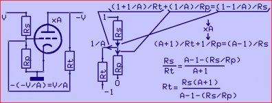

You don't adjust it, you get rid of it! Throw it away! That resistor is why it's so bloody touchy!
The circuits of Merlinb May 2006 and Cassiel Feb 2014 didn't have the R4 to GND.For such case I showed the relation of the two resistors in function of the tubes gain.
Your last one did have a resistor to GND.That changes things.A drawing + formula derivation.

If I "eliminate" R4 (as in remove it) then there's no grid resistor on V1B.
If I "eliminate" R4 (as in short it) then V1B's grid is grounded.
Can you elaborate?

Both drawings have an R4 from V2B grid to ground. The main difference between the schematic in the first post and the second one was the common cathode resistor.
