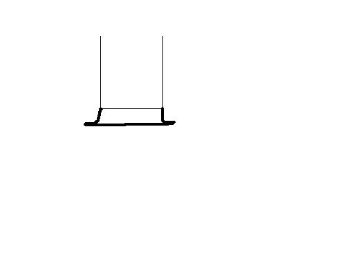

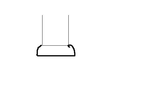

I found something that might act as a mold for me but does the shape of the flare matter?
this is what the shape will be like:
The shape does matter.
Theoretically there are many profiles that can be used for a flare, however the tests I've done are all based on a circular profile.
If you were to move to something else, say for example, an exponential flare, the rate of expansion would be different.
This would need a whole new set of tests to accurately find the usable velocities.
However, the change in usable velocities would be more for large flares than smaller ones.
Since the heat flaring method is only good for flares up to 25mm, I imagine you would still get good results provided there were no sharp bends in the mould.
regards
Collo

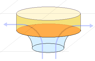

I assume you are saying that the intake flare is 2 inches from the top of the cabinet.
Normally you try to leave a clearance around the port equal to the diameter of the port - in your case 6 inches.
If it is just a matter of making another front panel with the port exit 4 inches lower, I would do it.
If your port lengths are already cut, but moving the 90 degree bend further towards the back of the box could fix the problem, I would make a joiner.
If you are truly stuck with the design, have a look at the cross-sectional area presented to the air as it flows between the flared end of the port and the box top.
on the attached drawing....
Area of flare exit shown in red = pi*r*r = pi * 4 * 4
Area of cylinder above port shown in yellow=circumference*height=2*pi*4*2
They're the same, meaning the air doesn't have to change speed as it flows around the end of the port. Not ideal, but you'll probably get away with it.

phillfyspoon said:
instead of this:
haha poor drawing i know
Try borrowing a bowling ball or similar sized ball to get the flare shape.
