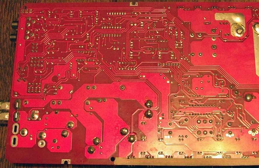

There must be something wrong in that area. Can you post pic of amp where this TL is and it's surrounding components are?
I think that you are getting shorts on primary, as one side does close (not great looking waveform 🙁), but still they probably do. Other side is always on. If pins 9 and 10 don't go low at anytime, then TL is dead. If they do, you probably do have buffer(two transistors that are driven by TL, and drive fets(irfz's)) after TL, it is possible that one of them is not working (the one connected to + input rail).

Here are the PICs. The TL494 is the one above the black rectangular thing. Haven't got a clue what that black thing is - no markings on it...
The pic of the bottom of the board is with it flipped horizontally, not vertically.
I can do much better closeups if need be, but it looked like you could see enough detail in these. Well, that and the fact that this website only lets you upload 100k byte images with a max of 1000x1000 pixels. Odd, I can't see any reason to limit BOTH size and resolution... Oh well.

Hi
Left from TL there are 2 pairs of transistors, 2 pair od buffers that drive gates of fets. If TL drives this buffers ok, then check if this buffer drive gates of fets right. If they don't they may be damaged but there could be some other thing, like only one of fet is dead and it does appear like all of them are. Signal on fets should go from GND =0V to Vbat =~13v and back again with freq. at wich smps operates.
If you can't find any error from output of TL to gates of fets, you might consider removing all fets, check signals of buffers,... then put in two good fets, one on each side and work your way from there. I think that one transistor in buffer that drives side of fets that is on at all time, is damaged.
