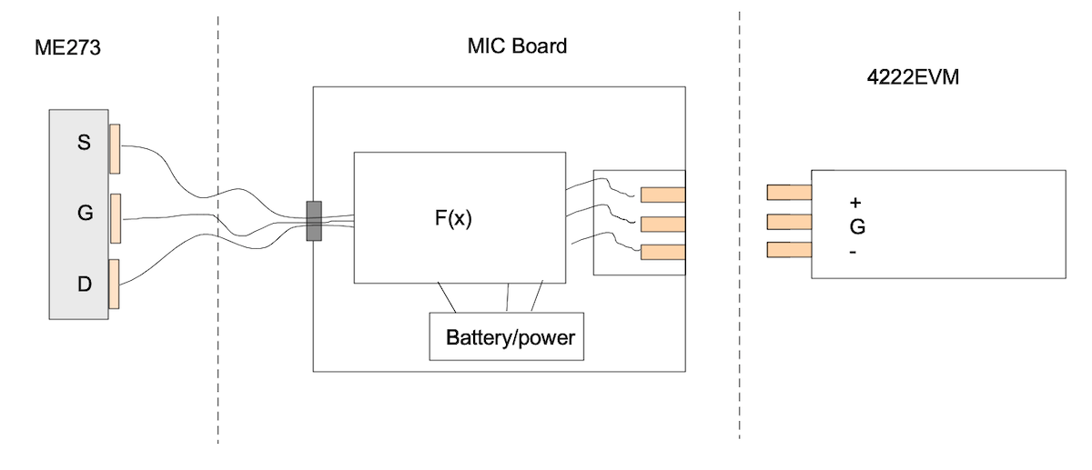

The differential EVM board input may be used single ended by grounding the - pin. There goes another 6 dB - thinking a direct connection of the capsule... But there is an impedance situation requiring a buffer!? Primo seem to indicate 5,6k as load and 5V bias in some basic configuration.
So what could be a very first trial?
Alt 0) Mod the EVM to a higher input impedance, hook it up to the EVM with -pin to earth and feed 5V to the capsule. This would I assume give some sound
Alt 1) Build a mic input stage ala' Wurcher with differential out to drive the stock EVM interface. But which one - there is quite a number of variants in the articles - all involving P48? Scott - any recommendations for this particular situation? No requirement for the standard phantom feed. I can make any local power source and feed it discreetly with own wires. What is this bootstrapping?
What I dont get is if "Capsule" in part 2 / Figure 4: Input Stage – Phase Splitter is equal to a EM273 or is it a really bare capsule without built in FET that is shown?
This "Vocm" seem to be a way to have DC offset in control and leave DC blocking caps out - nice! Is that a TI special? Something for the output stage of the mic stage to
Ideally I would want a stage (F(x)) that can on the input side make an ideal situation for an EM273 and on the output side interface the EVMs differential 570 ohm input - without a trace of "P48" (Basic version without gain but optionally 10-20 dB perhaps...)
Cables between capsule and input stage to be fixed/soldered (no connectors!).
Help!? pretty please...
In the text it describes that it can be either. For the three wire capsule you only need R1 and R2, the values picked to get the most dynamic range. You will need to have some kind of buffer because the two outputs have very different source impedances (if your A/D has very high input impedance you should be OK with a shortish cable only, no buffer).
Figure 10 is very easy to build if you want to try single ended, or add a dual op-amp diff out circuit. There are some rail to rail low noise op-amps around that are a good fit.
