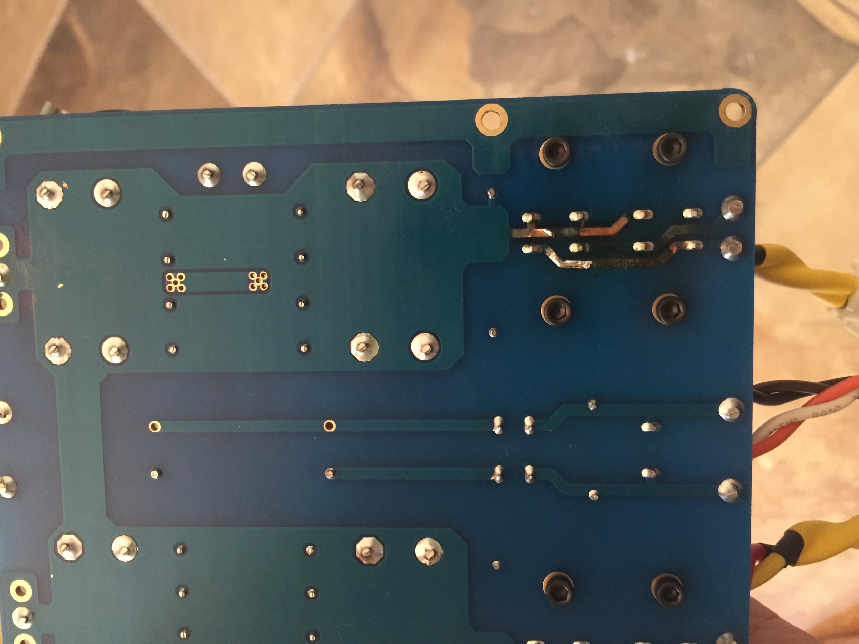

I would also consider increasing the voltage for the higher output power (if needed). Mine is singing without any problems last several years at secondary TR voltage of 2 x 22V. The included picture is old, now it is run as dual monoblocks in identical case and with second PS.

What is Vds across and current through input jfets on your build?

I hope ZenMode would remember or know. It has been really long time we did it. I would be glad to make a reading and let you know, but I am flying tomorrow morning on a short trip and will be back on June 14th. If Zen cannot figure it out until then, I will measure and post answer here upon my return.
If I could point on something, my problem was that I did not install in the first place the right sized LEDs, and after we corrected for it, all was fine. So read carefully about LEDs and purchase exactly the one specified.

I think that rickmcinnis plan is to build separate psu but still utilizing same chassis. Increasing psu voltage will be toooo hot for factory chassis, unless current draw is reduced, which is not an easy task on original J2.

however - important difference - what AR2 is having (as somewhat more potent iteration) is Babelfish J2 , which is having cascoded front end LTP , meaning that input JFets are having voltage (thus dissipation ,too) umbrella ; factory J2 is not having that , so upping rails voltage would be as howling a Devil , especially taking in account that in your J2 there also are JFets as small CCS for input LTP, connected across entire rail

You are correct, my four diode bridge failed as a short! Time to regroup!
