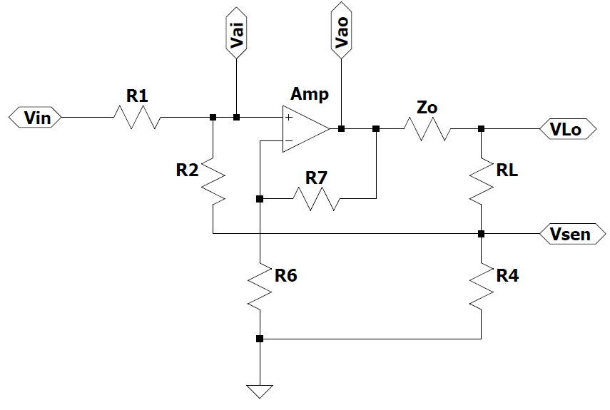

Mathematical Analysis of the F7 Topology
The following has been approved for publication by Nelson.
Very generous of him.
Although Lynn has published extensively on the theory behind the “feedforward” act in various topologies in post #442, etc.,
I thought it might be interesting to see how those equations are derived from first principle. I hope that Nelson would not mind.
Disclaimer :
1. I shall only use the schematics posted by Nelson in post #1425.
2. All values presented here are pure speculation on my part and have nothing to do with reality.
3. The motivation is, hopefully, to help people to understand how the topology functions, and not to carbon copy.
4. I have no intension to build myself, so it is a pure theoretical study with no experimental verification.
The reason for the need to feed forward is that the output impedance is way too high otherwise, as mentioned by Nelson in the F7 Manual.
Since there is no free lunch, the penalty is higher distortion, as also mentioned by Nelson.
So before we can analyse the circuit, we need to have a good idea of the output impedance of the basis amplifier (as in the Profet).
One can easily set up a Spice model of the Profet circuit and determine the output voltage with different loads.
We did that with loads between 1R and 16R, and determined the Zo to be 1.6R.
This agrees well with Nelson’s figure of damping factor of 5 (when referenced to 8R load).
It was also mentioned that the output voltage does not change in the F7 even when the output has no load.
This is actually very useful in determining some resistor values.
Referring to the theoretical schematics attached :
The Profet circuit is represented by an ideal operational amplifier (Amp) in series with an output impedance Zo.
The rest is pretty much according to post #1425.
To start with, assume an open circuit at the output, i.e. RL = ꝏ.
No current will flow throw R4 and Zo. Therefore Vsen = 0V.
And there is no voltage drop across Zo.
The output voltage VLo = Vin x R2 / (R1+R2) x (R7+R6) / R6
If we put R7 = 10 x R6 as in post #1425, but R1 = R2, then closed loop gain CLG = 5.5.
Quite close to 14.5dB in the F7 manual.
Assume now that the amplifier should have a near constant CLG, largely independent on the RL.
Also the range of RL should be between 1R and 16R.
The geometric mean is then 4R.
We shall use this as the design point.
Using the results from above, i.e. R1=R2 and R7 = 10.R6, Zo = 1.6, and RL = 4
the signal voltage at the Amp input
Vai = ½ x ( Vin + Vsen )
= [ Vin + Vao x R4 / (Zo + RL + R4) ] / 2
= [ Vin + 11 x Vai x R4 / (5.6 + R4) ] / 2
Rearranging,
Vin = Vai x (2 – 11 x R4 / (5.6 + R4))
= VLo / 4 x (5.6 + R4) / 11 x (2 – 11 x R4 / (5.6 + R4))
But we want to have the voltage across load
VLo = Vin x 5.5
Therefore, eliminating Vin in both equations,
2 x (5.6 + R4)/4 – 11/4 x R4 = 2
R4 = 0.36 ohm
The effective input impedance seen by the source, with a 4R load, can be calculated as follows :
For a certain input voltage Vin, ( VLo – Vsen ) = 5.5 x Vin.
Hence Vsen = 0.36 / 4 x 5.5 x Vin = 0.495 x Vin
Zin = (R1 + R2) / (1 – 0.495) = 3.7 x R1
Note that this value varies with RL. For 8R, e.g., Zin = 3.7 x R1.
If you wish the source to see a constant impedance, you should consider choosing a larger value for R1.
And then connect an additional resistor between Vin and Gnd to swamp the effect of R1, R2 and Vsen.
The exact values of R1, R2, R6, R7 will have a direct effect on the frequency response of the circuit.
But this is best determined in Spice simulations.
And of course, if you decide to change output devices (e.g. double die), or desired closed loop gain, etc. the actual numbers will change.
But the maths is the same.
QED. :)
Patrick

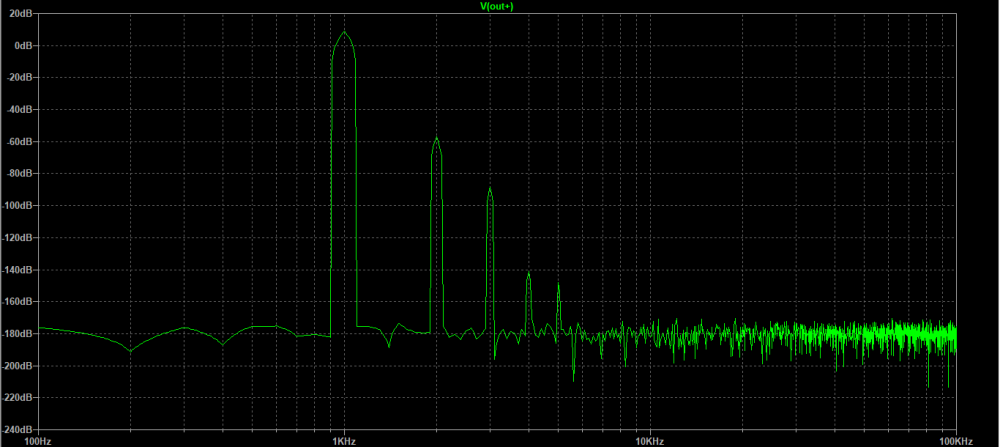

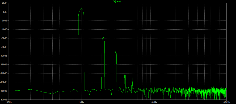

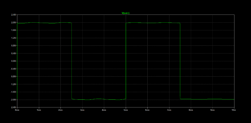

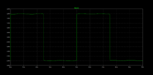

For a sanity check, we simulated a circuit based on the results from the previous analysis.
Input voltage is 1V, 1kHz.
Output voltage across load :
1R 5.37V
2R 5.39V
4R 5.40V
8R 5.41V
16R 5.41V
At 1W, 1kHz into 8R
H2 0.056%
H3 0.0013%
If R1=R2=3.9k (Zin~10k at 8R load), -3dB bandwidth ~ 1.3MHz
If R1=R2=39k, and input is connected to Gnd with a 11k resistor, -3dB BW ~ 130kHz
I guess that is not too far off.
