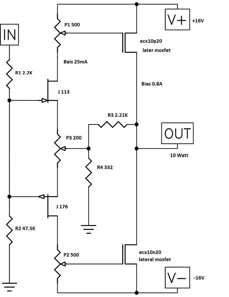

You are in the same ballpark as me but I took it further.
How so,higher bias and different pot settings? My advice is from a sim with good models (temp compensated). They are close to what was actually measured by a friend of mine with one of those pc based programs and probe.
Not as good as a distortion analyzer which I would like to have.Then you're really cooking with gas :)
Mine is quite a bit different in a number of ways but we are on same page here.
Mine is Sissy Turbo Version
Around 27V rails
double die lateral fets
1.7A Bias
Around 5 Ohms J, 15 Ohms K
Idss J around 7mA
Idss K around 9mA
Then tweak source resistance further on jfets using distortion analyzer to achieve around 0.05% distortion.
10 Watt amplifier
Hi All,
In one of the thread Mr. Nelson posted below schematics for 5- 10 Watt output but without any specific values. I had taken resistance values from Sony fet diy.
except positive feed back it is almost identical to schematic provided in F7 document. I am going with input JFETS J113 & J175 and output exicon lateral mos fets. Can any one suggest values R1,R2,R3,R4,P1,P2,P3,P4,V- & V+. Output required 10watt.
Thanks,
Nag.
