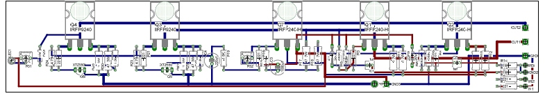

F1 PCB's

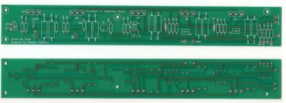

I have made PCB from schematic.
Both Power Supply and Amp Boards are ready.
There is difference in size & components size (resistors / Pot )
e-mail me, for further details, I will mail you pdf or PS Board and AMP board.
(Attached is image of AMP Board)

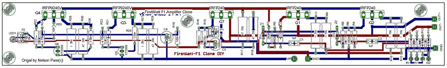

F1 Board prototype Tested..
Final Stage of F1 Amp
Now that I have a working F1 Amplifier.... Observed the following...
(I did not put Heat sink.)
MOSFET becomes Very very Hot.. (Q3 and Q4 Smokes with out heat sink)
Thick Heat sink with silicon paste and insulation is required.
Quality of sound is very good.. !
Instead of ztx550, BC557 is used.

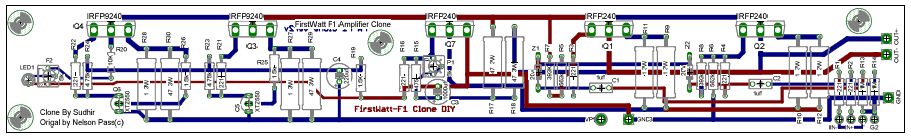

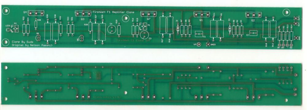

F1 PCB in Stock
I have got F1 PCB's in stock now..
I can mail you actual images, costing etc.
image file is 2.5MB
PCB are FR-4 2.4mm 1/1 OZ
$36 for Stereo Set PCB (Two Amp PCB L & R, and one Power PCB)
$20 onwards , shipping via EMS Speed post.
additional PCB's $13 each
(Add 2% on total value Paypal / Bank charges)

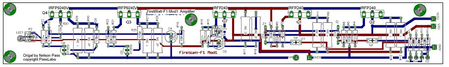

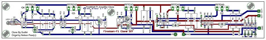

F1 Board, - Modified
After I learned about copyright issues,
I modified board layouts.
Added copyright and original Author names.
This board uses Vertical MOSFET, attached is file (pdf) containing layout image.
Authors, please comment on this.. !
(Hope I will be exempted from Moderation after this.)
thanks
suds
