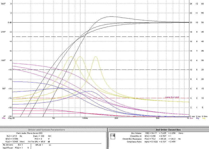

Sealed sim attached. Typically you target for a Q from 0.5 to 0.707 depending on how much room lift they will have. Theoretical value can be shrunk abit to counter the apparent increase of box volume from the damping.

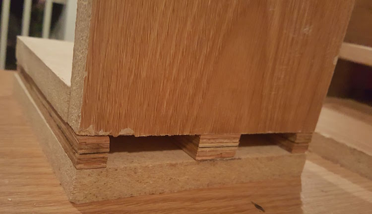

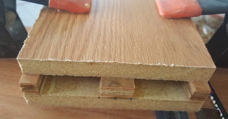

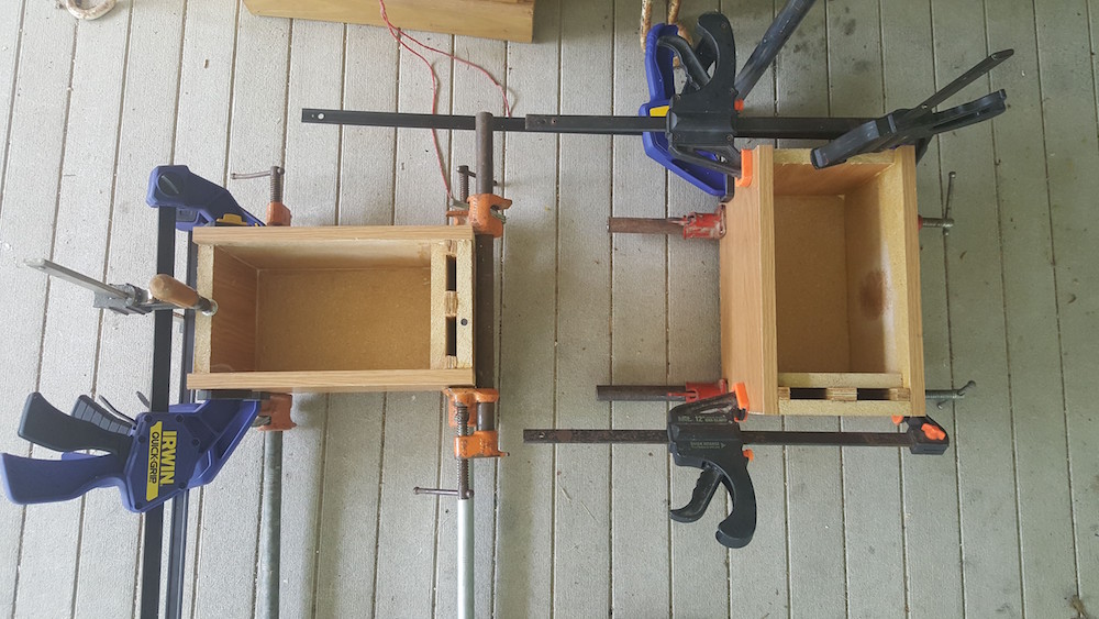

Test fitting the bottom panel, spacers, and the baffle sitting above them:

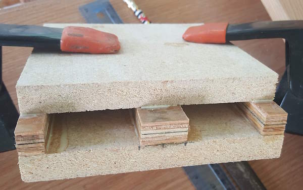

Gluing-up the spacers with a scrap board on top:
Gluing the "shelf" piece on top of the spacers. The baffle glues into the notch there between the front of the shelf and the top of the spacers. There's an impressive amount of gluing surface in this design

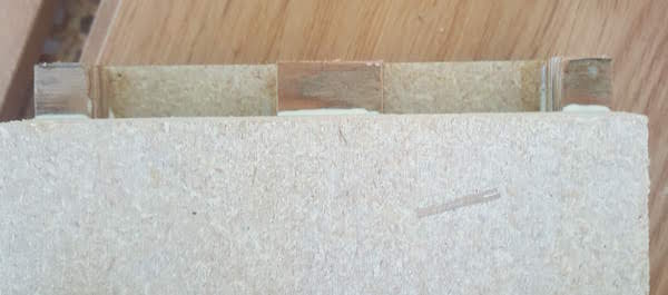

At the back, the matching opening butts against the back panel and forms the entrance to the ports:

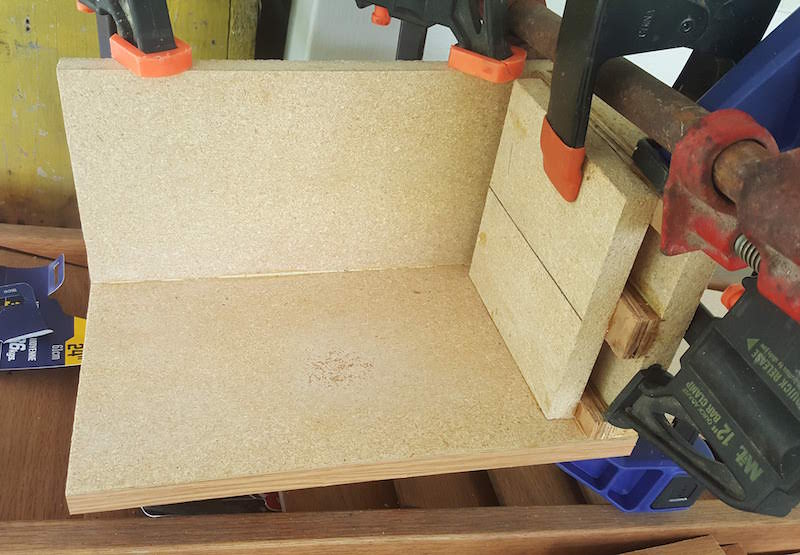

Here's my first attempt at gluing three panels into a "corner cube". It took me about five clamps and I'm still not sure how flush things are going to be when I take the clamps off. The marked centerline is for locating the lower brace.
And thanks everyone for the C-Note recommendations. I've been reading reviews and it looks like I would have been very happy with their sound. I'm even skeptical at this point that what I'm making will be their equal, but I guess I really wanted to make some sawdust.
Maybe I'll get to A/B these mongrel mPlu-Ken7's against a pair of them someday!
More gluing, now the top and other side.
Next things to glue are the lower braces but I need to figure out how I want to drill them out. Then it's time to work on the baffle. I'll jigsaw the hole and file to the line. After that, there isn't much left to do until the drivers arrive.
