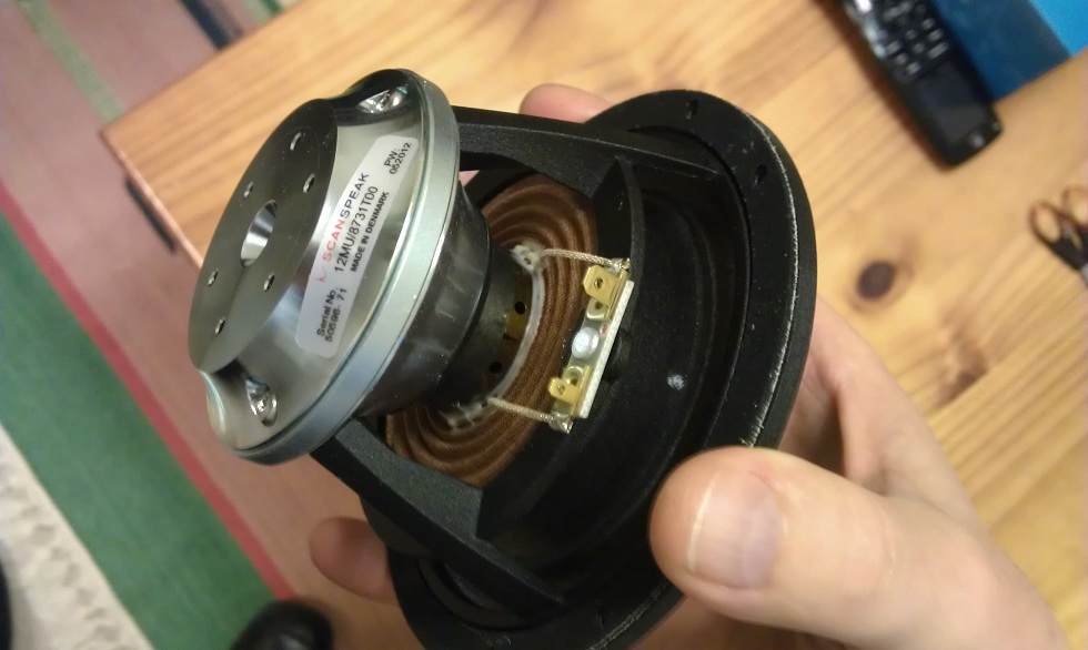

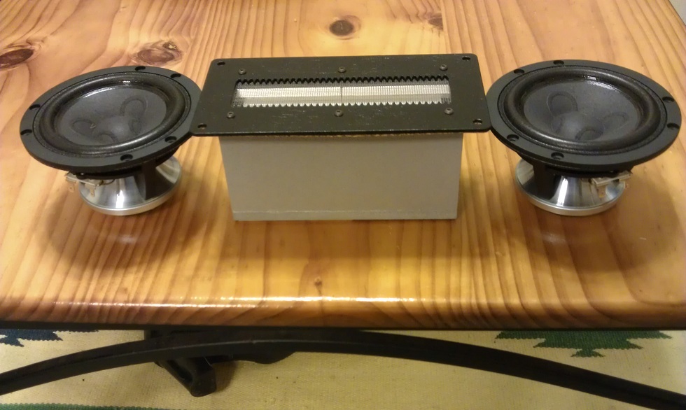

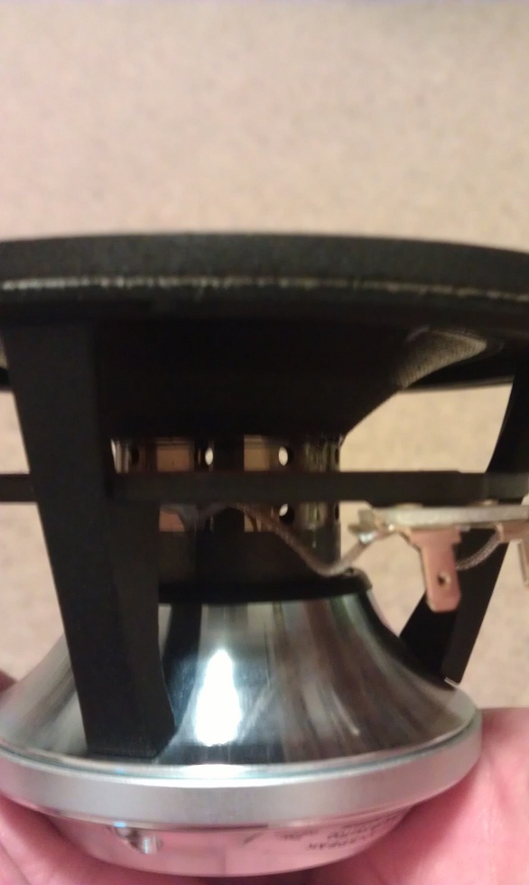

Just to provide some context to what I am proposing here are a couple of photo of the drivers.

Xmax is fine for midrange use, down to maybe 3-400 Hz.
Why not OB bass? In my opinion, its the bass range where OB's have their strongest advantages.
Finally fired up my speakers for the first time since buying all the gear months ago. Working out a basic crossover on the DCN28 was a bit easier than I expected.
So I put together a single speaker comprising of 1 x RAAL 140-15D AM, 2 x 12MU8731 in parallel, and 1 x Vifa 10" hard paper driver I had from a long abandoned project.
I don't have a baffle made yet as I was only getting them running to hear what the tweeter sounded like (very very nice :)) Being the tweeter really does like to crossover around that 1600-1800Hz range I wish I would have bought some larger diameter mids.
The Vifa 10" is 88.2dB from memory and needed some serious gain to match the mids and tweeter, but by the time I added 10dB of gain it kicked the crap out of the top end and sounded muffled.
So as a compromise I set it to 5dB and it sounds ok. It came as no surprise to me that the woofer would be less than optimal not mounted to a baffle, and I can already see why I would need some big woofers if I wanted to go OB on the sub frequencies.

No, the drivers don't move. Basically by suspending them the forces cancel. However, my 15" woofers are in a u-frame. I don't see any benefit to suspending the woofers "nude", you just throw away your lower extension and eff even more so than if they were baffled.
