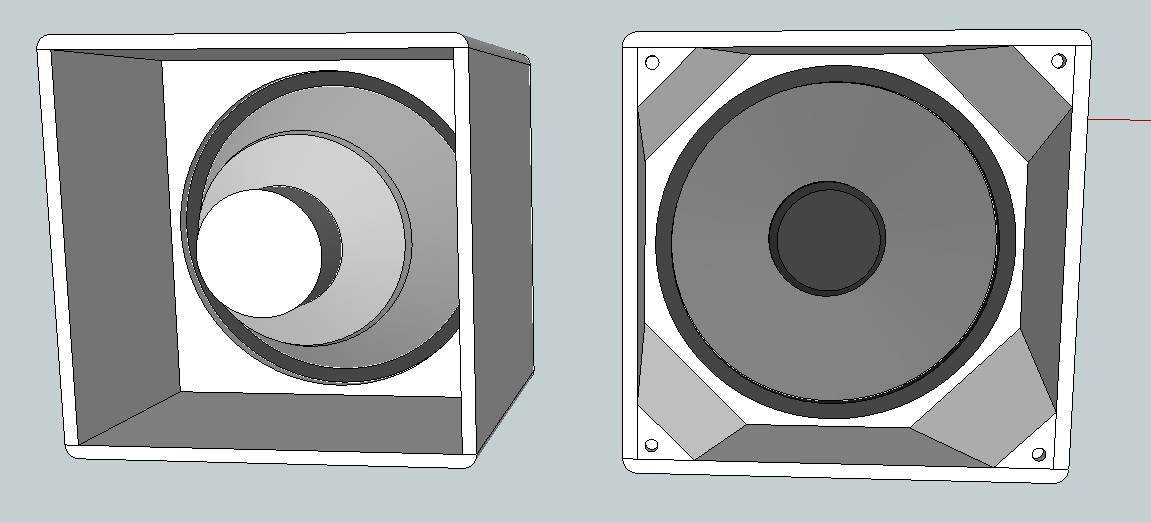

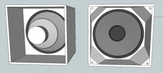

Did a bit of cabinet designing today for my next experiment. To protect the driver from accidental damage I have come up with a very simple horn version of the standard H box.
All that had been added are 4 corner braces that will strengthen and turn the front cavity into a octagon, whilst using the 4 existing sides to make up the eight sides, it also gives four convient locations to mount a speaker grill.

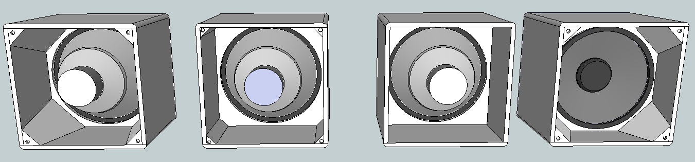

My only concern is the shape of the back of the cone is the reverse of the front, so the rear of the cone is angled towards the walls of the cabinet.
I don't know if this will actually cause any reflection issues if I start crowding the back of the cone. On the front the horn is the same shape as the cone, on the back it is opposite.

Fair enough... Because they would be additonal support pieces I could just build the standard box and simply add them later, which would give me chance to measure with and without them.
Because the box isn't going to be sealed and subject to as much vibrations, how thick does a H box need to be? walls? main driver panel?
