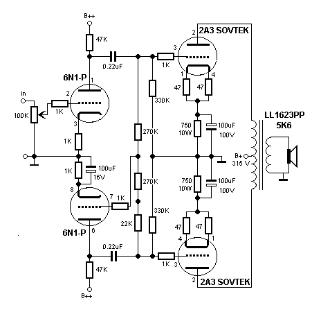

I guess it would be the simplicity of the SE circuit and the fact that I like the look of the 300B tube and after I finish building the amp I can always upgrade it simply by purchasing the WE300B tubes.
I have started picking up the parts I need but I am keeping my eye open for some vintage trafo's, and I am making a few changes to the circuit as suggested by Eli Duttman (thanks Eli).

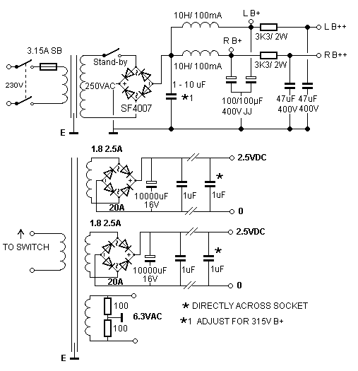

hi frank, your 2A3PP psu, i think the main bridge rectifier polarity is reversed or i'm reading it wrong?
You're absolutely correct....No idea how that happened but the polarity of the B+ bridge should be reversed.
It would also be wiser to use 160VDC bypass caps across the 2A3's cathodes iso the 100VDC. For best sound I'd recommend BGs here.
Cheers and happy building,
