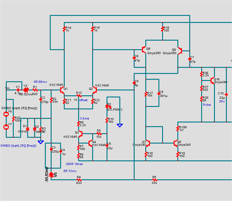

Next evolution:

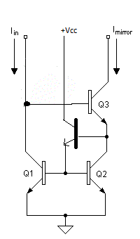

Changes involve output triple, dual VAS, improved current mirror in LTP, lowered current in LPT(around 1.4mA now), gain adjusted to get maximum output power at around 700-750mV input, high-gain transistors where needed and changed the output transistors to BD139/140.

Made another prototype headphone amp, this based on the latest schematic:
First impressions is that hooking the bias transistor up thermally to the output-stage is very important! The output-stage bias is running away when hot. Oh well, lesson learned for next project.

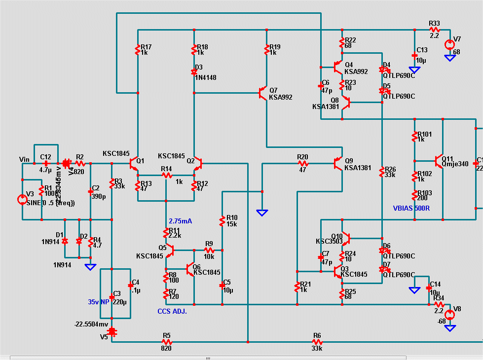

Where do we go from here? What is next, in terms of fidelity? My guess would be dual LTPs, but other than that I'm blank.
Kolbjørn
Nice looking amplifier! What THD does this latest iteration achieve? Could Q12 be a BD139 to facilitate easy mounting on the output heatsink? How about using this design as a low power speaker amplifier? Does performance suffer much when used into 8 ohm loads?
A blameless (your amp) will still sound the same on either an EF2 or a triple. Since you have a working triple , why not try some other topology ? (below 1) and ( 2) may seem simple , but they really sing on a triple. :)
1 is the luxman - absolutely the best on a triple (ultralow THD)
2 is great for subs and just about any other purpose. The voltage amp's current in both circuits is set by the input stages CCS , about a 1:2 ratio (input stage 3.2ma = VAS 6.5ma.
