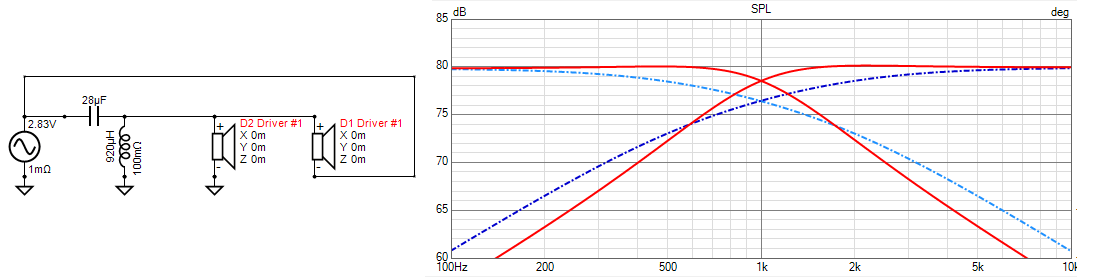

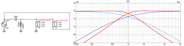

If you're trying to do this/understand it in your head or with basic equations, I'd suggest modeling it. Series crossovers are inherently a bit unruly due to the interactions that happen. How you adjust things can also swing the load more inductive or capacitive. Edit: I think wolf_teeth beat me to it by a minute :)
With a parallel crossover you have far more latitude to make things do what you want. With series you don't have as much control over independent responses. With a simple series crossover the model and result will likely be pretty close. The more shaping/adjusting you need to do, the more unpredictable things get and the more likely you'll need to adjust things on the fly with the model as more of a guideline - but an important one.

If I did the mathematics correctly, you can still get a normal first-order crossover response when the woofer and tweeter impedances are different:
Choose L = Rwoofer/(2π fcrossover)
Choose C = L/(Rwoofer Rtweeter)
Of course you have all the usual advantages and disadvantages of a first-order series filter.
Reactions: 1 user
