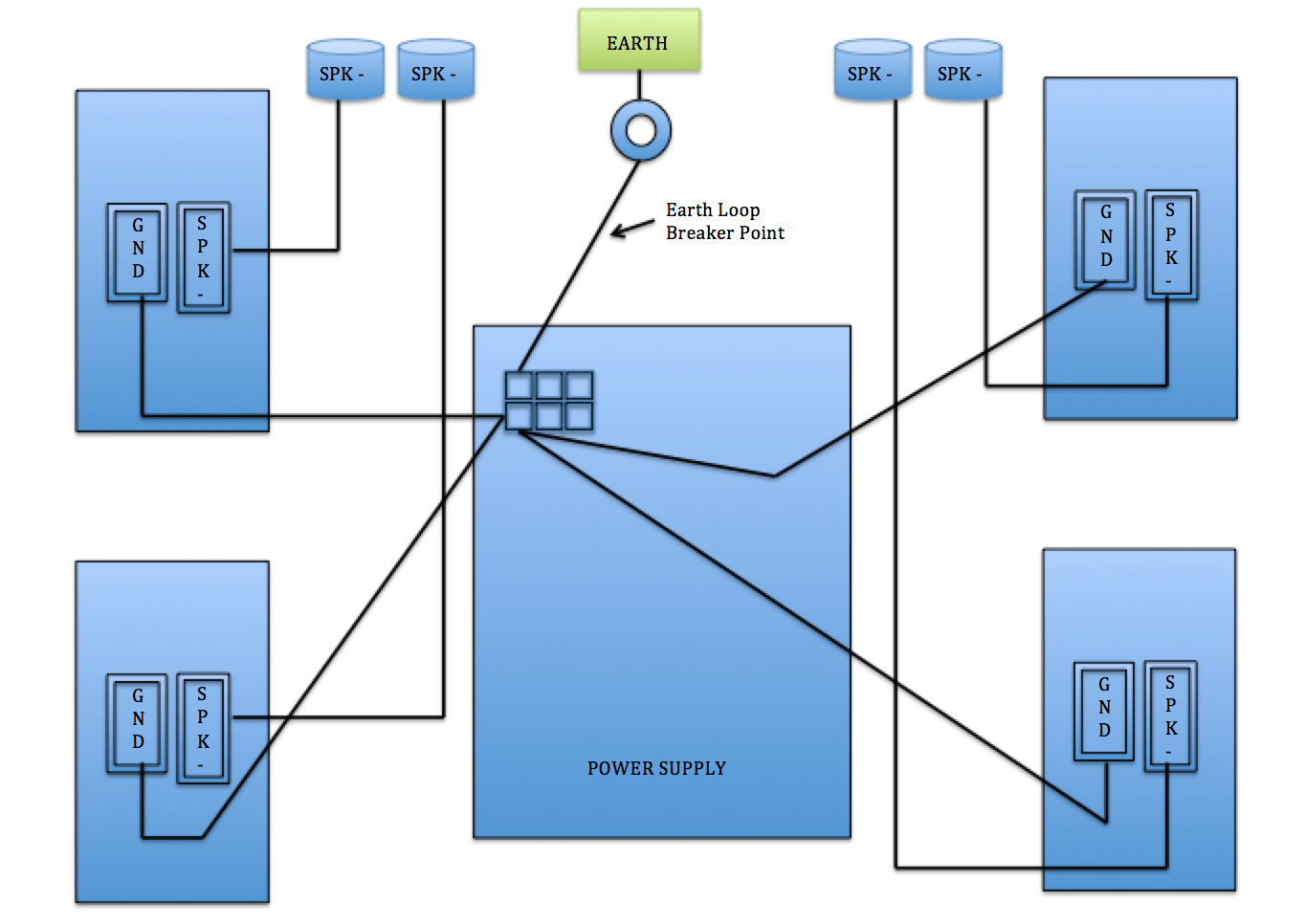

Grounding Scheme
Hi Guys,
As grounding has been discussed, I wonder if anyone has any opinions on my proposed grounding scheme. I am using 4 modules to 1 SMPS1200A400 power supply. This seems the simplest solution to me. I have made a power cable up that has four wires into each connector (positive negative and ground) so the power for each module comes from the same point.
I am trying to decide if I should connect the power supply ground to the chassis directly as shown, with a loop breaker or to not connect to chassis at all.
I have other amplifiers without a connection from audio ground to chassis ground and I don't suffer any problems from any RF interference.
What power rating should be used for the 1K resistor used in the back to back diode arrangement as LC suggests?
Hi fluid
Proposed GND sch is OK. Ground-earth loop breaker could be installed to marked position without any problem. Yours power distribution wires are correctly made from SMPS connector ie. star like.
Resistor plus antiparallel diodes drops 0,55 V in either current direction so 1 k can be standard 0,25 W. It serves only to define SMPS's absolute GND potential according to earth, so these are close in terms of volts, also 1 k resistor presents low Z in relation to complete isolation.
The only problem I see is in SMPS's starting current capability, the question is will SMPS turn on four modules simultaneously. It has to be tested and this info will also be very beneficial to the others.
L.C. :cheers:
