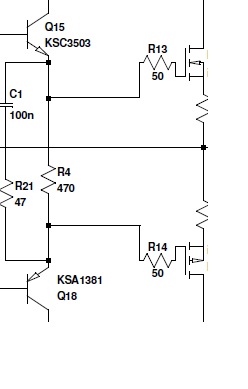

My guess would be an added driver stage between the VAS and the output.?...;)
I have already done that last year and used old medium Lateral MOSFET for the driver stage . The sound was good but I have damaged the amp and have not repaired it since then...
Your implementation is of course awesome . :up: Mine was done using modified boards with wiring....
Fab
Most likely like this.
uazUBAFffN71GaapwD65nH9OGVABNGw1qp7r0frhjvz1iTcy4TH2Gw24R3aB1K7UsqS6JFPn65rK6My4RdalMt0h5nuoQA1CxfrjypjpEr1S44xdT3W6j7MIVBFPdrqLywjEw1e0S9CIcxVS3O9CRcAxMddWN7oSjmOqqGj0Kx2CpDkeoVxn6FY5ubRhV6VIgaqJr4SjOwak6UDhEU1A4RFNQOERTUDhEU1A4RFNQOERTUDhEU1A4RFNQOERTUDhEU9J+0P8Hmd9BG+tWaFAAAAAASUVORK5CYII=
It helps keeping the drive circuit fast enough to lower the switchcurrents in the VAS stage. ;)
- Sonny

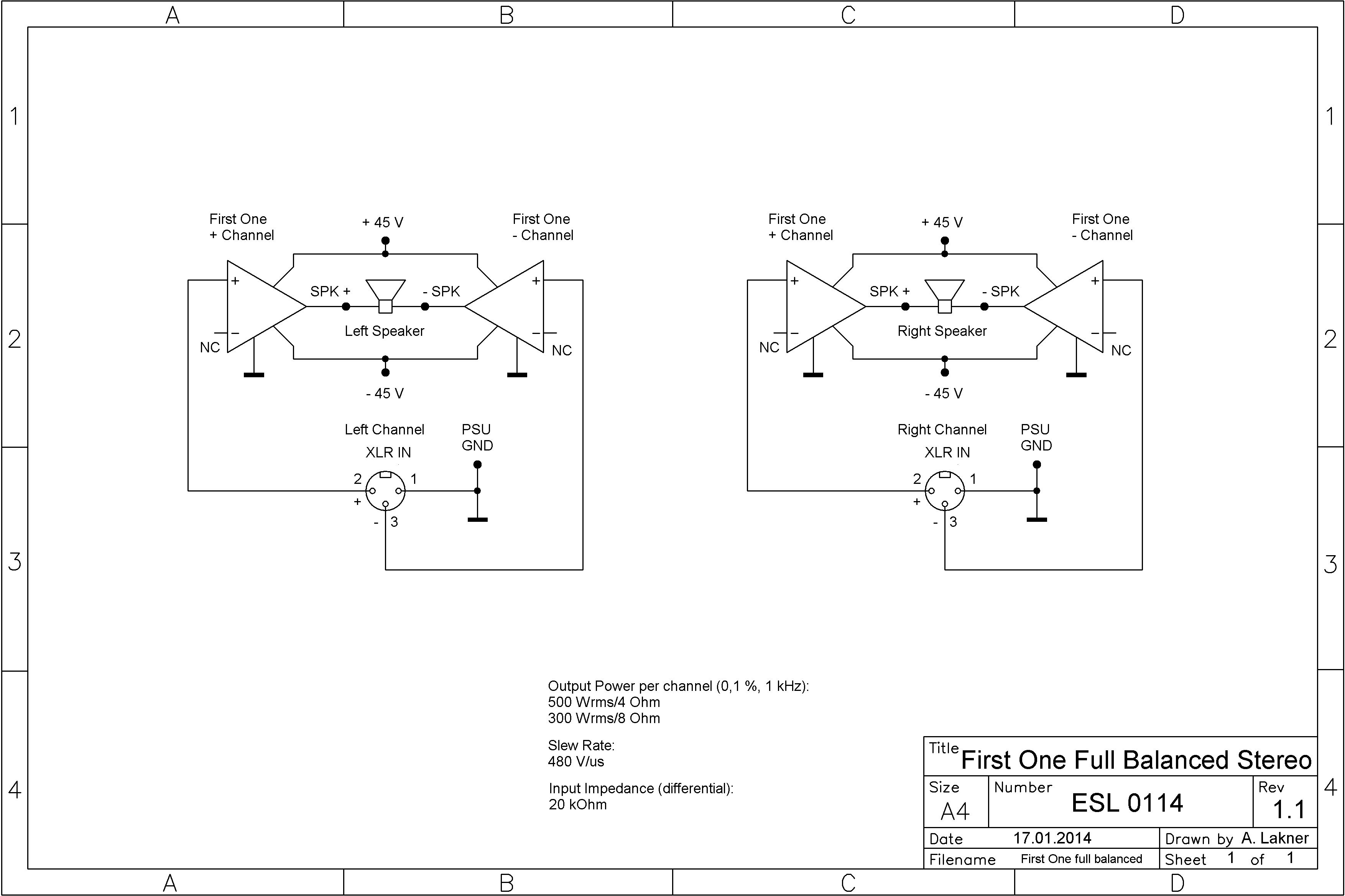

First One - Full Balanced Stereo
Hi LC,
Can you show (with a schematic) how we can connect 2 FO in full balanced configuration
and what about with output power at 4 ohms.
The 2 FO must be matched ?
Here are the First One amplifier modules in full balanced stereo configuration. :wiz:
First One has voltage gain in very tight tolerances, so doesn't need to be extra matched. :cool:
Watch the slew rate info. :faint:

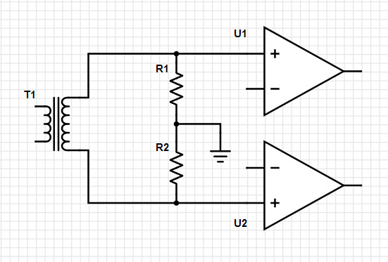

Hi Speedskater
OK, worse case scenario, galvanic isolation between preamp and First One full balanced amp with transformer coupling. Secondary of the transformer connected to two 10 kOhm input resistors located in each First One channel, referenced to GND, so symmetry of the secondary +/- voltages according to GND potential guarateed. Need more? :)
