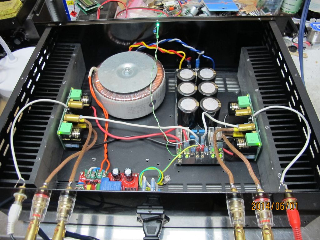

Based on the experience with VSSA (the same thing exactly minus the emitter follower drivers) passive volume is a definite no-no as far as sound quality goes. A 1k driving impedance also proved much inferior to 300ohms. I am also unhappy about this but the final result is very much worth some rethinking of the volume control/preamp.
Btw one of my FOs is also up and running - throughout the range improvement over the VSSA and especially in the bass region. Looking forward to try bridging soon.
Running in for now. I am thinking about SMPS dual supply. Hmmm.
Strangely, cannot get it running hum free with a shared between the channels linear supply... the strange part is that the VSSA had no probs.
No 3-rd wire ground connection, or chassis ground are used and the two channels are connected to the exact same points to the PS. Once the input grounds get tied together inside the preamp - hum. One of my preamps has a transformer coupled output which makes possible for separate left/right channel ground connections. Unsurprisingly, it is the only source which is entirely hum free with the FO.
My current setup is only meant to test if 4 modules are best utilised as a two channel balanced/bridged amp or a 4 channel bi-amp. Once this gets answered it will probably end up as a dual mono. Still, baffled and perplexed about the ground loop sensitivity.
