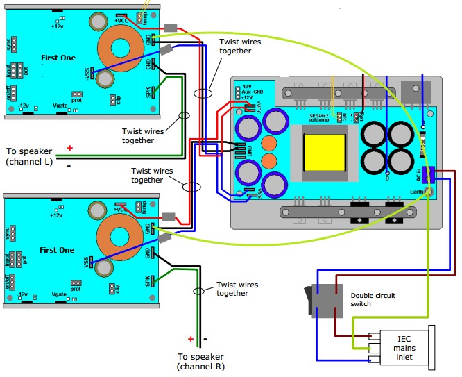

I'm figuring out how to mate your amps to my coldamp sps80 psu. I have attached a picture modified from the coldamp manual. I have added a connection from input gnd on amps to earth on smps. In the manual it states: "Note that output GND is electrically isolated from mains and Earth". Does this seem ok to you?

Edgar, look very carefuly and compare it to stereo connection sch from First One user manual and you will see they are 100% the same.
As we experimented with GND wiring for best results, my advice is to remove all three green wires and connect only main GND pin from SMPS to earth bolt. ;)

Agree, and please LC correct me if I am wrong, but I think it is better to have a star ground. To do it, it is better to link speaker GND together to PSU GND and PSU GND to amplifier GND.
Am I Right?
Am I Right?
No, not in this case, speaker GND has to be connected on the First One module, mandatory.
In previous post I have explained correlation between GND and earth potential. Star GND has nothing to do with earthing and is already done on First One PCB.
