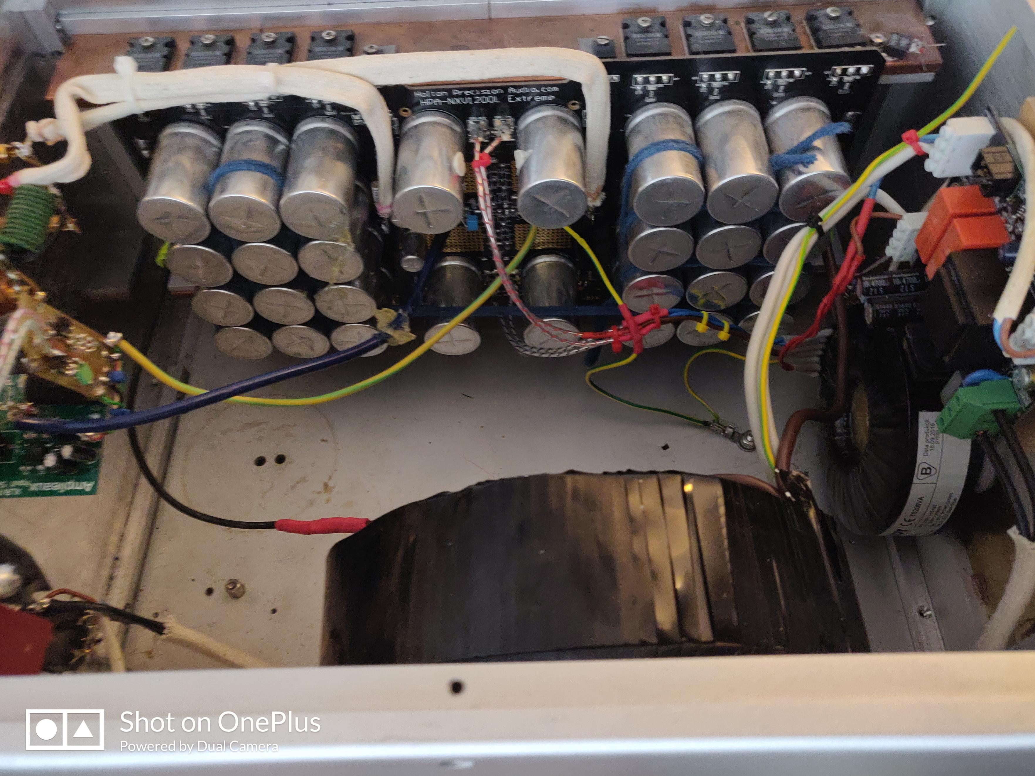

Hi I recommend the balanced receiver from Virtual Zero. It isolate incomming problems from destroying the too fast First one moduls. I bought mine because off problems with Holton Nxl 1200 moduls. They did not like capacitors at input and also not signal transformers at output on pre. This receiver fix thoose problems.

This is an unacceptable workaround. Perhaps these modules are just marginally stable and the similarity to the First One modules is not just superficial. Or there are flaws in the way they have been wired up/grounded. These don't seem to appear in the current line up, or at least i don't see them

They are very helpful. Connection between the Receivers power ground and the Amps power ground is nessacary. Otherwise there will be hum. The board need 2 x15 vdc.
Not saying they don't help, only that for an amp which is reasonably stable such help is not needed. And any such add-ons only reduce the transparency. Quite unacceptable.
Are you certain the Holton modules are properly grounded? What does the manufacturer say? I find it very unlikely that they sell a defective product.

I made I lot off Holtons. Only this NXL 1200 has problems. I sent them for mods to Australia ( moduls) but now I have modified them further after his advise. So maybe the receiver is not nessecary. But now I got them. So I keep them. Uses the That 1206 with only 4 transistors inside. I would never use an IC. 1200 is the only amp from him with SE in.

He do not sell them anymore and they where very costly. About 14000 DK.kr for two boards. 24 X 2700 uf on each board.
Probably any kind of input buffer would work equally well to keep the amp stable. Still, unacceptable behaviour, especially for an expensive amp.
