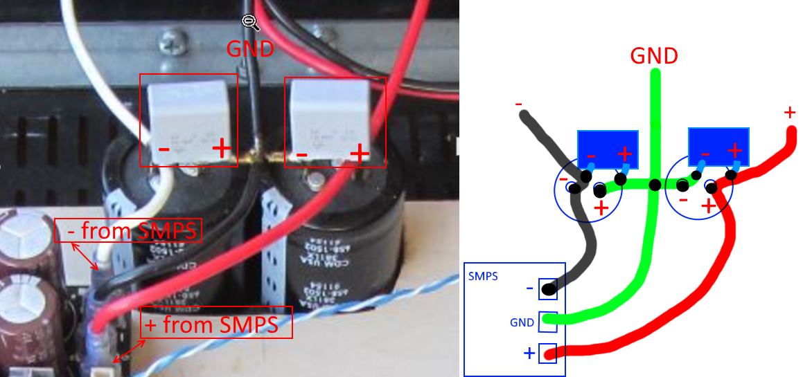

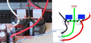

I would like to connect: SMPS --> with additional Cap (Mundorf MLytic AG 4700 uF 63VDC) together with “damping resisitor (WIMA 0,22 uF) ” --> with FirstOne.
My questions are:
1) How should I connect SMPS and extra caps with FO module? Please verify on my drawing attached below if my assumptions for connection SMPS <--> with CDE LX381 and additional capacitors <--> FirsOne are correct.
2) Do I need damping resistor (WIMA) in my configuration without bypass?
3) If my SMPS “faces 6800uf per rail without entering the protection mode”
What does it mean? Can I add one cap positive 4700uf and one cap negative 4700uf for each channel?
4) Should I use Mundorf MLytic AG 63VDC or Mundorf MLytic AG 100V (Like LazyCat did)?
I really appreciate any help you can provide
