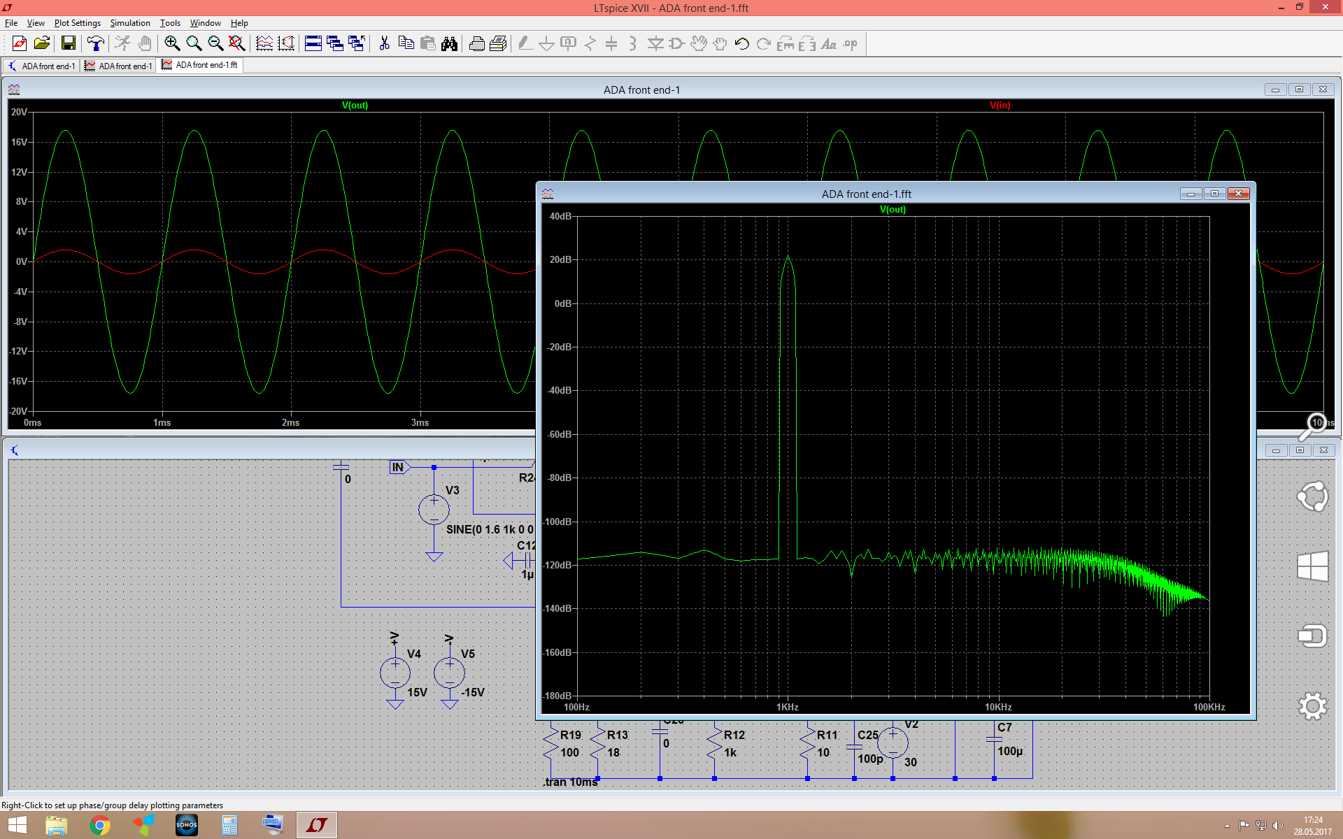

Managed to push harmonics even few dB deeper, thinking about the real circuit. :)
