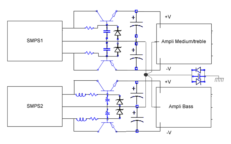

As somebody has offered-me two First one modules witch are right on my table, i will have the opportunity to make some experiments. My project is to use unregulated cheaper SMPS followed by a cap multiplier (with a zener in // with the cap ?). Both to reject ripple an switching frequency leakage. It will be dual, anyway, because active speakers. And to compare with my actual big linear.
I don't understand, with the price of the Hypex SMPS, the lack of technical datas in their sheet. No indication of ripple and noise, no voltage curves VS current ... Bruno ?
My project (See attached, apologize for the poor quality).
Ground is isolated from earth with two diodes, to protect the user against any dangerous electric shock. (0.7V max).
Treble size use film cap in the base to filter HF ripples, and a coil with lytic, on the bass side.
May-be I can use a single SMPS if i chose the same voltages for basses and treble, two if they need to be different. I wonder if a class D amp should be good enough for basses (up to 1KHz).
Comments welcomed.

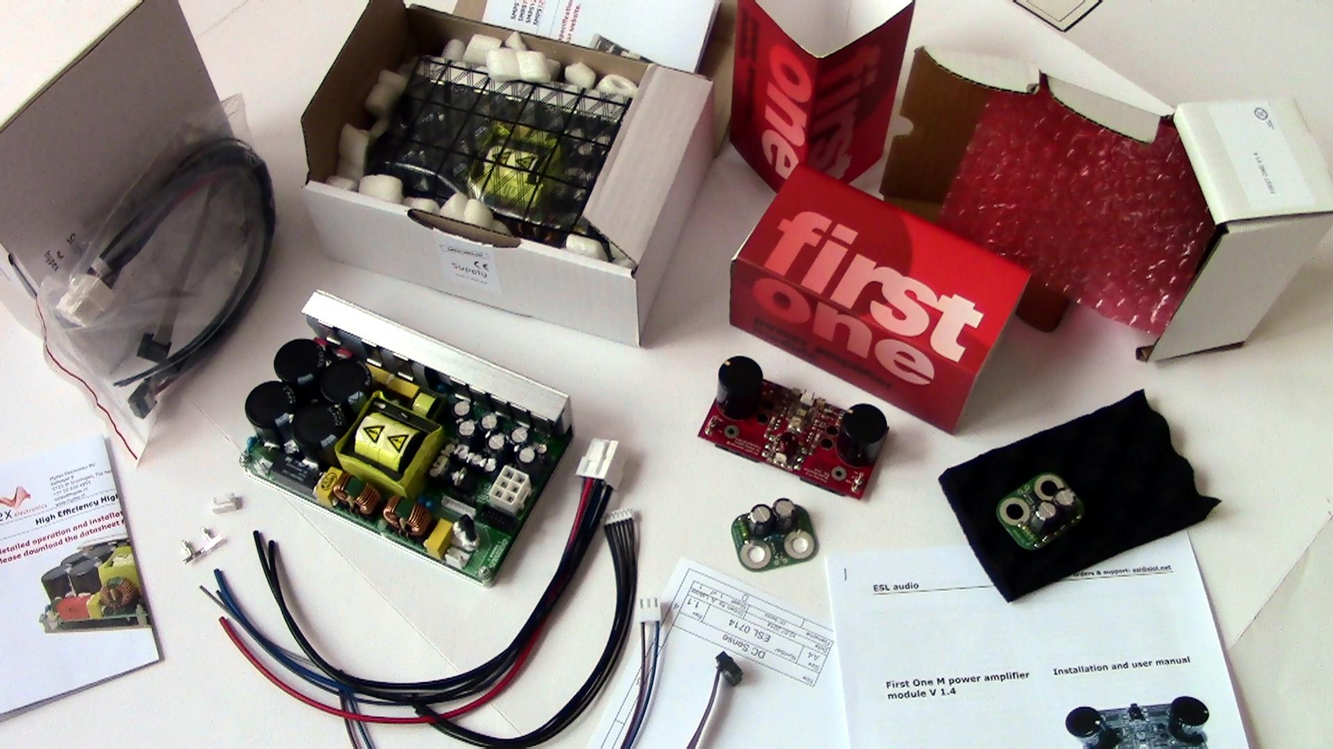

For using the hyepx power supplies with the FirstOne amp, do we need the Cable set from hypex?
ani101,
As Lazy mentioned, it will make things easier for You. I got the cable set myself, and You will be happy to know that it even comes with the jumper pin to switch the mains voltage to 120. :D
I Love Lazy's packaging.

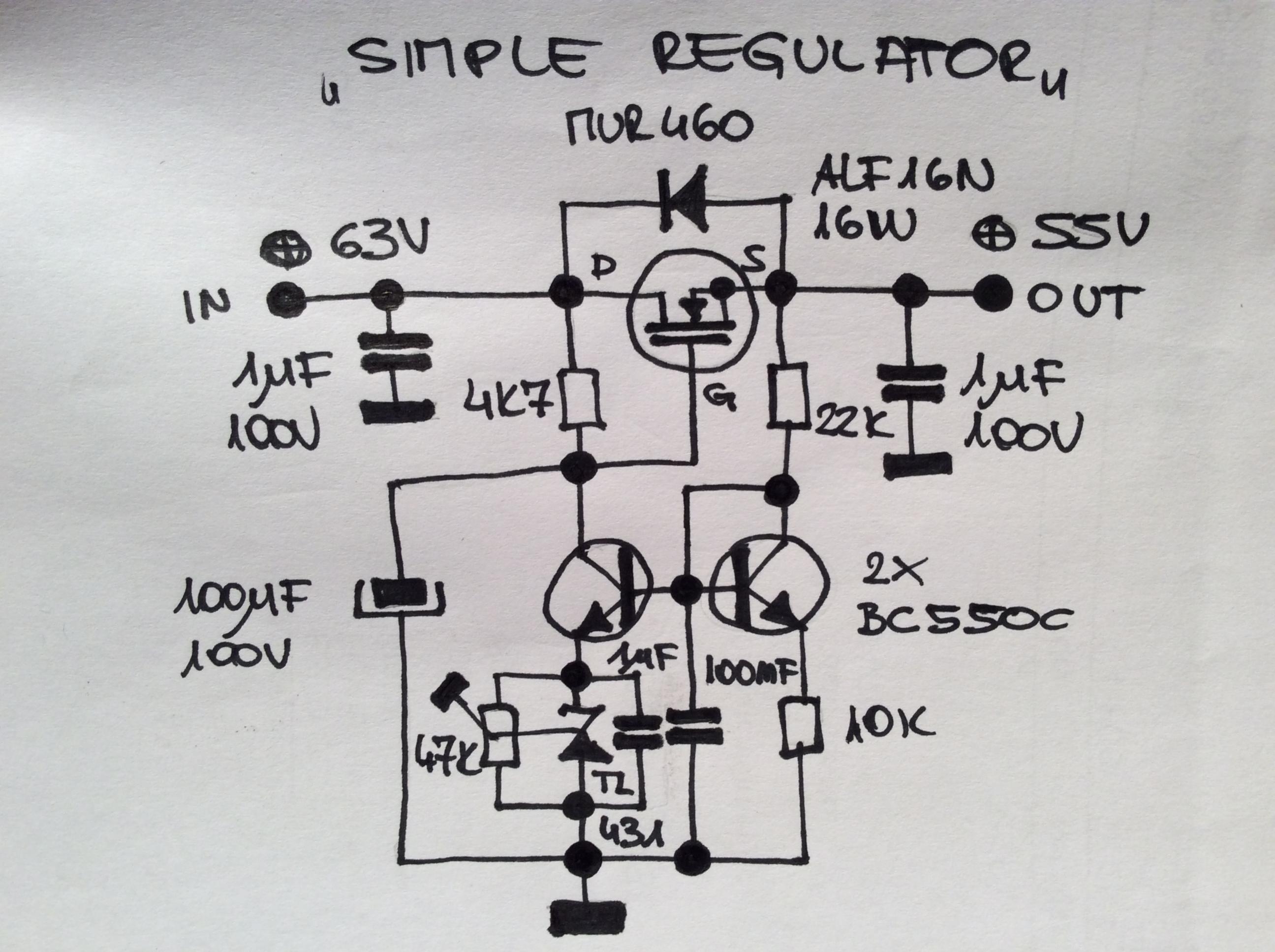

Simple positive regulator for you, negative is the same, only change transistors with complements, also change elco and TL431 polarity . ;)

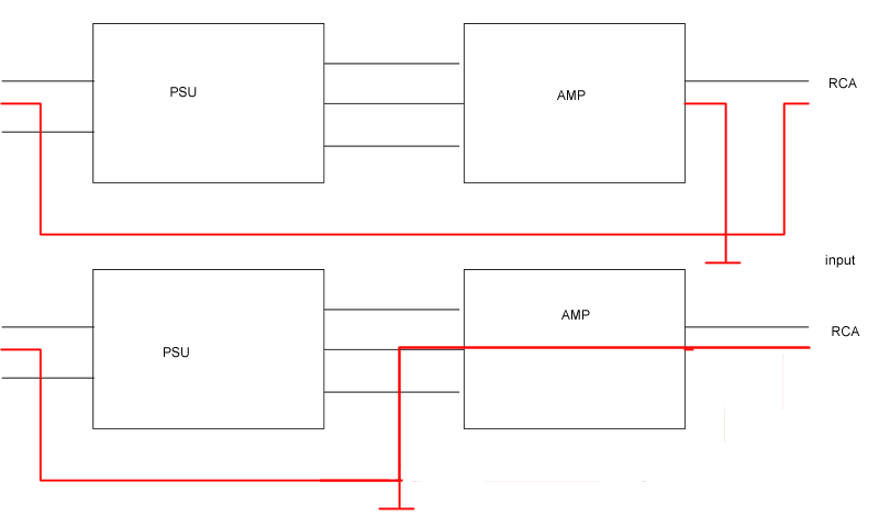

Common GND is and should be at source side only, not at power amp side.

More thoughts about ground loops.
Lazy Cat is right in this case. The FO is so nicely designed, thanks to SMD and printed board design that the ground paths are ultra short inside-it. No voltage differences to be feared here, whatever the currents.
As the main problem is ground loop from chassis and earths (leakages across trasfos) of various sources connected, it is likely the star ground in this amp will be better if situated right at the input .
But it is not a general law. And there are often situations where star ground have to be taken at the output of the PSU, or is better this way. No choice, by example, with a single PSU. In every case, The RCA ground have to be isolated from the amp's chassis.
A good tip to minimize the loop effects is to do this:
- Remove all the connections between your pieces of equipment and unplug them all from AC. And ensure all chassis are isolated from each others.
- Then connect the preamp to the ac, disconnecting the earth from AC and find the AC sens where the voltage between its chassis (or earth wire from the preamp) and earth of the AC) produce the less voltage.
- Once done, connect the audio link to the power amp, and find the AC sens of the power amp plug that produce the less voltage measuring in the same place (between preamp and AC earth).
- One by one, do the same for all audio chassis you use.
You can change the AC sens in an outlet Strip (multiprise ?), but, you Know what you are doing, don't take any risk of electrocution, don't touch wires or chassis with your skin while you are doing-it.
Once all is done, if you are courageous enough and don't care about guaranties of your new gears, you can add this double reverse diode + caps right between the earth wire and the AC outlet inside each of your equipment parts to reduce further the parasitic signals.
Enjoy now a more transparent and optimized system.
Now, if you will use an amp for professional purpose, in dangerous situations like PA systems, star ground at the input is a requisite. (figure1)
Look at what will happens in figure 2 if the earth of the amp, or the source's one is connected accidently to the hot point of the AC (It happened severall time in my life).
The ground track inside the printed board will act as a fuse. Probably a bad event for the preamp too, but, at least, the amp will stay alive in figure 1.
