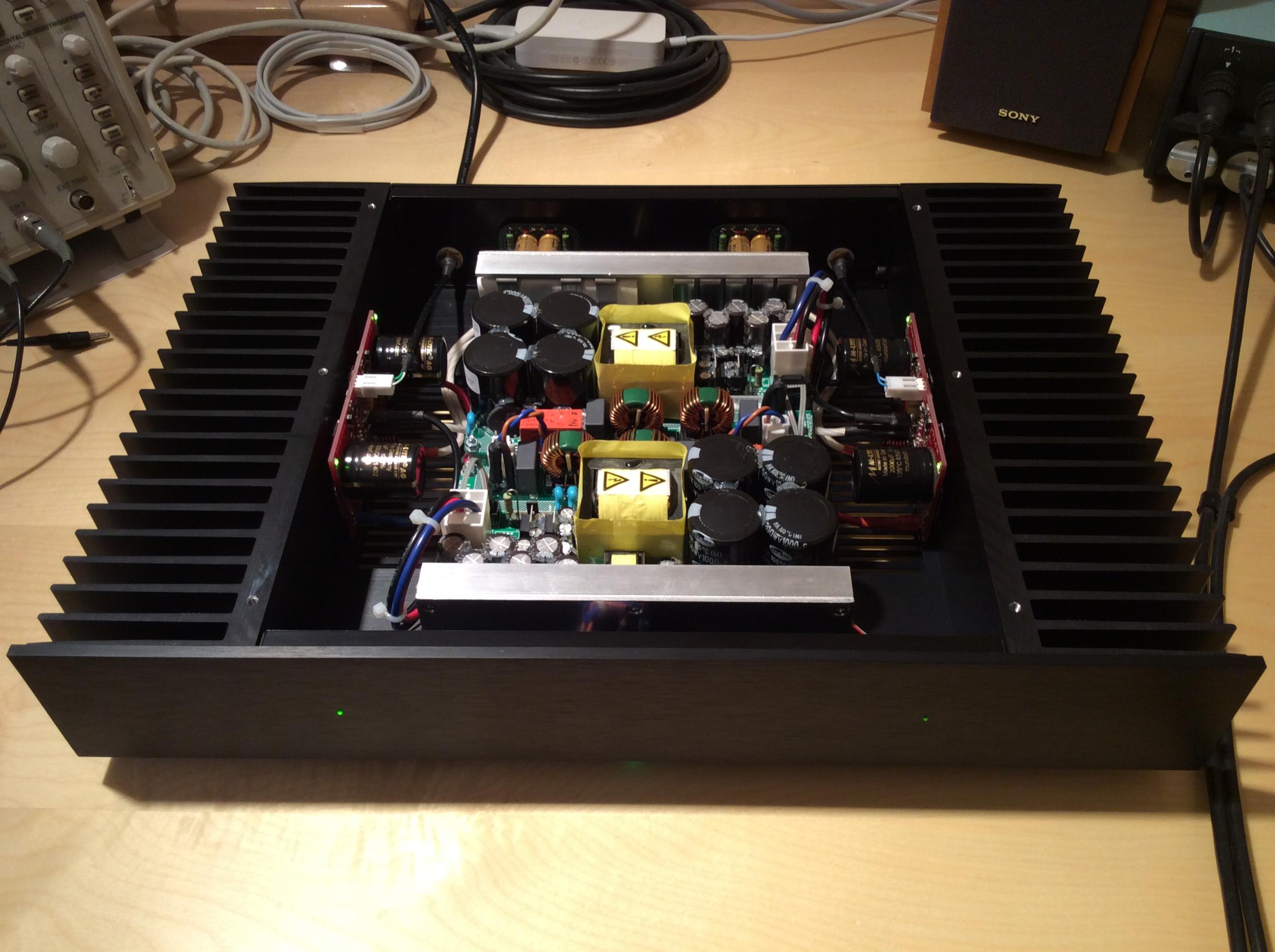

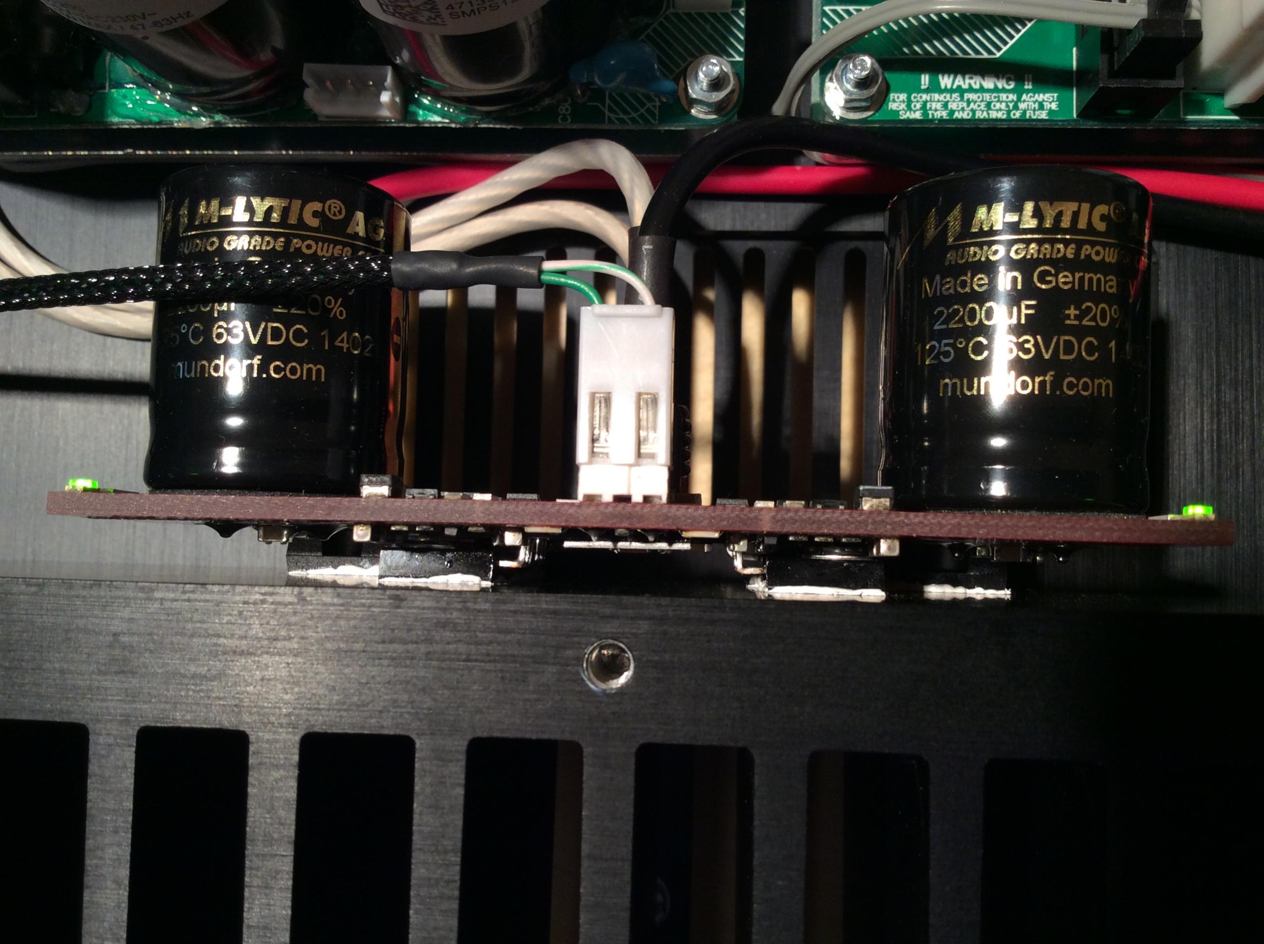

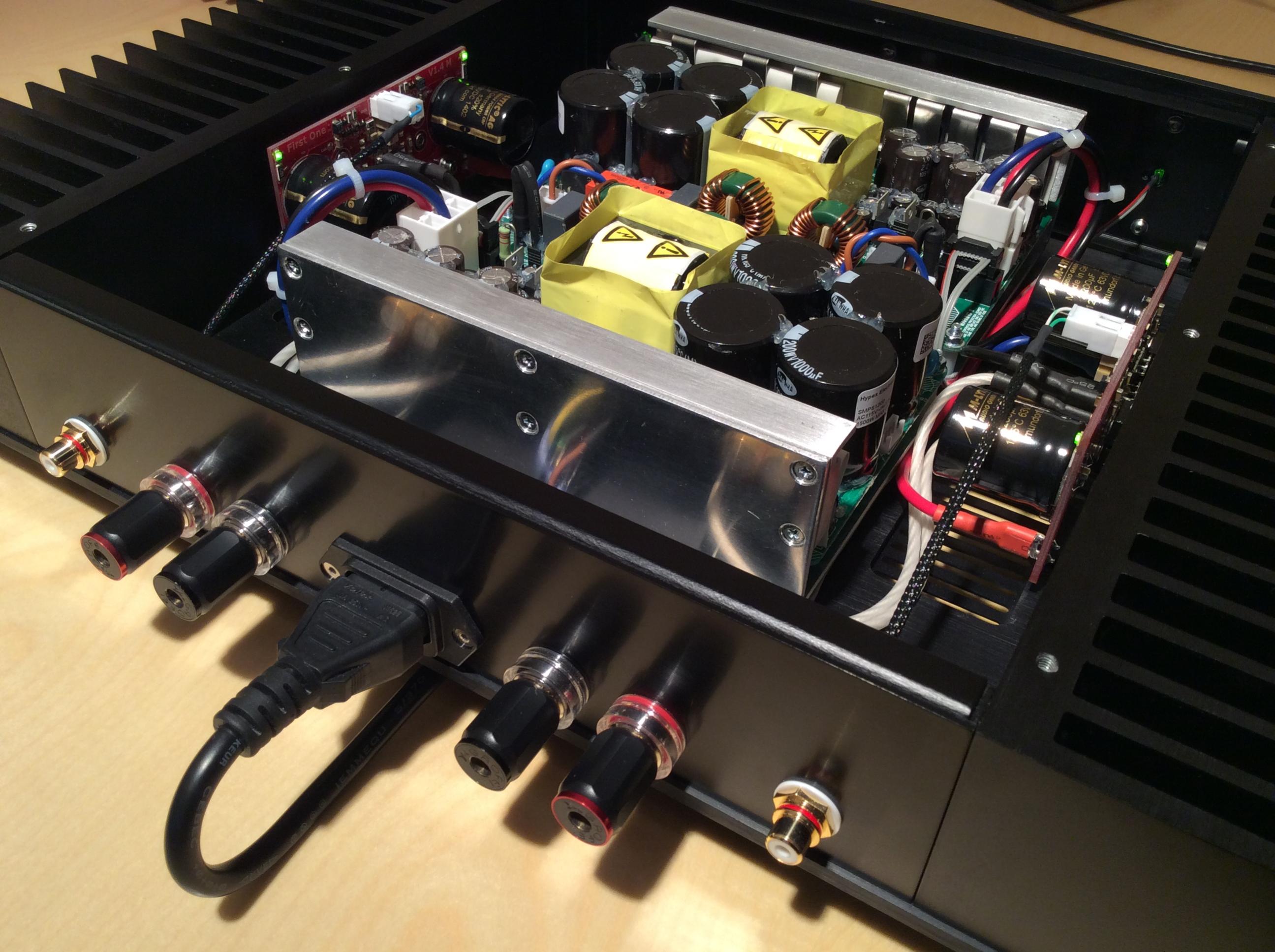

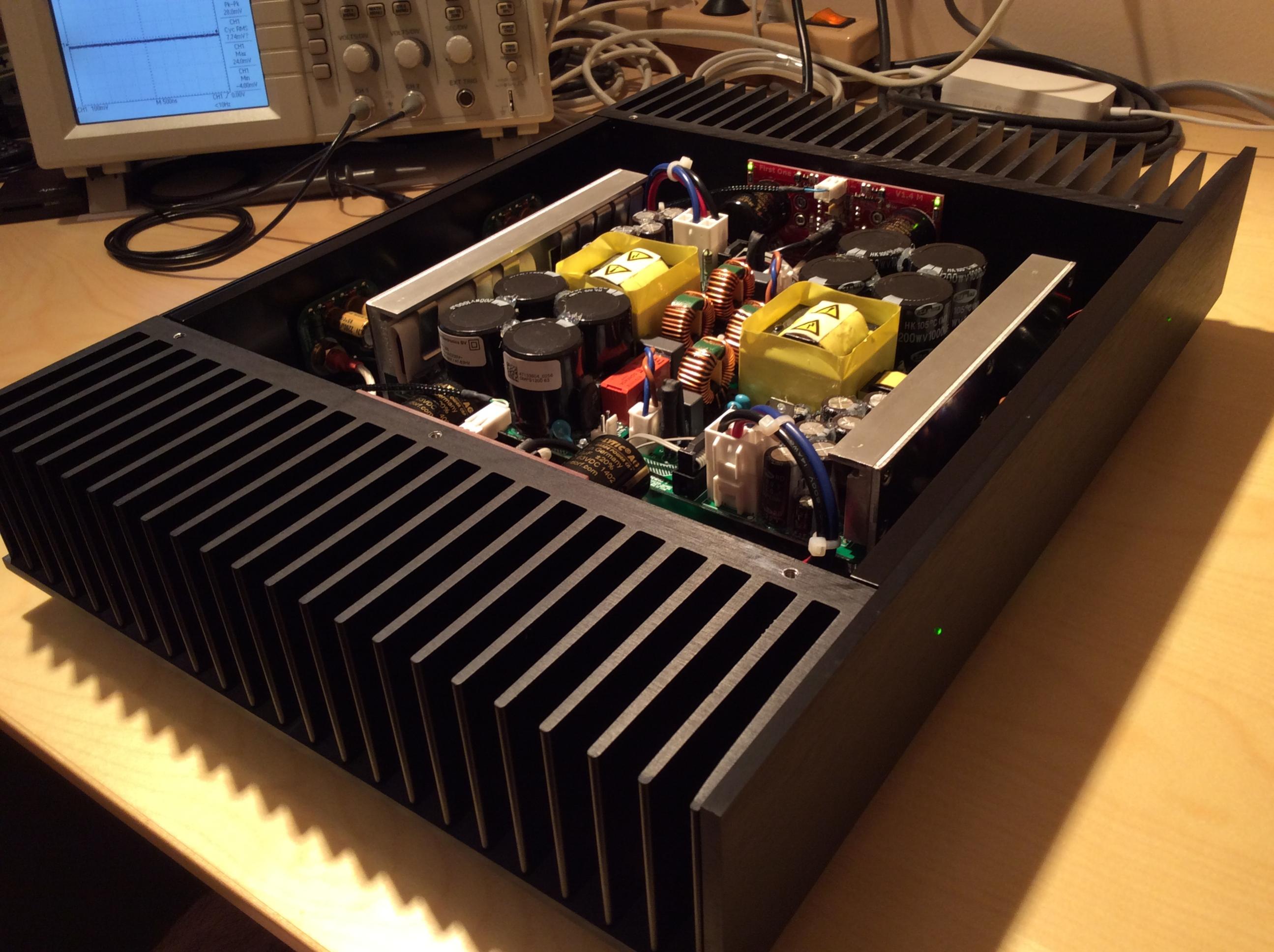

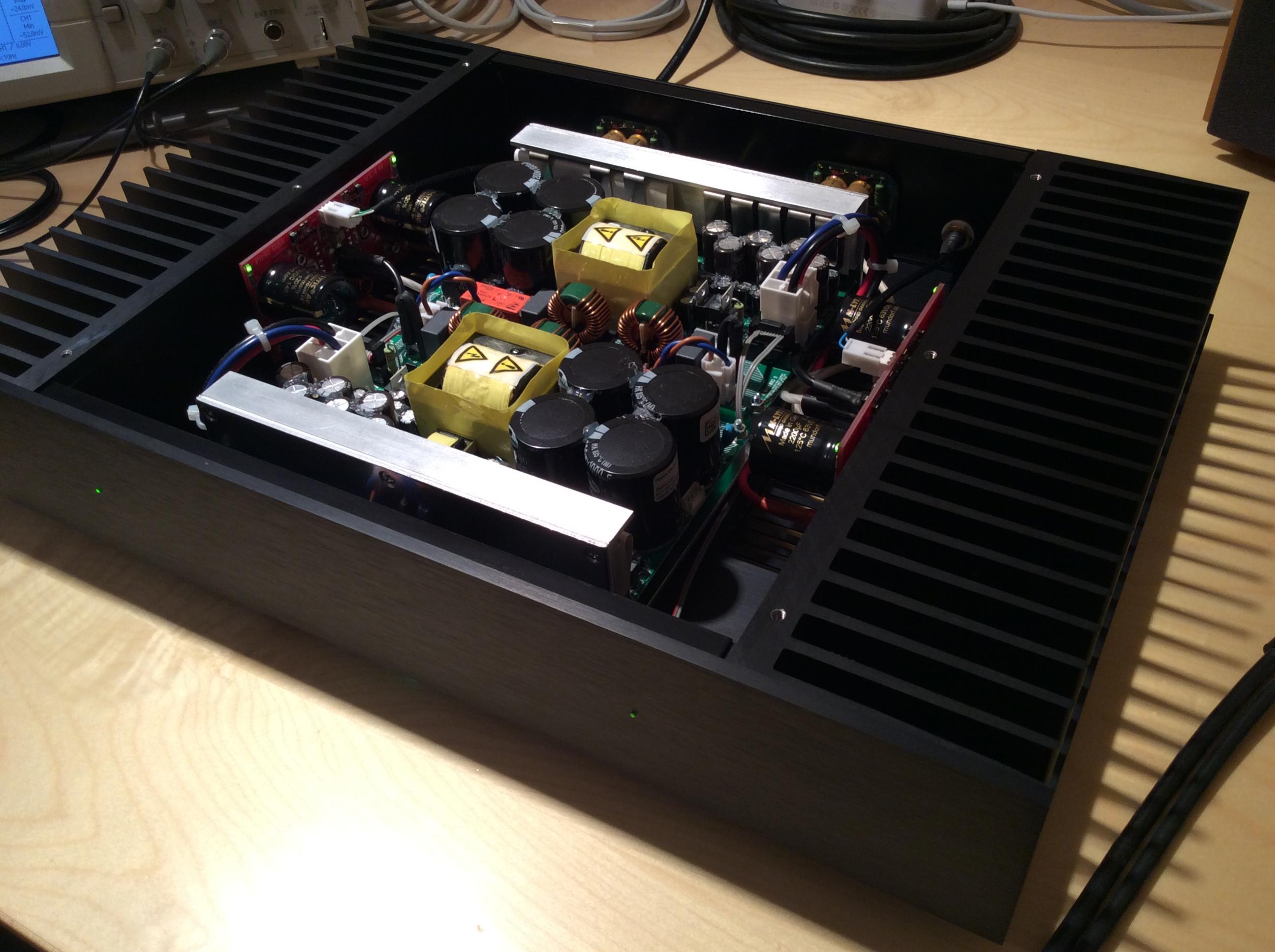

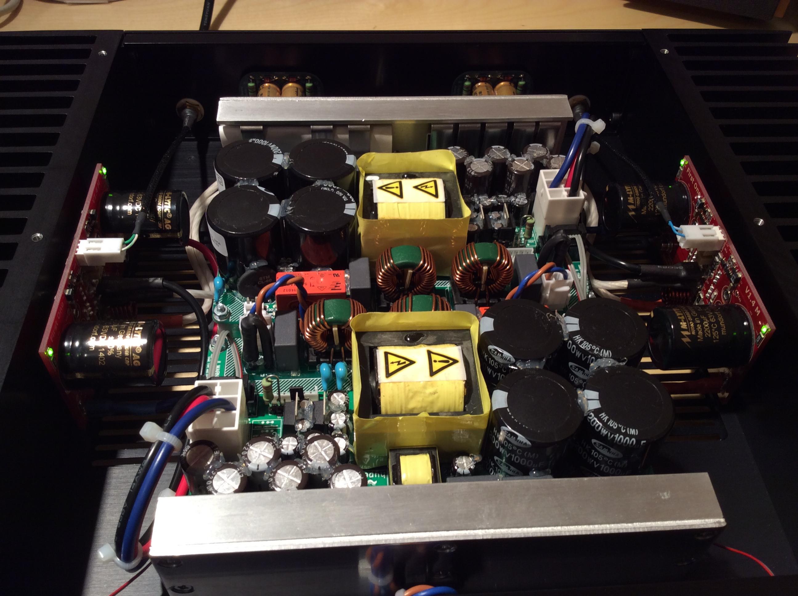

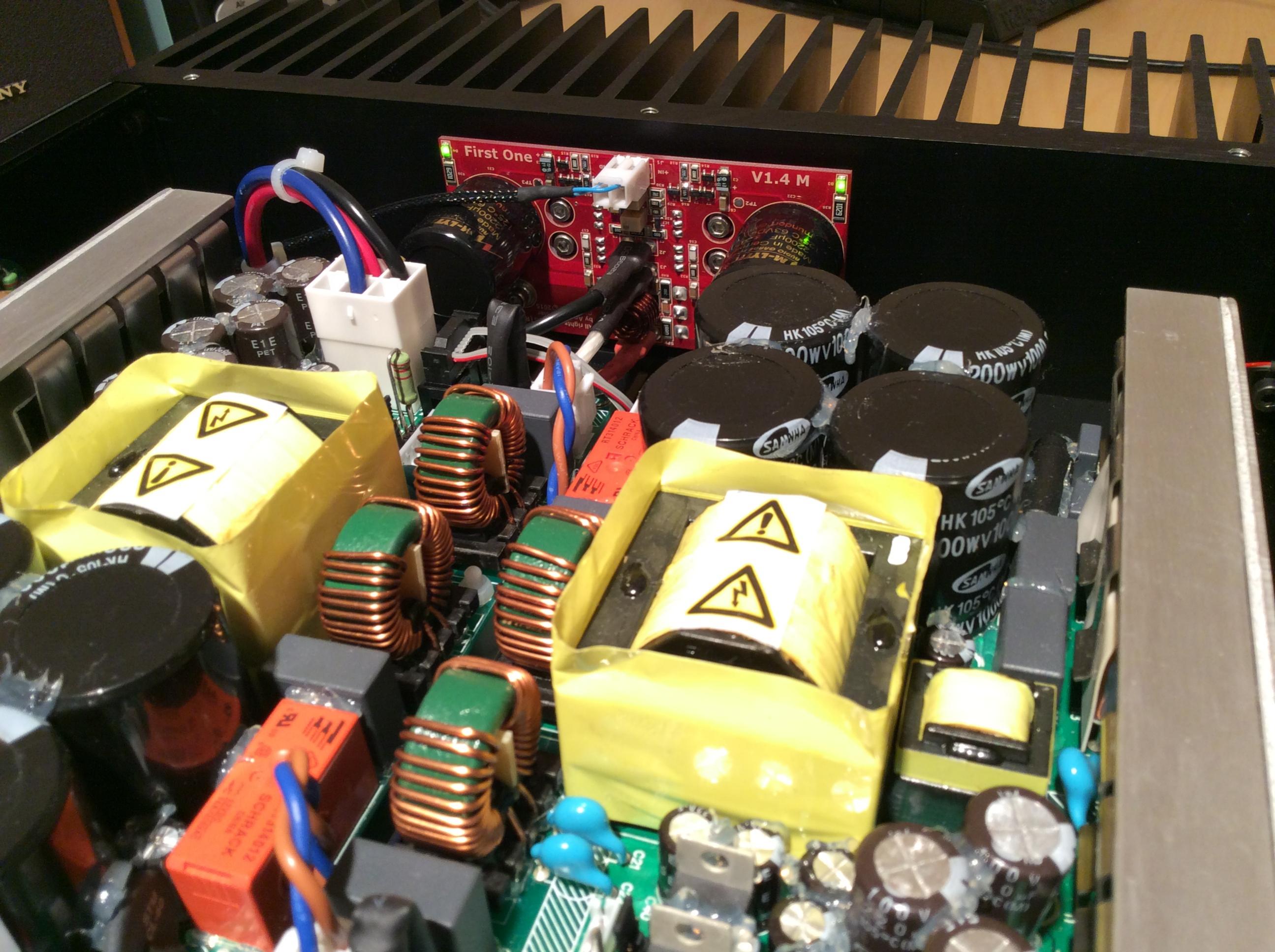

First One v1.4 M - Black Mamba
New First One M modules inside black C1 chassis. :)
Today's listenings prooved latest CFA topology is the way to go. :cloud9:

OK since an active crossover is in the other chassis, solution is to connect all GND points of input RCA connectors in amp chassis together and lead only one wire to central GND of amp's SMPS. Positive wires from input RCA to + IN pad of each channel. ;)
I have tried the solution above and unfortunately it did not make any difference, or if it did I am now more attuned to the noise so I can still hear it.
The noise is in all four channels but the sound is slightly different from the bigger drivers as they have a passive first order filter which makes it sound more like a hum whereas the tweeter sounds more buzzy as the higher harmonics are not filtered.
I have made a few other tests and even with only one rca cable connected the noise is still present in that channel. All other channels then have just a slight background hiss as you would expect from any AB amp.
I find this to be confusing as with only one rca cable connected the loop area is significantly smaller than before but it seems to make no difference.
Any other suggestions?
