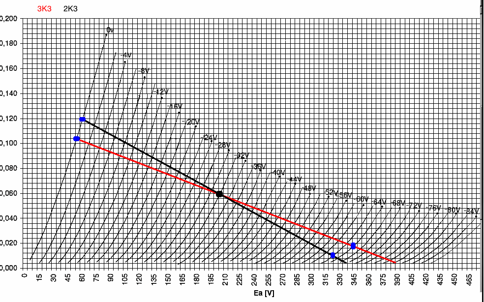

I draw 2 loadlines, 2K3 and 3K3 (not sure if my calculations are correct).

From the 2K3 load you will get almost 3.6W (at the primary). Second harmonic distortion seems to be less than 5%. All this assuming those curves are real....
You only need to subtract some power due to the transformer insertion loss. Let's say your OT in not particularly good and has got 0.6 dB insertion loss then you will still get more than 3W at the speakers.
With 3K3 you will get about 0.4W less and H2 doesn't seem to be different.
I would go for 2K5 max. You can buy the same Edcor transformer but 2K5 instead of 3K.

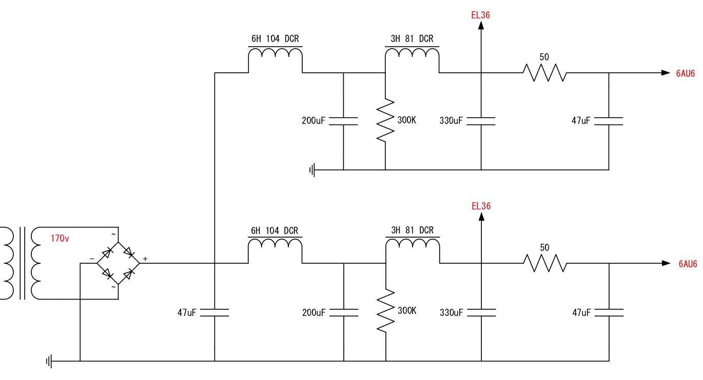

Here is a power supply proposal, drawn with what I have on hand, except the power transformer. Chokes are rated 100mA.
