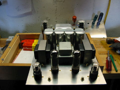

Well, I think I have everything mounted up, now to do some wiring. This is my version of a circuit that tubes4ever was kind enough to post. I liked his ideas very much and have changed very little. The changes that were made were due to the fact that I had some stuff in the scrap pile that I thought could be made to work ok. The only pieces I had to buy were the OPT's and choke, which I had wound at heyboer. I never realized how many hours went into scratch building, but it has been a heck of a lot of fun. Can't wait to get her done and see if it makes music or smoke. Jay:hot:

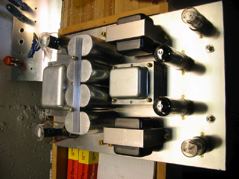

Yes, two 5R4's. Didn't really need two but liked the symetry, and it allowed more capacitence before the choke. The PT came out of an old Hammond PR40 tone cabinet which ran dual 5U4's. I've got a lot of iron for the expected 8 watts or so per channel, but I guess too much is better than not enough. Jay
Here's a little better shot of the PS.

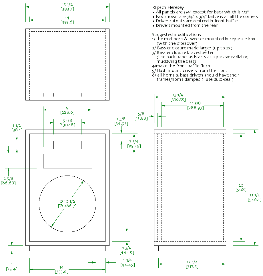

planet10 said:
I suspect you'll find that a brace (or 2) on the back passive radiator -- err back panel, will improve the bass on those.
dave
Interesting, I'm running them on a modified ST 70 now and can get good bass response, but only by adding a little on the pre. I have a pair of 15" EV SRO's that I plan on building some folded horn cabinets for. Thanks for the link, looks like some good info, Jay
frugal-phile™
Joined 2001
jaymanaa said:
[nteresting, I'm running them on a modified ST 70 now and can get good bass response, but only by adding a little on the pre.
The Heresys i had had an unbraced 1/2" back panel that was only held by screws. It flapped around like a freshly caught fish giving the bass a fat, undefined quality.
dave
