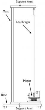

This thread totally needs more visualization:
From the website:
And from the patent:

"ABSTRACT
The design of a diaphragm for a rotary loudspeaker driver that eliminates phase cancellation and therefore eliminates the necessity of a box to acoustically isolate the front Sound from the back.
The key element of the design of the diaphragm is to use a cross section of at least three equal sides. This allows for the long sides of the diaphragm to create essentially positive pressure only as it rotates and creates a very rigid structure.
Further by sizing the cross section to the width of the highest frequency to be produced you allow for a nearly perfect 360 degree radiation at all frequencies.
In the planar magnetic design it is the edge of the diaphragm that is fixed to the frame. Therefore the diaphragm serves the double and contradictory function of being the rigid diaphragm and the Surround that is flexible.
The planar magnetic diaphragm moves more like a drum head than a piston. This nonlinear movement is minimized only by its large Surface. It is the very nature of the surrounds elasticity that invites nonlinear movement when the diaphragm is moving. The thin and flexible diaphragms of loudspeakers flex while operating.
When combined, the materials used for the surrounds and spiders and diaphragms these materials’ nonlinearities are compounded. The whole system is often operating outside of the narrow linear envelope of accurate reproduction.
These distortions are sometimes considered euphonic or non-irritating but are definitely distortions. The surround and the spider are flexible and are asked to perform the contradictory functions of providing spring and stiffness.
The flexing of traditional pistonic diaphragms is a result of designing for the thinnest and lightest materials to construct diaphragms.
Thicker and therefore more rigid diaphragms are inherently more linear but put too large a mass burden on the surrounds of rubber and foam of the conventional cone and dome pistonic drivers.
ADVANTAGES
My driver eliminates the need for the loudspeaker box to isolate the negative backwave from meeting the positive front wave in phase and canceling out the Sound wave. This also eliminates reflections of sound off of the loudspeaker box Surrounding the driver—a major consideration.
My driver design allows for a full-range range driver which is able to produce the lowest audible frequencies to the highest audible frequencies with a single driver.
My driver will radiate sound at all frequencies from the low to the high frequencies in a cylindrical wave of 360 degrees in the horizontal plane and in a vertical plane equivalent to the height of the driver.
My driver eliminates the necessity for an elastic material to center the diaphragm in its home position. My driver allows for the use of a magnetic repulsion system for holding the diaphragm and the Voice coil assembly in its home position while allowing the diaphragm to rotate in response to the electrical signal applied to the Voice coil.
US 7,860,265 B23
My driver eliminates the flexing of a traditional cone or dome driver due to my driver's diaphragm’s geometry. My driver uses bearings to fix the movement of the diaphragm and the Voice coil in a perfect plane of movement as seen in FIG. 1A.

This prototype was missing a critical components, the homing magnets (HM). The HM’s are critical for a smooth and extended response. See the frequency responce plot on my Web site.
From my Web site ...
“A large homing magnet is held in place by a bracket and is attached to the motor frame. A small homing magnet is placed on the side(s) of the diaphragm (or rotor) and whose pole faces the same pole of the large homing magnet. This Magnetic structure keeps the diaphragm & voice coil assemble centered in the magnets and provides dampening to the moving parts.”
