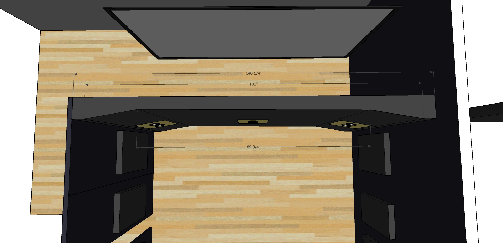

The screen will be 16x9 and measure 150" diagonally -- which makes it ~131" wide. In my model, the bottom of the screen (not the frame) is ~25" off the floor; however, I can raise it up another 5.5" if I need to (I won't know for sure until the wall is built and the couch is in place).

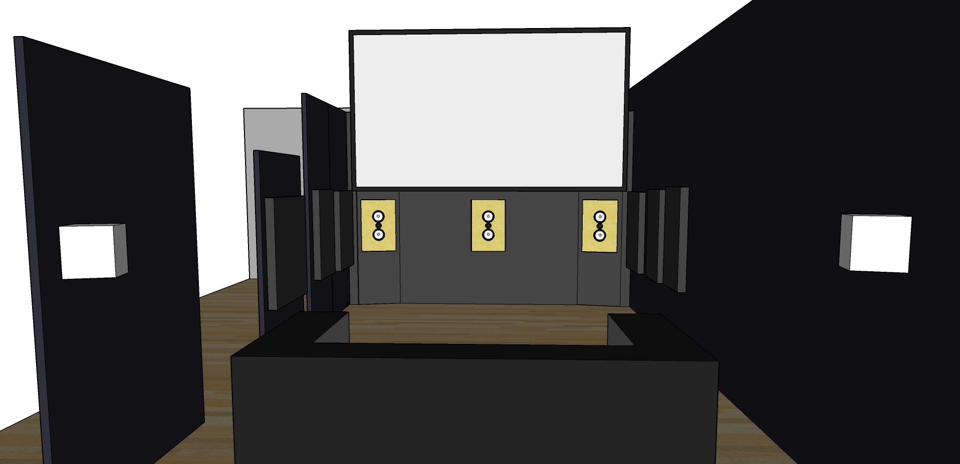

I added the 10° angles to the sides of the baffle wall. Here are a couple of updated pictures. First picture with the screen in place and the second picture showing the speakers in the wall (the tweeters are 40" off the floor -- they should be about ear height).

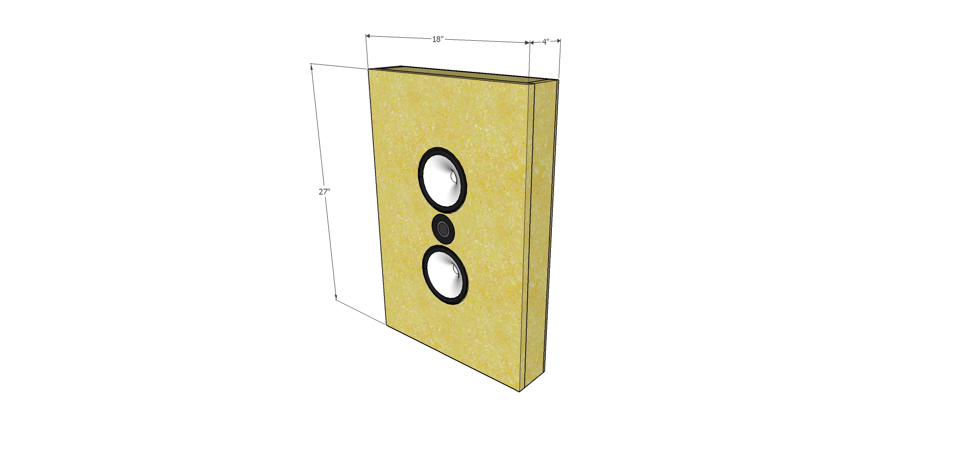

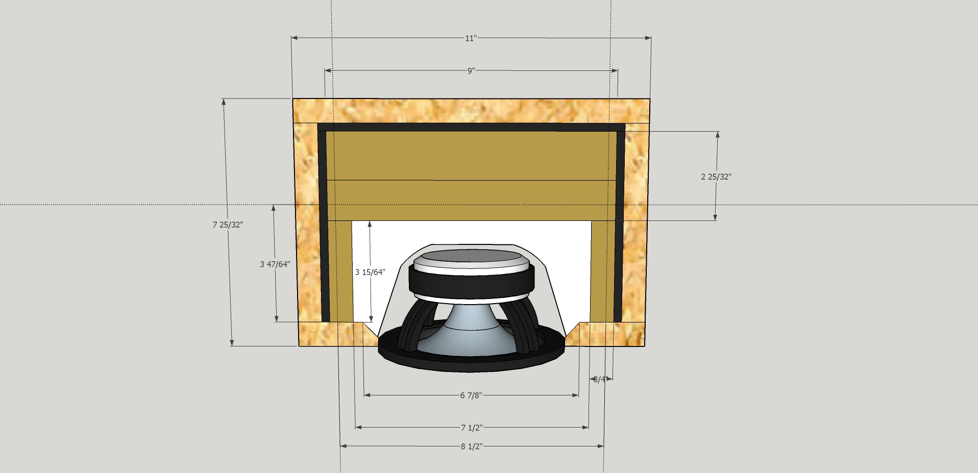

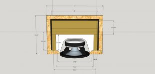

Here's the enclosure that I designed. I used the 1.6 golden ratio to get the dimensions. Let me know what you think.

With the couch 2 ft. out from the wall, I should be looking at somewhere between a 45° - 50° horizontal viewing angle with a 150" screen.

Everything pretty much looks good to me although I would change 2 small things. On the speakers, I'd leave about 1/4" between drivers just to leave a little more wood there. Second, I would change the shape of the front wall ever so slightly so that the screen frame isn't presenting a reflecting surface to the L & R speakers. So I'd stop the 10 degree walls at a width of about 131" and then leave the remaining little side strips flat again. Might make mounting the the screen a little easier too. See first 2 pics below. Also starting the 10 degree angle closer to the L & R speakers means the wall ends up being not as deep at the sides so again, the screen stays as far back as possible.
Nothing wrong with the way you designed the speakers above, but I would probably go a slightly different way. And this is just what I would do. Certainly not the only good way of doing it.
First I like to oversize my boxes and then stuff them with very high density insulation in the extra volume to better take care of rear energy absorption, helping to prevent it reflecting back out through the cone (the insulation must be dense enough that air doesn't pass so easily through it and so the drivers effectively 'see' a smaller box). And 2nd, for the purposes of saving both space and dollars, I would try to keep that speaker wall as thin as possible. I would actually try to build it with 2x4 studs and 1/2" drywall if I could get away with it, at least in the CC speaker section. (I'm wondering if you couldn't gain a few more inches or so by moving the wall back just a little bit too? That south wall hallway seems like a bit of wasted space.)
Speakers are pictured below. Dimensions are about 27" x 18" x 4" with 3/4" thick material except for the back which is 1/4". The back is so thin because we need to leave some room behind the drivers for the pole vents to breath (I've left 3/4") and we can get away with it because since it's in-wall, the speaker will back up right against the drywall on the other side making the effective thickness of the back 3/4". To avoid vibrations, I might coat the back of each speaker with a thick layer of cotton or a thin layer of felt or something like that.
So with speakers designed like this, instead of thinking of the back wave going in a rearward direction, think of it spreading out to the sides in a circular pattern. Image about a 12" diameter tube of space surrounding each woofer allowing for about the requisite 10L volume for Q=.7 and stuff lightly. Stuff the remaining space with the high density insulation, something like Roxul Rockboard, the same stuff you should be using for wall and ceiling acoustic panels. Bracing strategy is also pictured. At a minimum, I would also damp the front baffle with bitumen pads of some kind. For convenience sake, I might leave the xo's outside the speaker boxes, probably somewhere below each speaker.

Sorry that it has taken me so long to reply; I wanted to add the wall panels to the room model, but I've had little time to do it in the last couple days.
Here's the panels added to the room. I think that it will work great.
Panels open:
Panels closed:
Thank you for this great idea; I think it will have an immensely positive effect to both the sound and picture.
I also changed the baffle wall to start the angle closer to the left and right speakers (I wasn't sure if that would negatively effect the sound). I changed the angle from 10° to 15°, as now the speakers are aimed closer to the center of the couch.

Speaking of enclosures: while I don't foresee ever removing these speakers from the wall, there's always a slight chance that I'll want to upgrade somewhere down the line. For that reason, I'd like keep the enclosures designed in a way that they could potentially be used as bookshelf speakers (I know, the crossover won't be designed for this use). Framing the wall with 2x8's rather than 2x4's only adds 4".
I have a couple about designing the enclosures, however.
  • Is there a way to calculate the added volume needed to offset the fill?
  • Do I need to add any volume when using polyfill, or only when using more dense material?
  • If I (roughly) keep to the dimensions in my sketch, would you still recommend that I use some highly dense stuffing, or will polyfill suffice?
  • Is rubber carpet underlayment an appropriate substitute for bitumen pads?

I like the panels. Brilliant idea for the open position. I would keep the frames dark too though. I'm thinking one panel needs to be firmly fastened and then small rubber wheels under the other moving ones - the easier and more rugged they are too open and close the better.
I can't remember if you mentioned what you are doing for a sub(s)? More than 1 would be beneficial with your room shape. Well actually, more than 1 is beneficial for any room shape, but I thought a good place for 1 might be under that angled ceiling between the 2 dormers which would affect the construction of those panels. Also I would probably fill the panels with dense insulation but only expose it in the middle, making them both reflective and absorptive.
There are always compromises in audio - you just have to go with what works best for you. Though I haven't done it before, I expect the best place to start the change in angle on the walls it at the mid point between the CC and the L & R, but that will mean a deeper wall at the sides which brings the screen closer to you again. Increasing the angle also does the same thing. Moving the transition point closer the the sides and going anywhere between about 10 to 15 degrees seem like fine choices. Increasing the listening angle slightly too by moving the L & R speakers out a bit more isn't a bad idea either - the thinner speakers will allow you to do that - but I don't think I'd take them any closer than 12" from the side walls. My sketches had the driver centers about 16" from the sides.

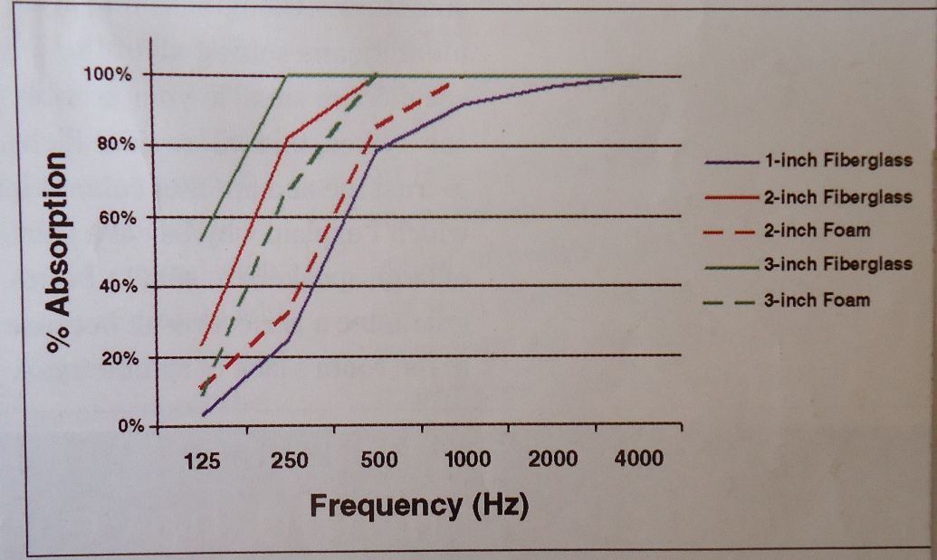

Back to the actual speakers. For 2 of those woofers, you need about 10L net sealed. Open cell foam and polyfill actually increase the effective box volume somewhere by about 10 -15% or so, so you can actually go a little smaller than that. Given your dimensions, I get 14L. Lose about 1-2L for drivers, bracing, damping and maybe xo volume and you've got 12-13L. So those are actually already oversized.
If you added 1 layer of 1.5" Roxul 6lb per cubic ft Rockboard to the back wall, that would take up an extra 3.5L or so. That'll help and still leave you with a little more room to add more Roxul. Attached is a graph which shows different absorption rates of Rockboard vs acoustic foam at different frequencies. You should see that's it's pretty easy to absorb the HF but more of the thicker, denser stuff is needed to absorb the LF. And your's are going down to 80Hz or so. What I was trying to achieve with the wide and tall dimensions I posted was a minimum of 3" thickness of Roxul all the way around the perimeter of the speaker. Adding 2 layers to the backwall of your design will be a little too much unless you add a little more volume to maybe the top and bottom.
Vitally important with this method is that you leave enough room behind the driver and the magnet for them to breath. Ideally, I think I'd go for 1 layer on the sides and top and bottom too if you can. I'll scoop out some insulation here and there if it gets too close the the sides of the drivers. The Roxul insulation can have loose fibers though so add a layer of polyfill everywhere or perhaps cover the rockwool with some felt or cotton or something similar. I have no tried and true formula for this. It appears to me that the thicker the insulation gets, the less it breaths. So it depends how you use it - excluding the Roxul, if you have about 8L net left over and add some polyfill, I figure that should work well. In the end, your in-box, in-wall measurement will tell you if adjustments need to made.
Damping material works best with mass and some flexibility. Carpet underlay absorbs ok but doesn't work well for damping. Check out Home Depot for something like Peal and Seal or Blue Skin in the roofing section.

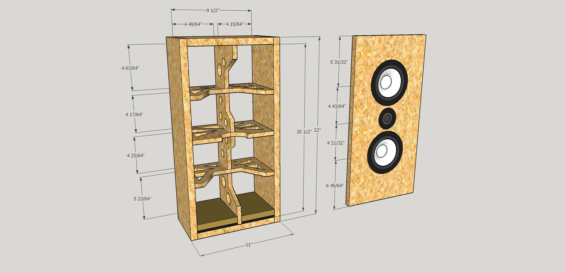

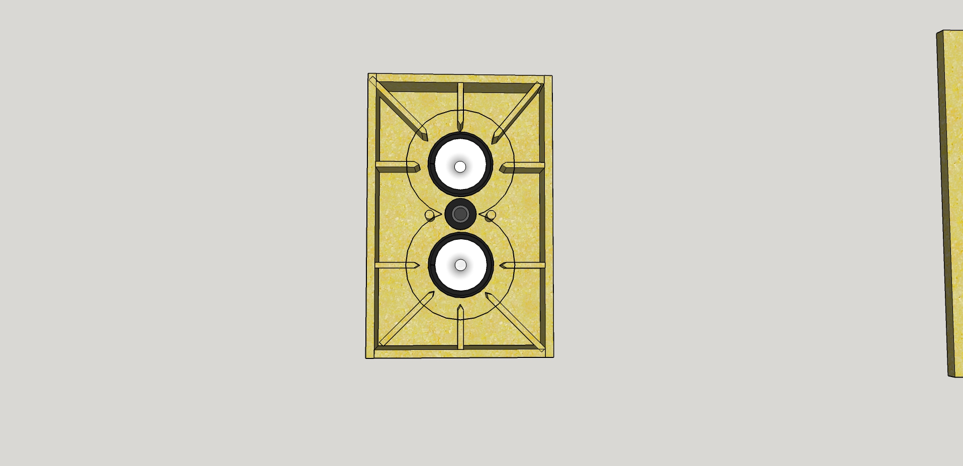

Here's a new design for the speakers, somewhere between our two original designs.
12" is about as wide as I can go. I added 2" thick Rockboard to top, bottom, sides, and back walls; the remaining space will be stuffed with polyfill. I would like to put the crossover in the enclosure, but it might not fit; I'll have figure that out.

If you are happy with those dimensions, that will work fine with the following small changes. Crunching some numbers, I get a 6.5" x 26.5" x 4" space free of insulation which is 11.3L. Although that rockwool is very dense, I figure the driver will still see a little bit of it as breathable, maybe about 1/2". So now you've got a gross volume of about 7.5" x 27.5" x 4.5", so 15.2L. If you add a 1/4" damping layer, you're now looking at about 13.2L. I'm guessing, subtract about 1L for bracing (calculating only in the uninsulated area) and driver and xo volume but you'll more or less get that back with the addition of polyfill. So I'd still say you're about 2-3L too big. That's for a Q = .7 Nothing wrong going with a little bigger box and a lower Q though, F3 still remains below 80Hz even with Q = .5 with about a 30L box.
Also to help create different size panels between the braces I suggest:
- move all the drivers up a 1/2" or so
- add a center vertical brace top to bottom. Offset it maybe 1/4-1/3".
- go with 4 horizontal braces instead of 2
Here in my neck of the woods, that Rockboard comes in 1.5" thicknesses. It makes life easier if you can design the speaker insulation (and acoustic panels too) in some multiple of that, but on the other hand it's also very easy to slice up to whatever dimensions you need it in.
I think you'll need to just do a dab of insulation trimming right at the sides of the woofers since a 45 degree backside chamfer around the driver creates an slightly larger opening than 6.5".
I was also going to mention that besides needing to change the xo if you wanted to take these speakers out of the wall and reuse them in the future, you might want to also put a 1/2" or 3/4" roundover or chamfer on the edges of the front baffle. Maybe you'll need to put a new baffle on to do that so you might want to also make the current one detachable.
Now if you wanted to keep the footprint more similar to your previous dimensions, I get something that looks pretty acceptable at 11" x 22" x 7.75" (I added another 1/4" to the depth as I think you should have 8" to work with). I used 3/4" insulation around all the sides and 2 3/4" on the back wall. See attached. White is the polyfill and black is 1/4" of damping material. Gross effective volume when including 1/2" of the rockwool insulation results in 8.5" x 20" x 3.75" which is 10.4L. Second pic shows the bracing strategy I would use. I'm happy with 1/2" thick bracing here. Make it plywood if you want to screw into it. Actually the whole speaker is better in decent quality plywood, but that's another added expense over MDF I think.

Doesn't this imply that the sofa should sit closer to the rear wall? This room forces early 1st reflections regardless, so why lower the nulling frequency, making it harder to absorb? Is there some other advantage to having more open area behind the MLP?
For home theater, surround speakers are always best when they are behind the listening position whether that's 5.1 or 7.1. Putting the couch right up against the back wall makes that a little hard to do and would also put it right in the peak of the lowest room resonance, so..... most likely boomy bass.
I'm not sure I'm quite following the rest of your question. I'm not super knowledgeable in this area but as far as I know, every room dimension produces a number of different resonance frequencies with both peaks and null(s) at different locations in the room.
Compared to the direct path, the rear wall's reflection also travels from ear to wall and back, so twice that spacing. If you're 3' out, the reflection travels an extra 6', right? That's fully out of phase at the wavelength that's twice as long again, so 12' in my example. This is 95Hz & difficult to address. Get your ears 1' from the back wall, and the cancellation happens at 280Hz, which can be absorbed pretty well without needing a massive panel.
Because the room won't allow 10' or more from MLP to back wall, the reflection definitely will fuse with the direct signal (rather than being heard as a discrete source). And because you can't avoid this fusion, I suspect the closer position's flat FR is more desirable.
Your point about the surrounds makes total sense, of course. That said, a closer spacing with electronic delay on the surround channels might be the best approach.

When I enter the T/S parameters for the SB15NAC30-8 into WinISD and put two of them into a sealed box, here's what I get:
I'm getting 13.6 liters for a Q of .707 (14.05 liters for .7). Did I do something wrong? Or, am I missing something? I got the specs from this page.

Am I understanding correctly that I don't want any of the braces equally spaced? I had no idea.
"I think you'll need to just do a dab of insulation trimming right at the sides of the woofers since a 45 degree backside chamfer around the driver creates an slightly larger opening than 6.5"."
Are you saying that I should chamfer the inside edge of the cutouts that I make for the woofers? (The round cutouts in the baffle)
I was thinking about rounding over the edges of the baffle, but would that negatively affect their performance when in the baffle wall? They are almost certainly going to be staying in the wall, so if it's better to leave the edges square, I'll probably just do that.

Your specs are good. Nothing wrong on your end. But I like Unibox more than WinISD though. I just find it so much easier to use. One needs Excel though and an old version at that.
Among other things, Unibox allows you to vary the stuffing effects (maybe WinISD has the same thing, I can't remember), so with an empty box I get about the same thing as you do - about 13L with Q =.7. However, with stuffing you need to use a smaller box for the same Q, so with heavy stuffing you only need about 8 or 9L for the same Q of .7. A nice middle ground seemed to be about 10L since I'm not exactly sure how Unibox's Absorption Q relates to the real world use of the Roxul and polyfill. Usually people want the smallest boxes possible too. In the end, it's best to measure the result once the box is fully treated and stuffed - that will ensure you end up with the FR that you want. However, I dare say that with the use of a sub you're not going to really notice any difference in response between a Q of .5 vs .7. So 10 or 13L I think will work equally fine and your last design actually employs more Roxul than mine did so that's should mean more absorption. I think you've got a good handle now on how to design these, so go with whatever suits you best. Sometimes it comes down to a cut sheet and how much wood I'm going to use 1 way or the other.
Rockboard at 2" - excellent. That makes your design much easier to implement. Like I said, my neck of the woods........
Braces stiffen the cabinet walls and break them into smaller sections and thereby raise the resonant frequency of each of those smaller panels. And at higher frequencies, there's actually less energy there to excite them too. But if they are all the same size, they will all start resonating at the same frequency when that particular note is hit. By varying the panel sizes as much as possible, you should hopefully get less panels resonating at a single frequency and so not be as easily heard.
Yes, chamfer the backsides of the woofer cutouts. A 45 degree router bit works nicely but I've used a jigsaw for a slightly messier job of it before. Leave some wood though where the screws attach. See pic below but I got that done with CNC.

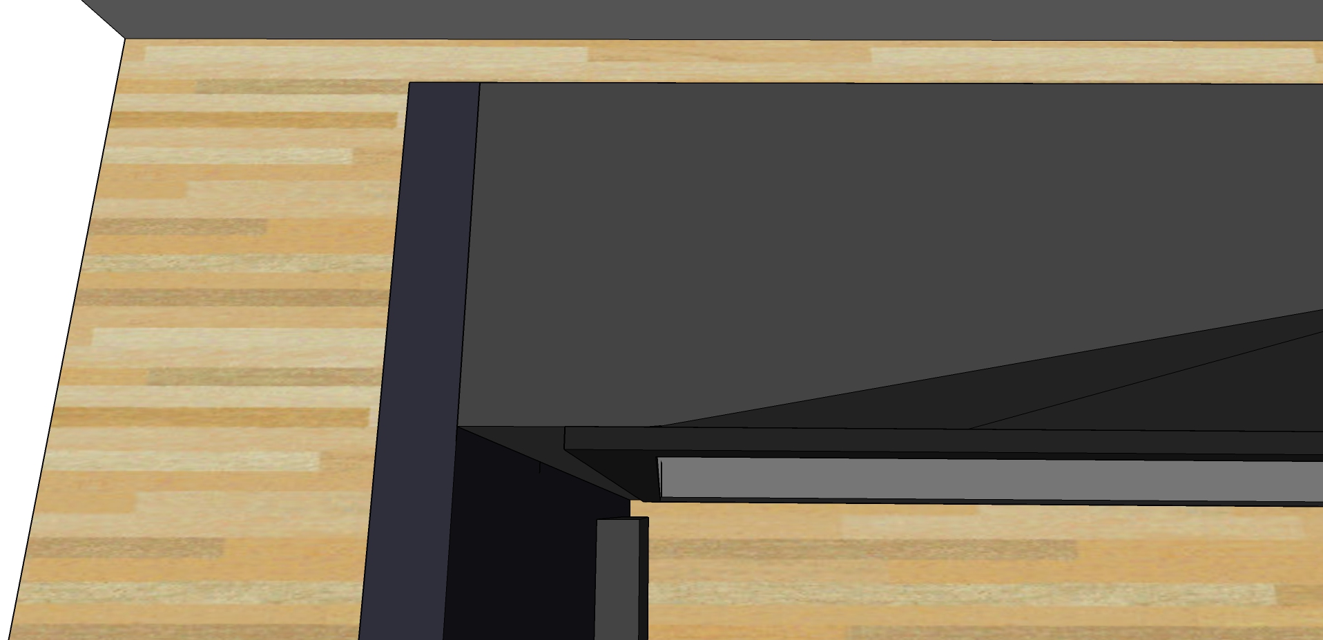

For in wall, any edge treatment would be counter effective - you want the smoothest transition possible between the speakers and the wall. That will avoid any diffraction effects completely. That means a flatter, smoother tweeter response.

I'll probably just keep the edges of the baffle square, then.
That makes perfect sense regarding the spacing of the bracing ( :cool: ); thanks for the explanation.

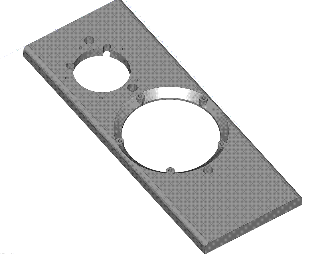

Is that a picture of the front of your baffle? (I'm guessing yes, judging by the roundover on the sides.) How would that work if I'm flush mounting my woofers? From your description, this is what I thought you meant:
(That's using the cutout dimensions for my woofers)
If my drawing is correct, what benefit is there to the 45 degree angle? (I'm not insinuating that I think there isn't one; I have no idea and I'm genuinely just curious.)
Excel got some updates a year or 2 ago that rendered some of the functions non usable. Bit of a pain. There is info out there on getting around that if you want it.
No, the picture was of the back of the baffle. Maybe it wasn't the best example on my part - the baffle fit into the front of the cabinet and the roundovers were for easier woodworking purposes, not anything acoustical. (Poor) pic of the speakers below.
You've got the right idea. The chamfer just allows better of the sound out the sides of the driver. Although with the SB's, I've noticed how they like to do quite a wide front flange so there is actually a fair amount of clearance already. Still, it's all the little things that hopefully add up. Traditionally, you would skip the 1/8" section - just make it a full 1/2" chamfer.

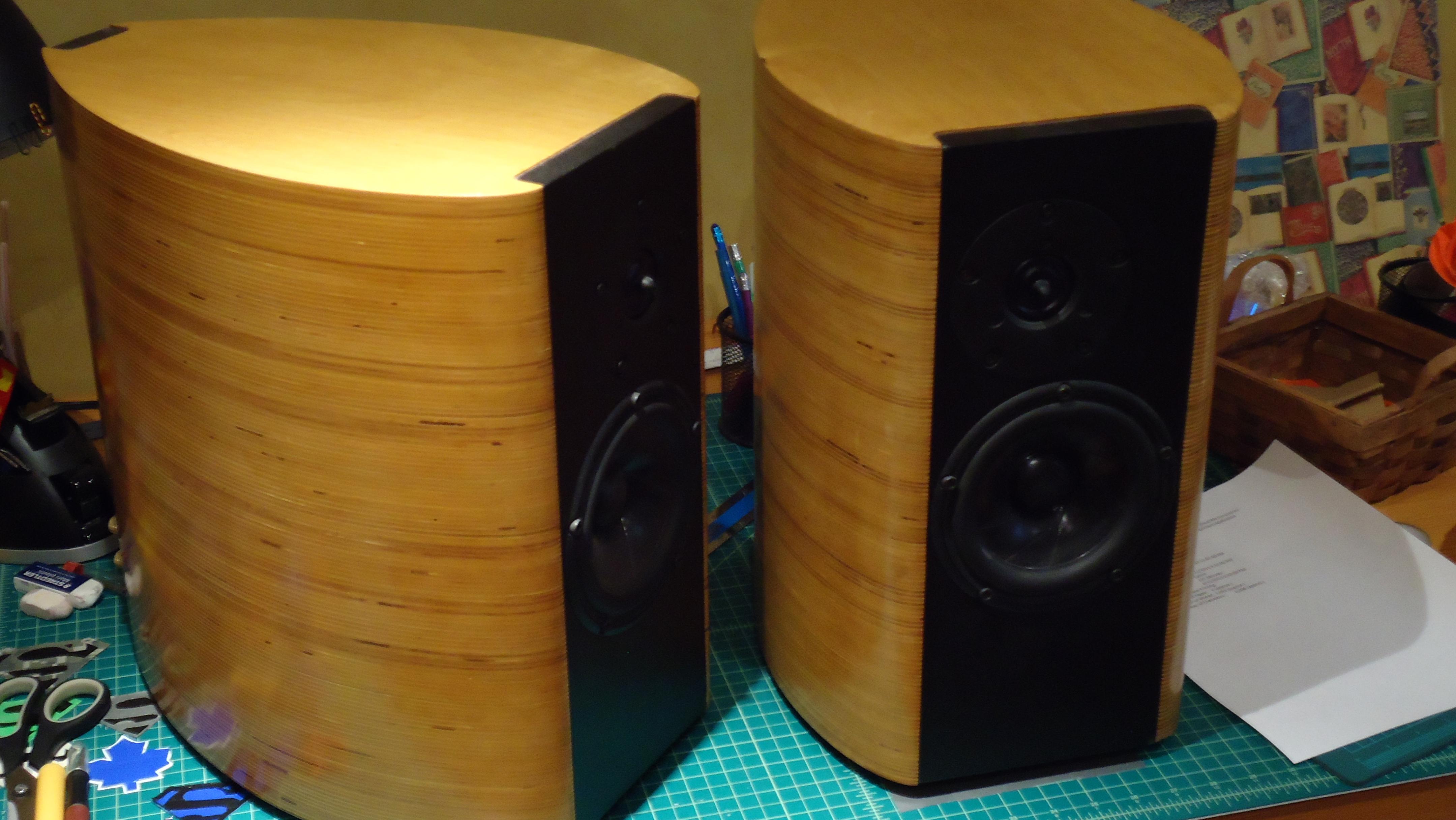

Wow! Those speakers are beautiful.
The woofers and tweeters were delivered today (I didn't end up having to pay any duty :shrug: )
I'm waiting to hear back from some local shops whether or not I'll be able to order a small quality of Rockboard from them. I can't find rigid insulation boards of any kind in stock anywhere.
Exciting when you finally get your hands on them isn't it?
I guess maybe I'm lucky - I can get Rockboard at my local Home Depot.
Thanks for the compliment. Those were my attempt to replicate the design of the old Magico Minis. My brother is enjoying those now. And yes, the back half is full of high density rockwool. :D
