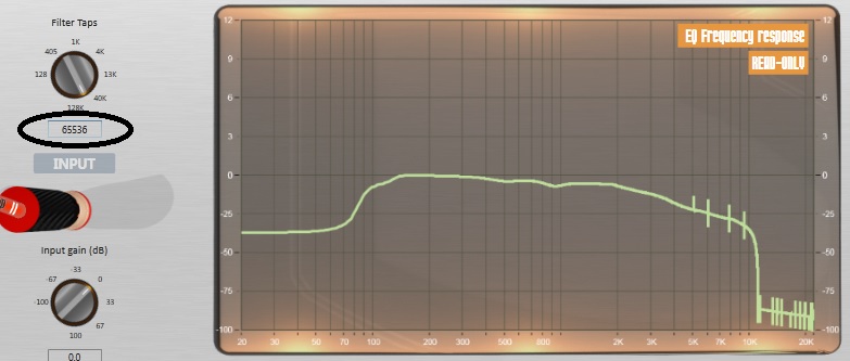

Thank you for supportwatched the video and looks very good.
1. Can actual measured driver frequency responses be loaded?
2. Can acoustic targets be specified and filters optimized towards that?
In next few days I will record videos about basic use cases of the crossover.
I'we planned next topics:
1. FIR and IIR filters - overview and setup
2. Usage of linearized IIR filters
3. EQ and Phase EQ corrections and "version3 Correction" utility
4. Pre-processing channel setup
And your question will be reviewed in third video.
In two words - yes, you can use EQ (and phase EQ) processing filter to load correction data ("inversed" measured data) from text file. Format of text file:
[frequency] [gain]
in each line.
Example:
Code:
0 -100
42 -100
45 0
110 0
115 -100
20000 0
EQ filter for driver correction can be located in pre-processing channel.
Also, crossover's installation contains "version3 Correction" utility - simple program, which helps to convert ("inverse") measured data (WAV file) into correction data in text format.
And small animation, illustrating loading of EQ data from text file:

Max, this is a very interesting piece of software. I have a couple of questions:
1- Any facility to play Windows sound (desktop, web) through the crossover? In other words, any plans for a WDM driver?
2- I have imported a FIR convolution file created in rePhase. It contains both frequency and phase correction. Does the crossover require setup of two processing stages, one for EQ and one for phase, with the same convolution file loaded in each?
3- Related to above, I notice that I am getting much reduced fidelity (apparent in the graph window) when I import the convolution file into the crossover. I am exporting/importing a 32-bit float file with 65K taps. I have matched taps between rePhase and the crossover. Whereas in rePhase I see a floor down below -200 dB in the crossover I see a floor in the range of -80 dB and odd ripples at 5KHz and above. I have attached screen shots. Is there a way to improve?

Michael, thank youMax, this is a very interesting piece of software.
At this moment no, I'm not planing to include WDM driver into crossover's distribution. The main reason - I have no resources yet to support such piece of low level code. And Win7+ requires drivers signed by certificate, validated with known CA - I have no such certificate yet too.1- Any facility to play Windows sound (desktop, web) through the crossover? In other words, any plans for a WDM driver?
Yes, amplitude envelope can be loaded into EQ component and phase envelope (if required) - into Phase EQ component.2- I have imported a FIR convolution file created in rePhase. It contains both frequency and phase correction. Does the crossover require setup of two processing stages, one for EQ and one for phase, with the same convolution file loaded in each?
But inside DSP only one FIR filter per channel would be created, regardless of channel configuration in UI.
I really appreciate you for this reply!3- Related to above, I notice that I am getting much reduced fidelity (apparent in the graph window) when I import the convolution file into the crossover. I am exporting/importing a 32-bit float file with 65K taps. I have matched taps between rePhase and the crossover. Whereas in rePhase I see a floor down below -200 dB in the crossover I see a floor in the range of -80 dB and odd ripples at 5KHz and above. I have attached screen shots. Is there a way to improve?

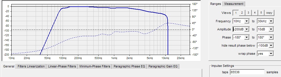

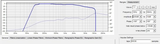

In you video https://www.youtube.com/watch?v=2dBozhhflyA
"IIR filters with FIR linearization", the band-pass filter has only -40dB attenuation in the stop-band.
Why is this happening?.
Bohdan,In you video https://www.youtube.com/watch?v=2dBozhhflyA
"IIR filters with FIR linearization", the band-pass filter has only -40dB attenuation in the stop-band. Why is this happening?.
it's a measurement error - was precission loss in response analyzer.
Already fixed in current version.
