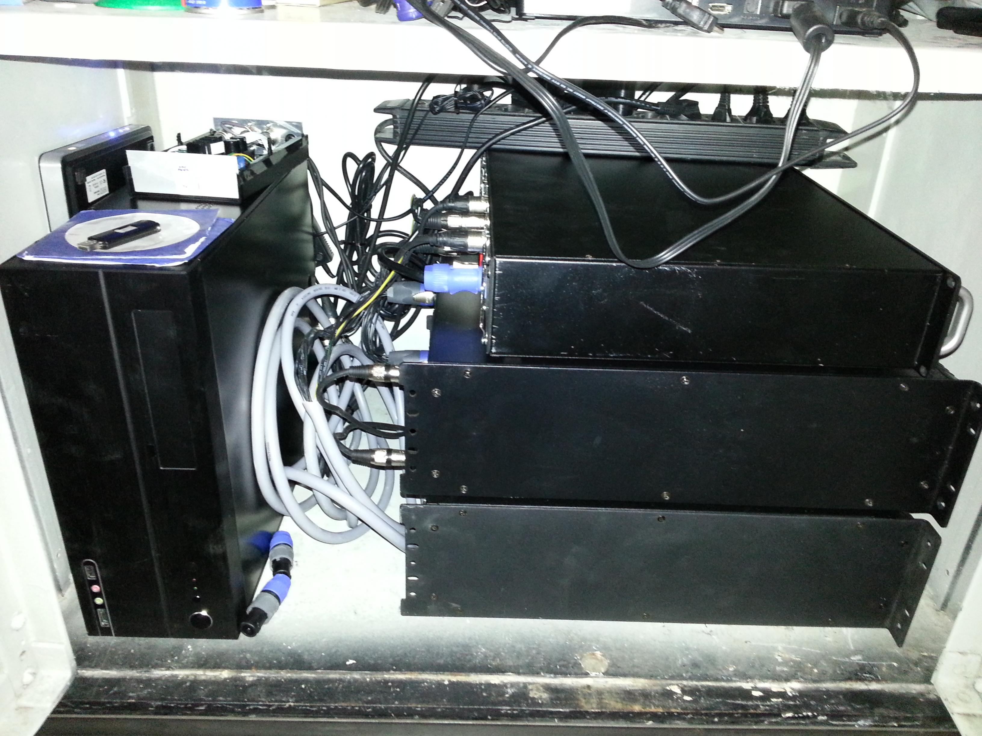

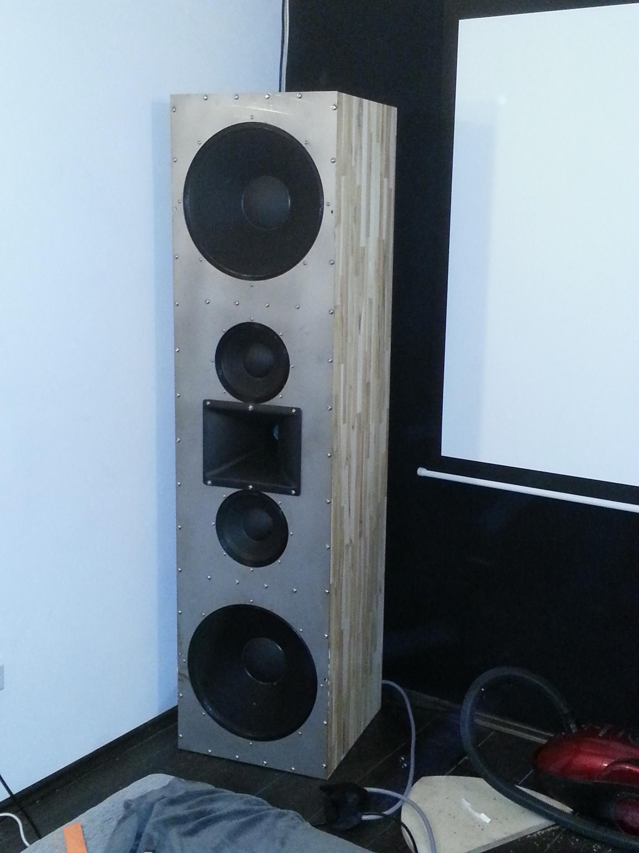

Fortunately the setup of my home speaker System was already quite good fitting. I use a PC for playing the music and also movies for the beamer. The Audio output is 3x AES/EBU Signal coming from a cheap Marian Trace D4 Sound card (got for 90 Euro on ebay and works really well). As AES/EBU is compatible to Spdif a usual DAC is used for the subwoofer amp (T.amp Proline 3000). The Amp for mids and tweeters is a KS Audio TA4D which is able to receive AES/EBU Signals and has internal DAC. The speakers itself are maybe also a bit inspired by PA… ;-) 4x18” Beyma sub (18g40); 4x 10” mids (Beyma 10lw30?) and two Radion 950 tweeter. A discussion if this setup for a home cinema makes sense is obsolete….it makes no sense, but fun!

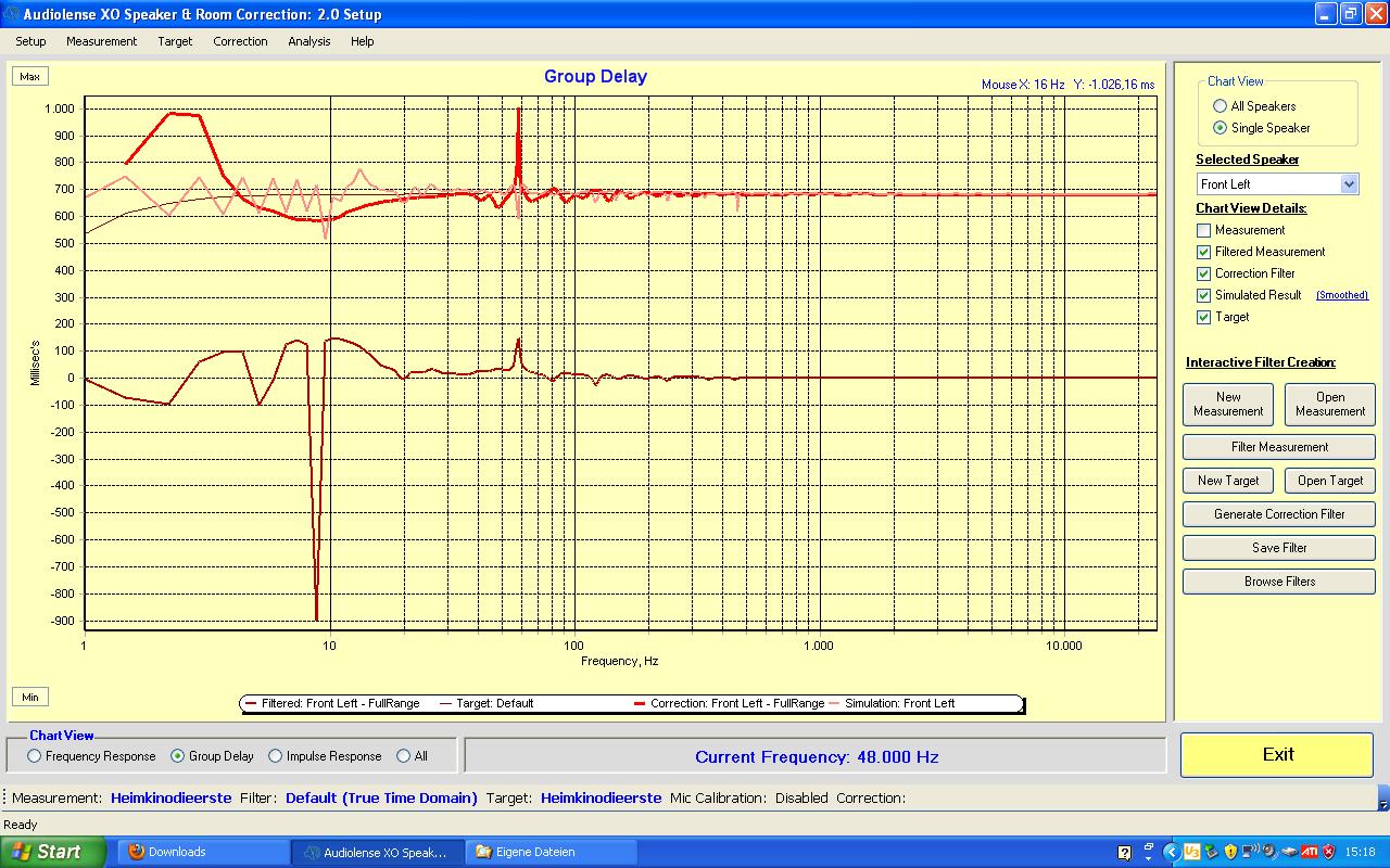

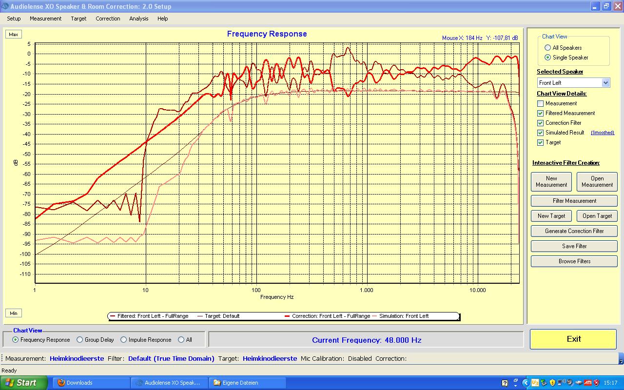

There are several options how you can use Audiolense. The easiest way of all is just to go for the Plugin in Windows media player . As this is the fastest way for a first Impression I went for this one and installed the plugin while my active crossovers in a VST-Host program were left untouched as well as the formerly measured delays. In this configuration Audiloense only saw 2 channels without active X-over; comparable to passiv speaker setups. The procedure in Audiolense itself is very straight forward. Define Speaker Setup, Measure, Filter, Create Target; Create filter files. After done this one a new measurement with maybe new Target design is done within 2-3 minutes maximum. During measurement also different hints and recommendations can be found so to get a proper measurement is really not too difficult. At this first tests here I used a MM1 microphone but the microphone calibration data were not yet here. For this mic you can just ask for them at the manufacturer (did not know at this time). So this is one of the improvements I should do next time ;-)
Anyway after creating the filter in a few steps and insert into plugin first listening session was started. I could now end up in long explanations how nice this and this and the detail here and there is…. But nobody is interested in such explanations surely. The only thing that needs to be said at this point is, that you just get the most exact music reproduction according to you target curves that is possible. I just love it…. By the way my target curve for first try was really simple; I will also play with that next weeks but for a first test this was already ok (high frequencies a bit too sharp and loud maybe..)

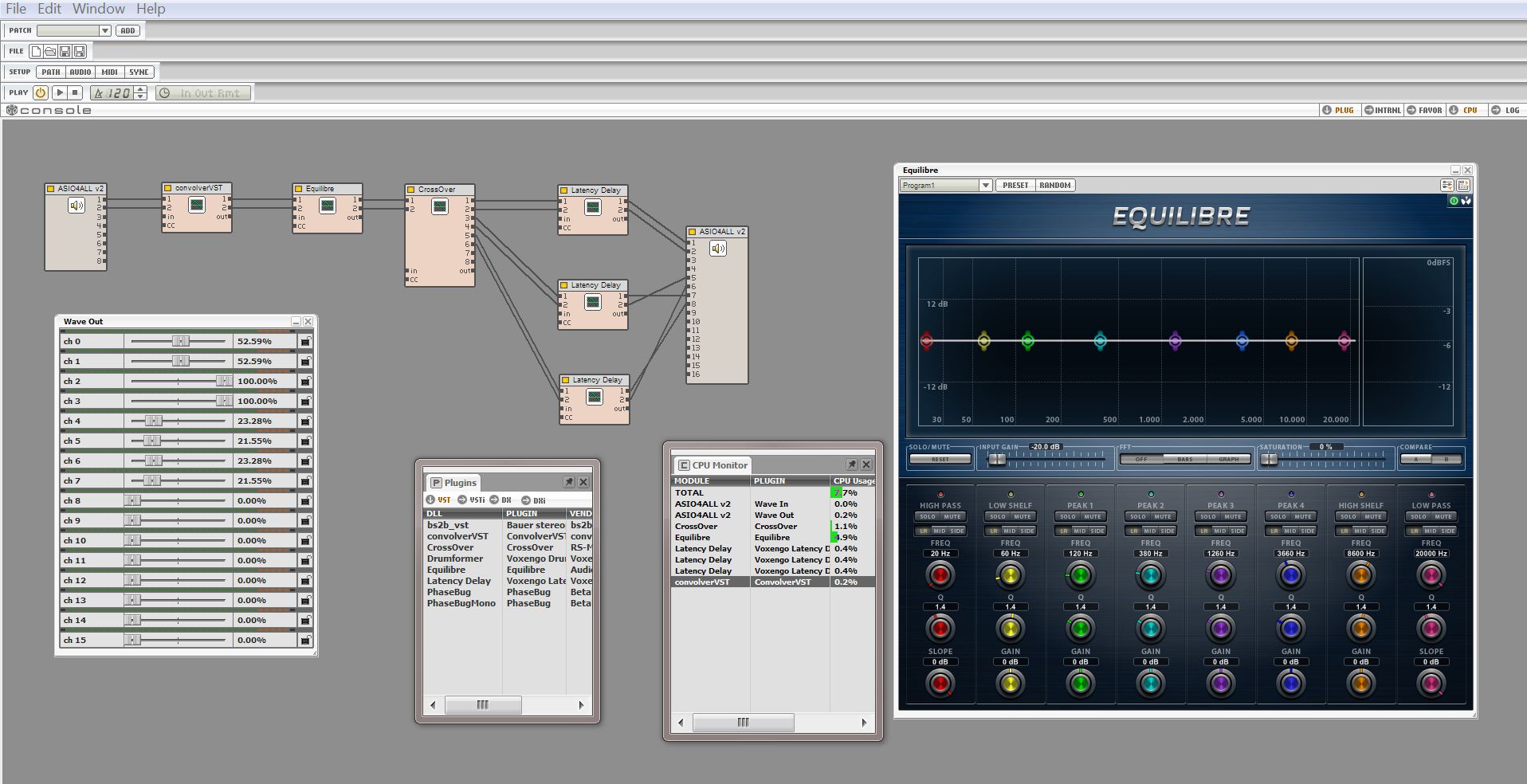

The WMP plugin was only a first attempt. I usually never use this and instead use spotify for music. Actually I started now to set up a VST-Host Programm (Console by Art Teknika) with convolver.
As the convolver causes a small delay I also want to have the option not to use it as some streaming players from internet do not provide a audio/video delay. For movies played local with for example VLC this is no issue. So in the VST Program I have 2 settings now; one with and one without the convolver. The EQ is not used together with FIR filtering. As you can see on the pic at the moment the delays and crossovers are still done by hand and convolver plugin only is stereo. This I want to change in the next days to give Audiolense then access to all the single speakers. I assume this should bring another improvement together with finally the mic calibration file…!?
