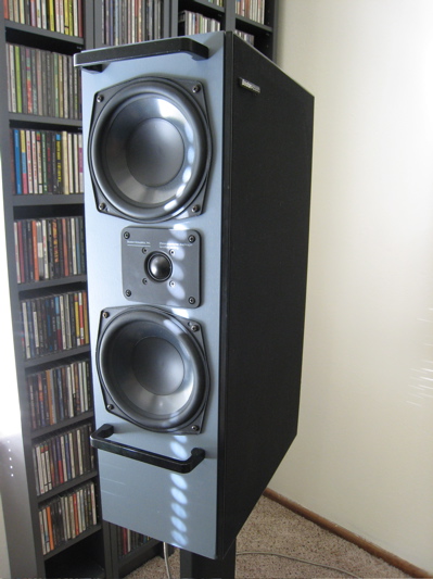

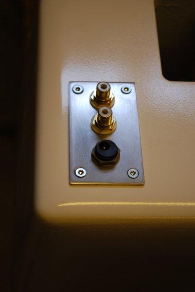

You can use gray sandable spray primer available in a spray can at just about any hardware shop. It fills in small imperfections, dries fairly quickly, and can be sanded over and over if needed. It sticks to most anything that isn't greasy. In the attached pic it's adhered to vinyl simulated wood. I actually like the gray color itself and if the can is kept shaken up, the color comes out very even in a nice satin finish.
I used this method combined with regular white spray paint.
This will not give you a perfect finish but if you're short of time and patience it will do.

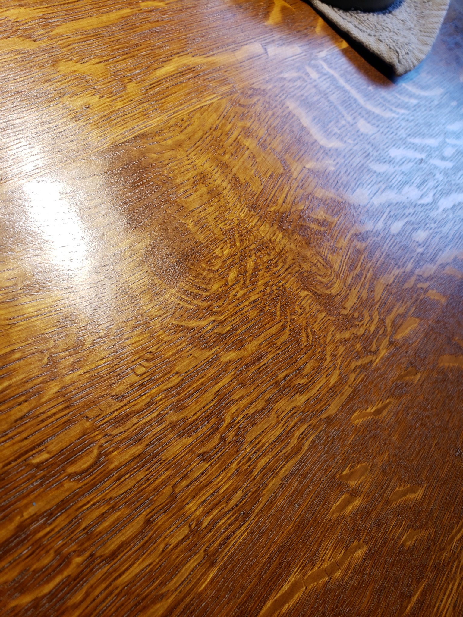

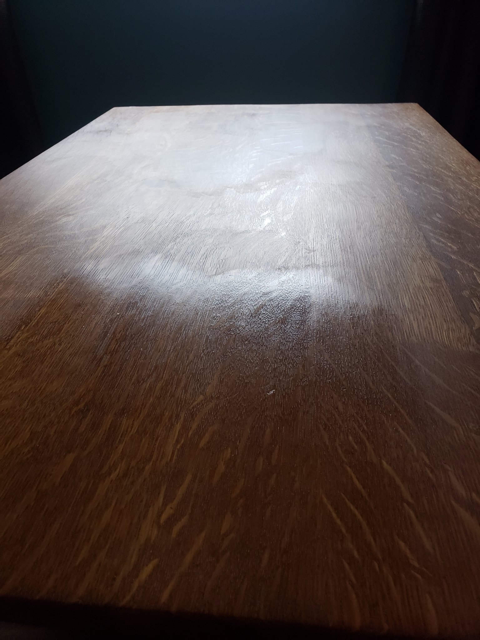

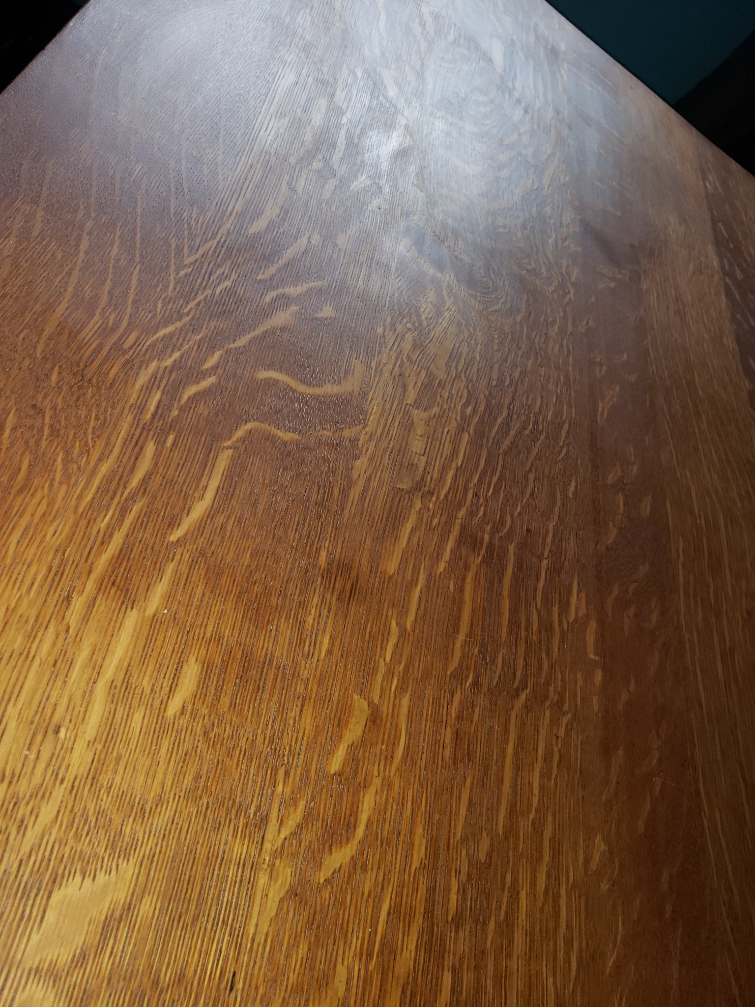

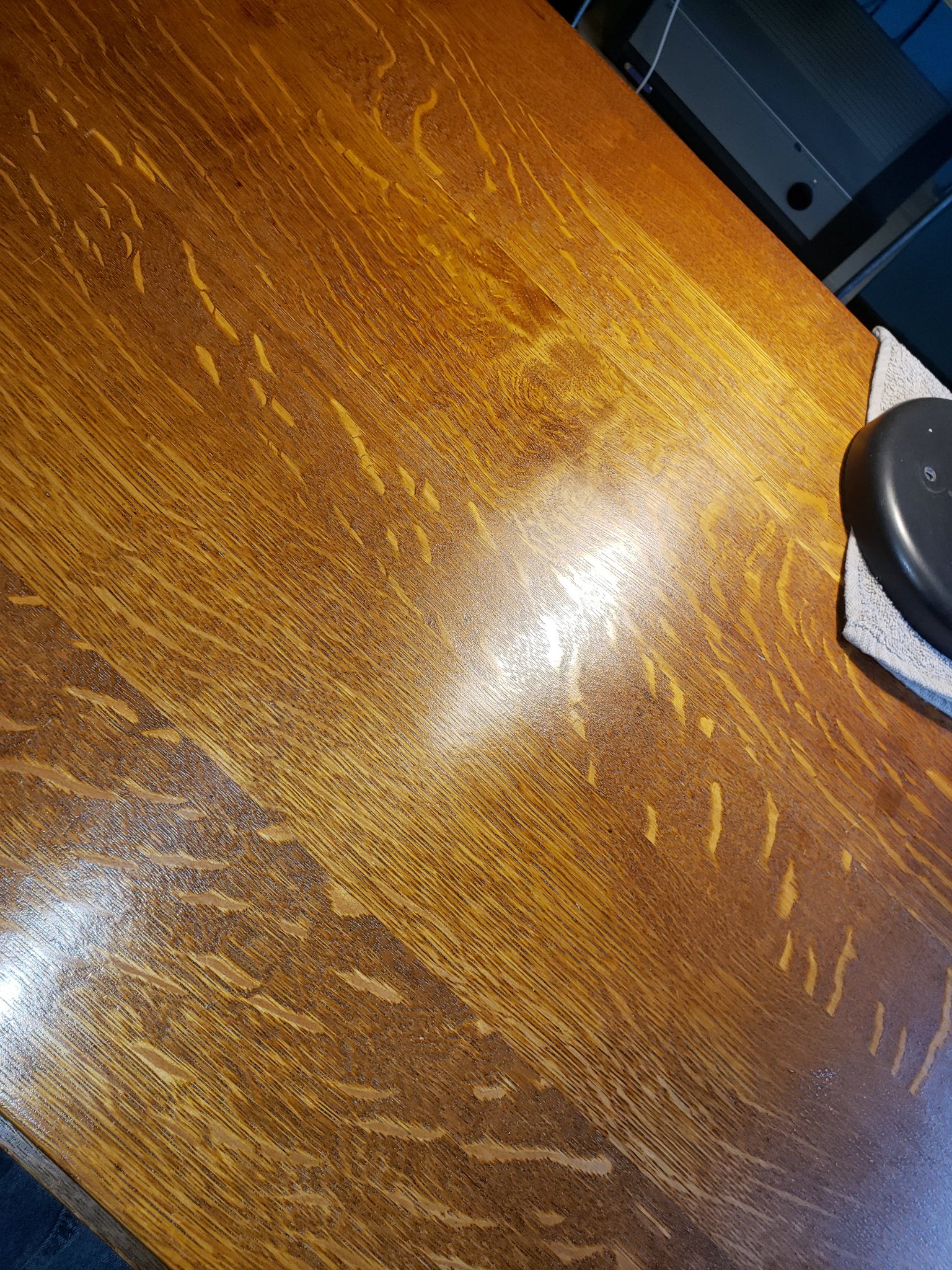

With veneers waxes with carbuba work good. Oak has deep natural grains, its going to take 3 wax applications.
Its starting to look buttery. Pictures dont do it justice, its worth the extra bit of effort. And should last a good while, even on desk surface that sees a lot of traffic.
