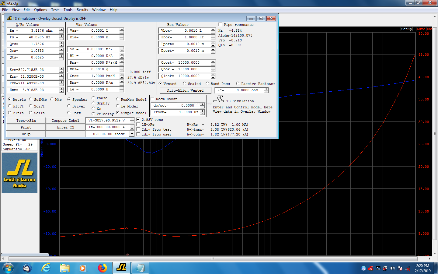

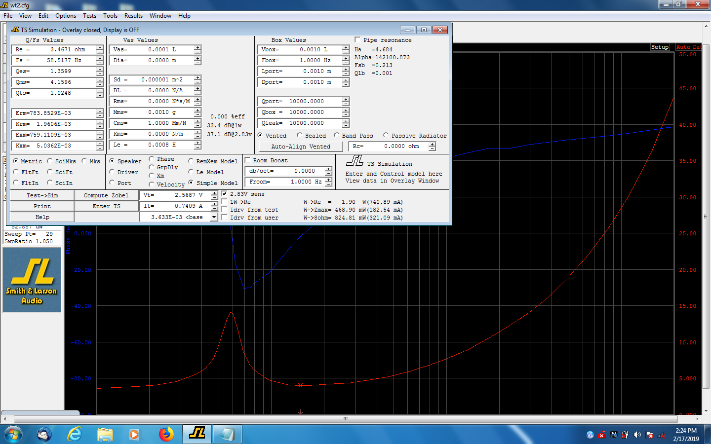

Next, I got the Woofer Tester out and tested both the old GRS 10" subs, and the new GRS 12" subs in their completed cabinets. I'm relieved to know my perceptions were accurate and I'm not suffering from builder's bias.
The GRS 10" completed subs measured Qts (which Jeff Bagby says = Qtc) is 1.0248 and Fs is 58-Hz. My enclosures are approx. 1-ft^3. My initial WinISD model didn't account for the driver's volume, so if I allow for the driver's approx. volume and specify .85-Ft^3 in WinISD, and change Qa to 10 for a heavily stuffed box, WinISD predicts 1.012. So predicted is very close to actual, it seems.
The GRS 12" completed subs measured Qts (= Qtc) of .6625 and Fs is 40-Hz. My enclosures are approx. 1.6-ft^3. But once again, my models didn't take into account the driver's volume. Using 1.4-ft^3 in WinISD, and changing Qa to 10 for heavily stuffed, and setting Ql to 3 per Jeff Bagby's post, WinISD predicts a Qtc of 1.187. So it seems practice beats theory this time. I think Troels Gravesen says you can't model aperiodic enclosures, maybe he is right.

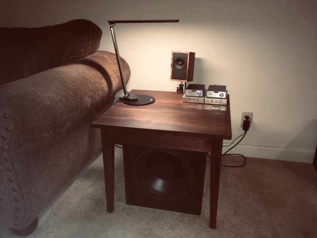

I've included a few pics. One shows one of the subs under an end table (there is another on the other side of the loveseat, under an identical end table). I'm also including pics of the inside and outside rear panel (showing the aperiodic port construction). In a nutshell, I've used compressed poly batting between two pieces of plastic screening, between the hardwood panels recessed into the rear panel.
Also screen shots of the Woofer Tester results of the old and new subs.

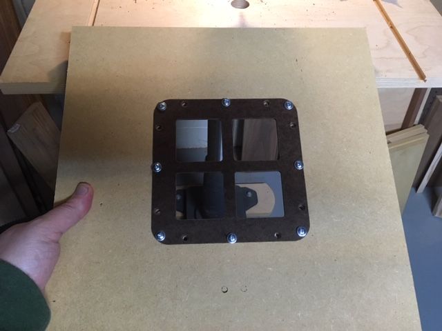

truly commendable and cool !! What did you use to fabricate the aperiodic port's frames? Whats the frame size?
Sorry for the delay, hadn't noticed the question.
The ports are made from 1/8" tempered hardboard (the stuff that is smooth both sides). They're 6.5" x 6.5".
There are two, ones is glued/screwed to the inside of the cabinet, and the second is screwed into weld nuts that are glued to the inside unit.
Hope that helps.
that is helpful - thanks for your time. Is the batting ~3/4" bonded Dacron ?
Yep, that is exactly what it is, two layers.
So think of it was a sandwich. The two pieces of hardboard (each with the four large holes) are the bread.
Then there are two pieces of plastic gutter screen (purchased at Menards).
And between those is two layers of the 3/4" bonded Dacron (purchased at Walmart).
I added the gutter screen because I figure the Dacron would need support to prevent from blowing out the hole, and yes, I was correct, there can be quite a bit of air movement there.
....Also screen shots of the Woofer Tester results of the old and new subs....
Could you just "walk us through" those screen shots? What are we looking at and what does it tell us?
The speaker measurements are what we need to see, more than detailed invocations of the sims to three decimal places. Or how the near-field or open-field measurements compare to the sims.
Thanks.
B.
Thanks.
B.

The first one (1) is just a shot of one of the completed new subs living under one of the end tables.
Second (2) shows the inside of the back panel, with the inside piece of the aperiodic panel glued and screwed in. You can see some extra holes, that is where my weld-nuts get glued in (I just hadn't done it yet). Weld nuts are like tee-nuts, but don't have prongs. I hot-glue them into the holes, and the screws that hold the outside aperiodic panel in place thread into those weld-nuts.
(3) Shows the rear of the completed sub with the aperiodic port assembled. The eight screws you see are inserted through holes in the rear panel and thread into the weld nuts I refer to in #2 above. So the screws pull the entire assembly together.
(4) The Woofer Tester result for the old (10" sealed) subwoofer. You can see a Qts (which is = to Qtc) of 1.0248 and Fs (which is = Fc) = 58.5177-Hz.
(5) The Woofer Tester result for the new (12" aperiodic) subwoofer. You can see a Qts (again = Qtc) of 40.8985, and Fs (= Fc) of 40-Hz.

Oh, the weld nuts I use, I get them from McMaster. The part # for these is 90594A111. They are narrow base. I apply hot melt glue to them, and push them into the holes. The hot melt glue squeezes out and makes a little sort of mortise for the nut, so it won't spin.
This is the same method I use for mounting drivers, they won't budge from the hole, removing them requires heat, or you'll damage the baffle. I've posted about this method at techtalk.parts-express.com a few times over the years but I don't think anyone has copied it yet.
You can also use tee-nuts, just break the prongs off. You just want something that ideally isn't perfectly round.
Hope that helps, let me know if you have other Q's.
Typo alert! 40.8985 = .6625.
Thanks. I gather that's a set-up for measuring T/S values? Do you have measurements of the sound output?
B.
B.
I don't have any anechoic or quasi-anechoic measurements, sorry.
