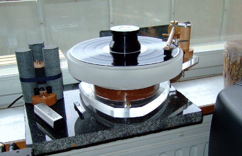

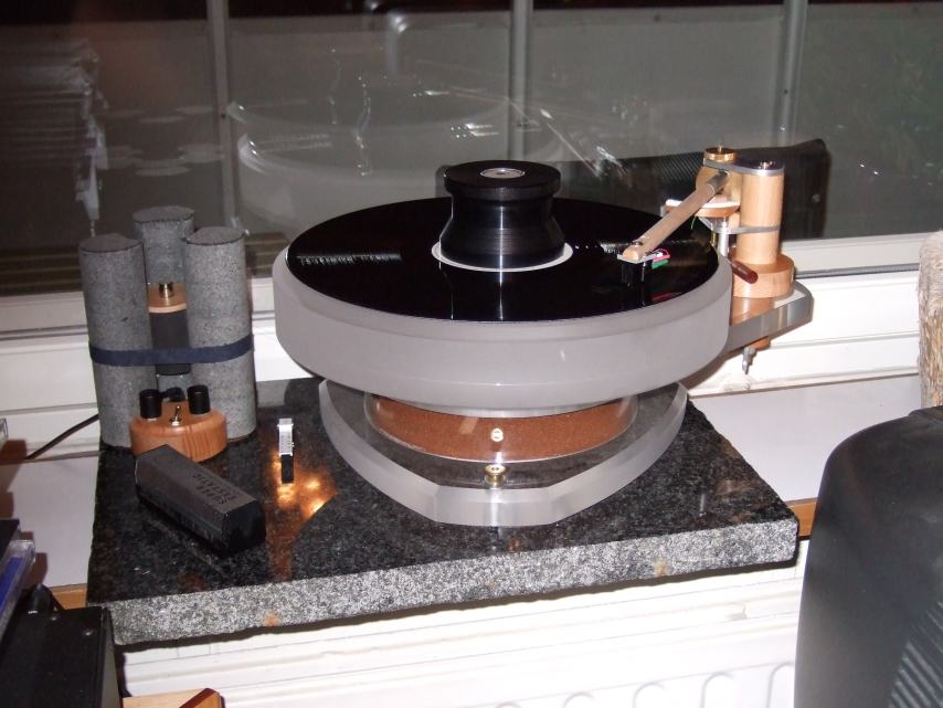

Fomob said:Very nice looking table. I am curious about the clamp. Where di you source the record clamp or did you make that?
Hi Fomob,
The clamp is made of aluminium, just a wheight - no threads. I bought it from Scheu Analog. http://www.scheu-analog.de/de/index.htm
- jugi

the motor
Hi Jugi,
nice tt!
I'm interested in the motor you used. I found the Scheu Analog's site but the price list is on German only. Is the motor you ordered this one:
How much was the total cost for motor + shipping to Finland?
Best regards,
Pete
Hi Jugi,
nice tt!
Kollektorloser Gleichstrommotor, EUR85,-
Best regards,
Pete
Re: the motor
Yes, thats it. It comes with the potentiometers and a good ON-OFF-ON switch (they are already wired in also). So you have both 33 & 45 speeds and they can be easly fine tuned. So all you need to do is attach the power supply. A very basic wall mounted DC power supply works ok - although there are differencies in those too.
Have a look at this months Finnish Hifi magazies - there's an artical about mine..
Orders from Scheu a cheap. For the motor probably under 10 euros.
- Jugi

p_ete2003 said:Jugi, thank you for your reply!
Did you consider any other motors before ordering this one? I think I'll read the article in a library
Br,
Pete
Well, not really. I have quite a big trust for Scheu's stuff. People with some very expensive equitment seem to like Scheu TT's - and motors.
Maxon was a motor manufature I looked at a bit, but rekoned that the Scheu motor is at least as good. Can't say since I've no experience with Maxon, but as I happens there came a info paper with the Scheu motor where he (Mr. Thomas Scheu has passed away already) compares is motor to the "famous" Maxon and concludes his is better and more simple to run evenly.
The soundscapehifi.com/eurolab.htm -site has some nice info about Scheu (and others) and some it is trancelated in Finnish at: http://www.musiikin.com/scheu-page.htm
- jugi
