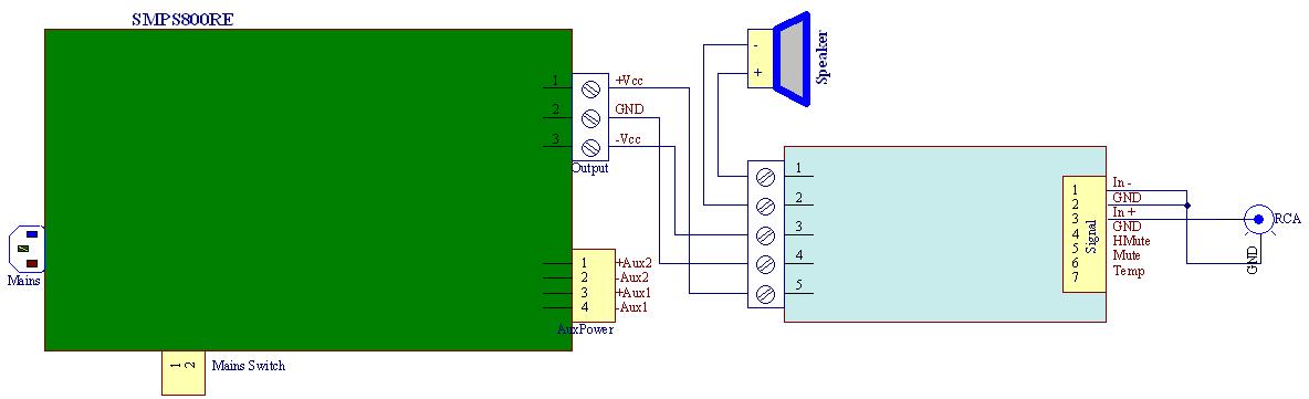

SMPS800R(E)+CxD400 Connection
I will post here brief instruction for connecting SMPS800R(E) and CxD400 modules. I hope this information will be usefull for most of the users, altough requires at least mininal electronics knowledge to avoid smoking-out the boards. At the switch terminals, a mains swtich must be connected (a device which has two or more terminals and when pushing a button connect those two terminals together through a mecanical assembly. the switch does not have + and - as I was asked)
To operate the CxD400 modules, only need to apply power to the green connector as is indicated in the above pictures. nothing else need just the input signal, as follows:
Signal Pinout:
pin1: Inverting input
pin2: GND
pin3: Non-inverting input
pin4: GND
pin5: Shut-down (output, will be ~5V when mute, below 0V when not mute)
pin6: Mute (normally unmuted, need to pull to GND to mute)
pin7: Temperature feedback (output voltage proportional with the temperature of the heatsink)
If no other signal is needed than input and mute, leave them unconnected.
If unbalanced input is used, connect only one input for example pin1 and pin2 for left channel to signal input GND, and pin3 to Signal Input. If the signal must be 180* inverted, then connect pin 1 and as signal input and pin 2&3 to signal GND at input connector side.
