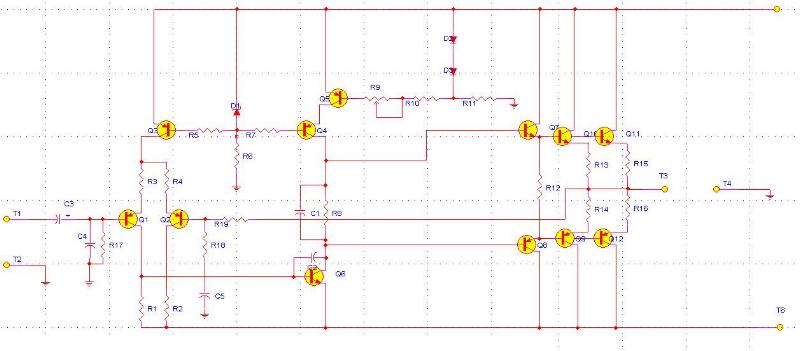

hey thanks,
the amp works fine but I want to change some things ( ).
As I've told the TIP142/147 are not enough (they blew again when I made a little mistake with setting up the bias...).
So, I think I'll get me some new components thursday or friday.
This is what I've got in mind to change:
*)when I have my new TIP's I can add the Mj15003/15004's too
*)change the bootstrapping thing (R9-R8-C5) into a current source
*)change the bias diodes and the potmeter by a fixed resistor; I will try to make the current of the current source depending of the temperature with some diodes (and a resistor) in front of the base of the current source (transistor)
*)so I have to make a new pcb too
I will publish the whole new schematic as soon as possible...

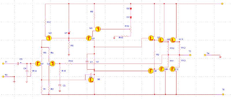

Re: the global view of the new schematic
Harry:
Very important point. Got your ruler ready to rap some knuckles?
Harry:
HarryHaller said:I think you are missing something .....
smoke generation - I love it, heh, heh, heh. You guys are brutal
Nelson Pass said:... The function of Q3 and 5 here is
clearly to implement smoke generation....
- FINALLY I modified it
