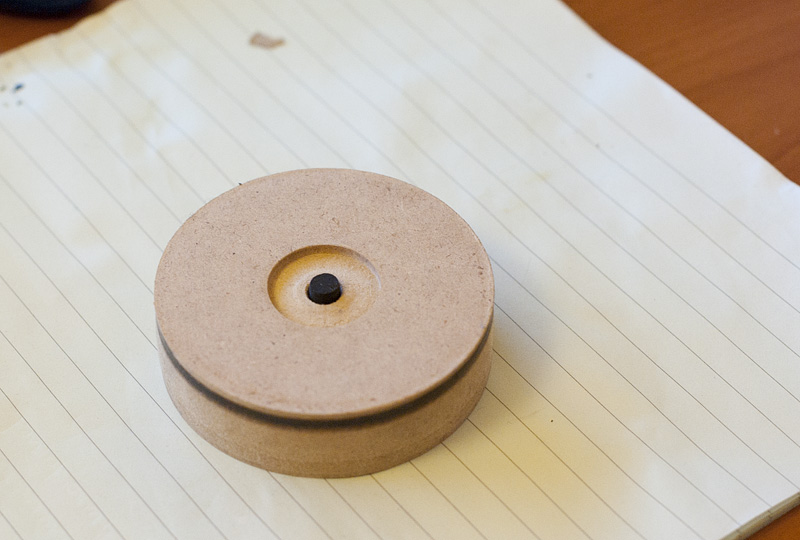

I was fooling around with more puck experiments today and just for fun i made a 73mm one made out of 20mm mdf. Well the joke was on me after all because this one gave the best sound I had so far.
This one is ~34grams which is almost half of the aluminum I ve been using so far, so it s not the weight that is doing the job.
I would say most likely the material which is rather dead sonically, and the diameter which gives a large contact area with the CD damping more vibrations, and the spread moving mass that has greater momentum and inertia stabilizing motor ticking. One thing that was annoying was that towards the end of the disk, if I skipped a track the transport needed a second or two to stabilize the speed, which was translated into some sound stutter. Probably because of that momentum/inertia.
Definitely worth further exploring...
I will try to get some 10mm mdf and repeat the experiment...
Damn... so many options... so little time...

I can understand your results because the damping factor with the MDF is huge....usually useless because of the low resonance as a side effect in audio but for this purpose.
I had the same with Delrin....however the ebony puck gave it a pleasant liveliness again..so as a combo a bit of best of both worlds...
