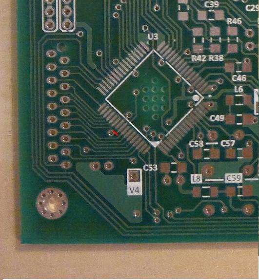

Here is a pix of where to cut. Be careful and use a sharp pointed X-acto (Razor knife/scalpel...).
The trace is very short. The via is to power. Put the resistor from the via to the pin and don't add a cap.

Placing the resistor in that place is not the best option because LC78601 pin 22 will be affected as well and this may degrade DSP performance.
The mod can not be performed if LC78601 was soldered.
You need to perform the mod before soldering this chip.

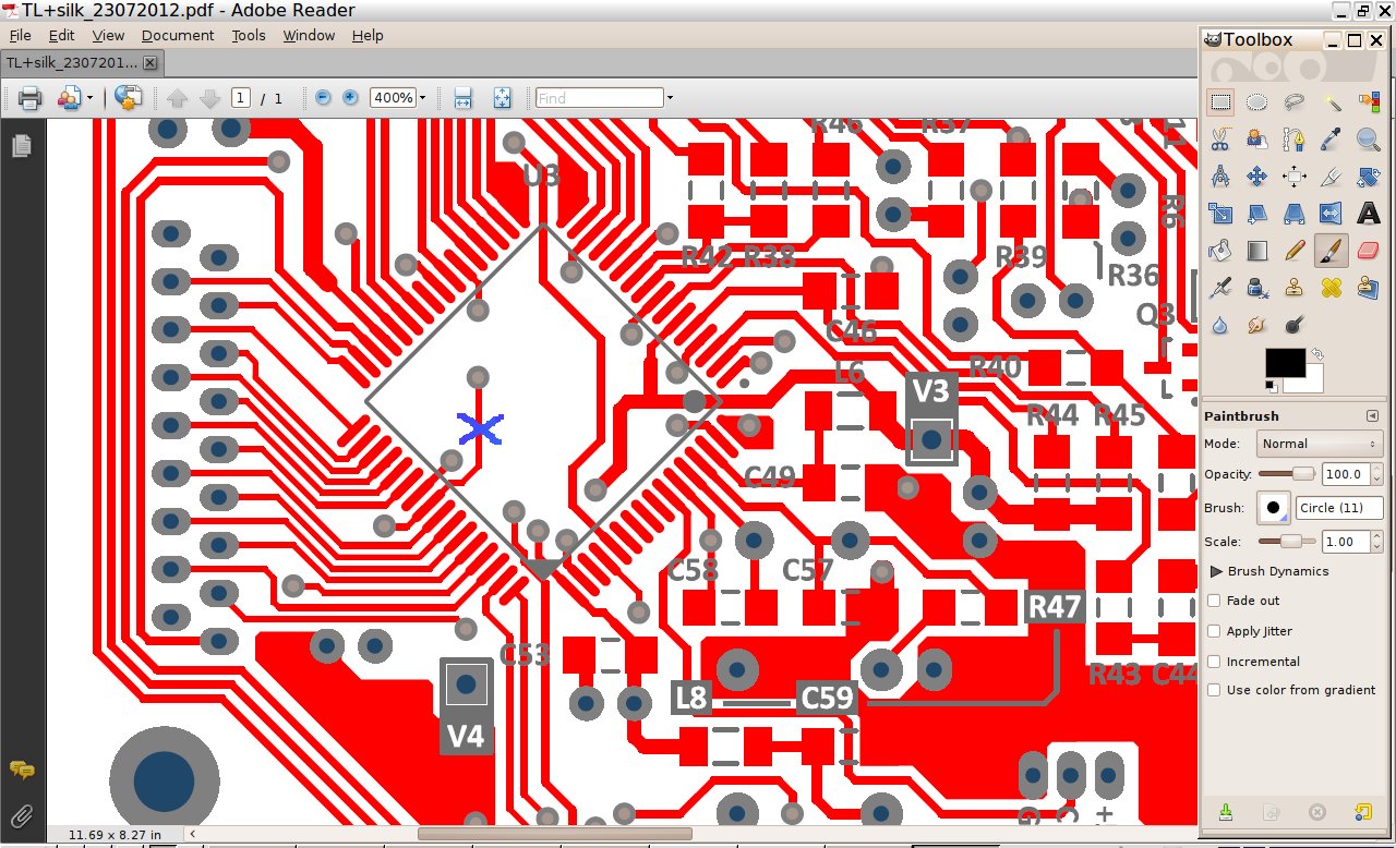

First you need to cut the trace between pin 40 and pin 22 as per top_modification.jpg - left picture.
Than, turn the board on bottom and perform the modification as per bottom_modification - right picture. Instead L7 put a 1K2 resistor or a 2K potentiometer to get your preferred contrast and make a strap between two pads. The strap will bring back Vcc to pin 22.
That´s all.
Tibi

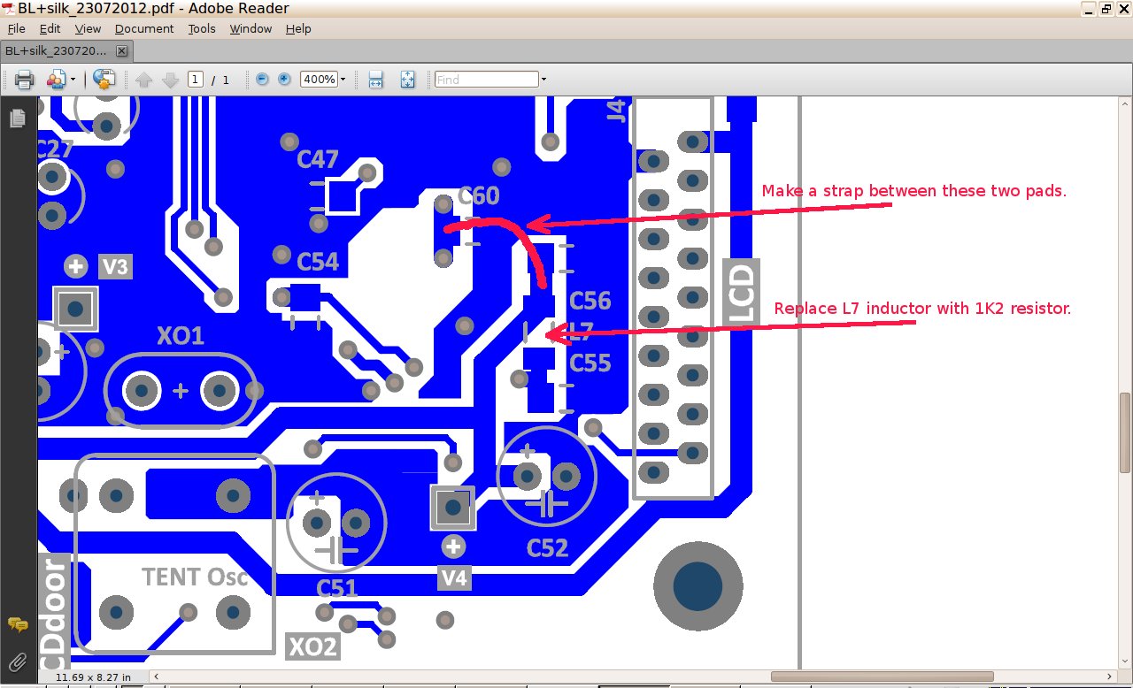

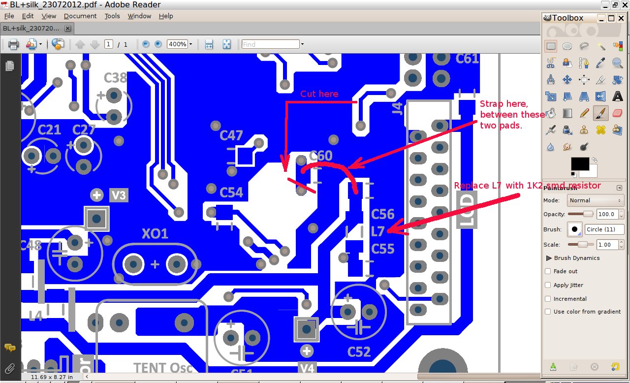

Ok, I found another solution who will work for everybody.
All modifications are only on the same side of the board, so no need to do prior mounting LC78601 and the mod can be applied to existing Shiga´s as well.
Cut near C60 as in attached picture. You may need to unsolder C60. This will separate power supply pin 22 from pin 40.
Replace L7 with an 1K2 resistor and strap two pads in order to power back pin 22.
That´s all.
Tibi
