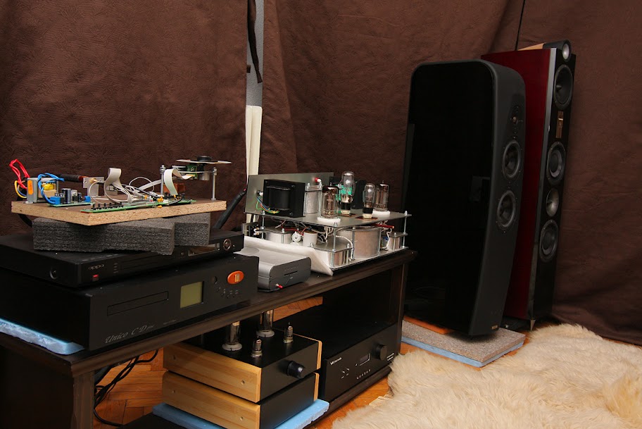

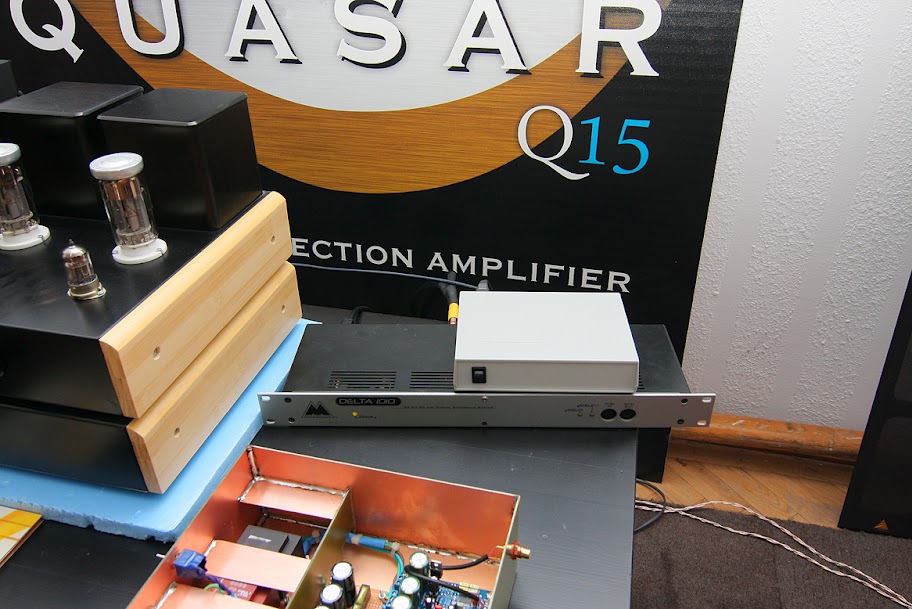

I have use/listening the Shiga CD transport (vicol audio testing version) with the following DAC :
CS4398 :
24bit/192kHz DAC CS8416+CS4398+CS8421+Transformer Up-sampling,USB, DIY | eBay
AKM4398:
http://cgi.ebay.ie/ws/eBayISAPI.dll?ViewItem&item=320808773266&ssPageName=ADME:L:OU:IE:1123
also DAC Assemblage with pcm 1702 (the one on partsconnexion)
Parts Connection Assemblage DAC-1 D/A converter kit | Stereophile.com
Interconect vicol audio silver/gold ,
Speakers : Triangle Antal EX , BEETHOVEN BABY GRAND , Triangle Quartet and Nuova Opera Seconda
my top listening with SS amplifier (Vicol audio Quasar amplifier) :
1.CS4398
2.PCM1702
3.AKM4398
my top listening with TUBE amplifier SE (GU50 final pentode class A and 6n5p srpp in front) :
1.AKM4398
2.PCM1702
3.CS4398
mytop with listening Tube amplifier PP (6P3S PushPull amplifier with differential 6N9s splitterin front and EF86 as the line in) :
1.PCM1702
2.=3. CS and AKM sounds almost the same
There where some test also with some Wolfson WM DAC but i was not on site on that listening sesion
and I cannot say how it sounds .
I am on the GB for ES9023 DAC so soon will be testing this DAC also with vicol audio Shiga CD transport..
Remember : the top is made by my feelings and liking and is a subjective top .
No one was hurt at the audition !

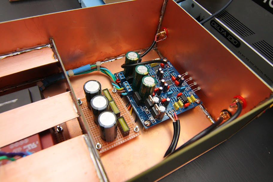

Just a small observation to Dan´s post.
Assemblage DAC-1 D/A is a modified unit with CREE rectifiers and discrete Burson opamps.
Tibi
Yes heavily moded that DAC Assemblage with pure silver inside for connections to RCA , also was tested TDA 1541 NOS and do not impress me (good DAC but a little out of my taste ) .
Also tested : Nakamichi DAC 101 TDA1541 PP in differential mode with upsampling from Pioneer chip !
Sounds very very good , but as this is something vintage and very rare do not posted impressions about .
Also was some 2A3 class A tube amplifier and EL509-02 PP class AB1 and one SRS551 spud tube amplifier for listening .
Everyone was impressed by vicol audio Shiga CD transport as this was by far the most high-end transport / best sounding transport listened by the people that participate on that listening session .
Also I was stunned by the quality of this Transport (again thank to the people that discovered this transport : Peter Daniel and Mr. Shigaraki ) .
