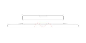

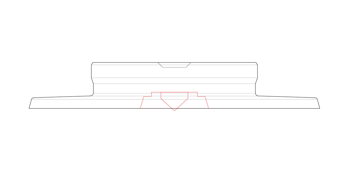

Hi Tvicol,
Other than the new PCB design, most people might also need a CD puck,do you know if there is any source to have this make for the group?
I bought a aluminum CD puck originally made for CD Pro M9 and M12 but not sue if it will work for the Sanyo Laser or not, will find out later.
Funnily enough I just came up with a drawing for a redesign of the magnetic puck to be turned from aluminum on a lathe...
It basically has the same dimensions and would have three pockets on the underside for small neodymium magnets.
Have a look... and open to any suggestions.

Of the different custom pucks tested by forumers so far, my understanding is that the best sounding were the ones turned from hardwood (ebony), not aluminium. Admittedly, they were also the most expensive ones... I don't think anyone compared the custom pucks with the 3-ball mech though.
Here is (more or less) the start of the big puck discussion:
http://www.diyaudio.com/forums/digital-source/120229-finally-affordable-cd-transport-shigaclone-story-64.html#post1781594
Also, Peter posted a drawing of puck dimensions here:
http://www.diyaudio.com/forums/digital-source/120229-finally-affordable-cd-transport-shigaclone-story-72.html#post1906228
