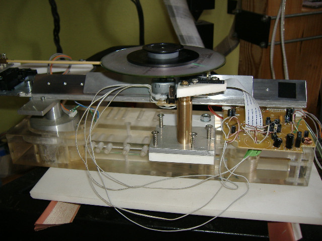

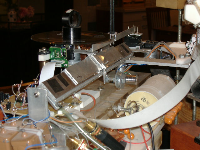

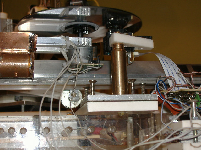

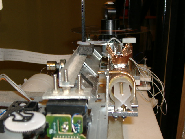

Hi Eric,
I will explain the realization only because attach files don't work(maybe there is some 24 hours attaching limit, I have no idea what is the problem).
The cd lens is fixed with possibility of inclination and rotation.The disc is placed on the air bearing which movement is controlled by actuator from outside and the actuator is mechanically coupled with disc assembly by two tiny carbon sticks.Then the saddle of the bearing is dampened in silicon oil bath to reduce cd spinning vibrations.
The result is 1/3 of time to read TOC regarding standard mechanism.All together is better than standard mechanics especially the dinamics and bass.Treble and mids are more natural and without sibilance.After all the disc is spinning on the air and the lens don't receive punches from the disc and actuator so the sonic result is obvious.The whole assembly is extremely silent and I remember how noisy it was in original version.
I'll try to post pics tomorrow.
Yes Leoparleur, the CD hover might be a next step, who knows.

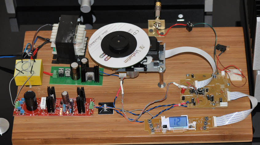

Hi all,
I've been listening and tweaking my "Shigaclone" for some weeks now.
Expectations were high before first try but i was a little disappointed at first listen because i have a very good reference, Shanling 100MKII with all new Rudolf modified IV ( moded by ZM, implemented by yours trully ).
I've replaced transformer, split supplies and made a shunt one for the 5V and all these mods have steadily improved the sound, especially the new 5V supply.
So yesterday i decided to try detaching the electronics from the transport itself, this was easily done and after putting the thing together again i listened for change.
Sound was gorgeous....but drive was skipping ( loosing lock ), this confused me because it played flawlessly before and i made no changes except a longer flat cable.
There is a major improvement in sound...when i can hear it...but the skipping i have no idea what is provoking it.
Any suggestions from the more experienced on this issue will be very appreciated as now i can finally hear, albeit bits at a time, the magic.

Joined 2006
Maybe you bend the board a bit...try loosening the 2 screws a bit.....
Thanks Erik,
That though came to mind...so i'm building a solid cnc base with the 4 pillars,
hope that works.
I got two other spares, tried those as well...even worse.......:mad:
Thing is i did not over-tighten the screws, did the loosening up bit and that didn't help much, although some change happened....it just skipped in different places.
It was rock solid before so i don't understand why it's so delicate now.....
