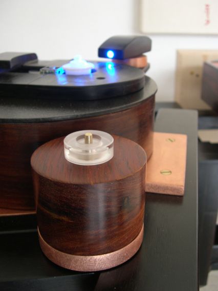

Today I made a Puck-Rest.
Sometimes I seem to loose it on the floor and besides this it enables me to switch between Ebony (Fran the Man :cool:) and Acryl.
For those interested how it is build:

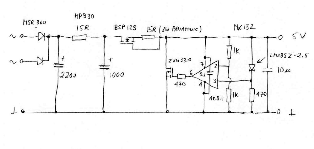

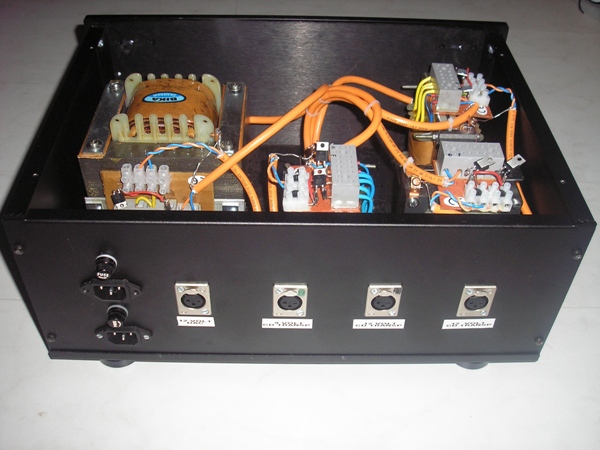

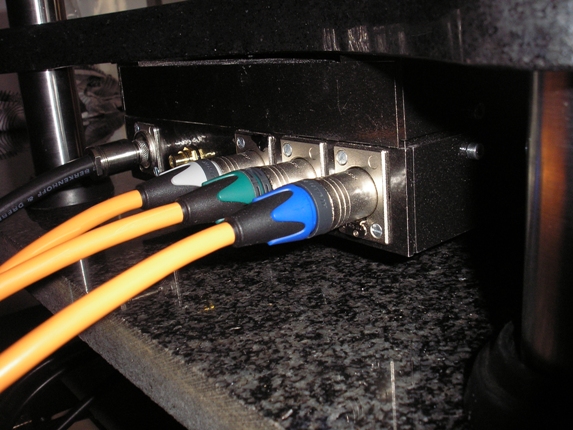

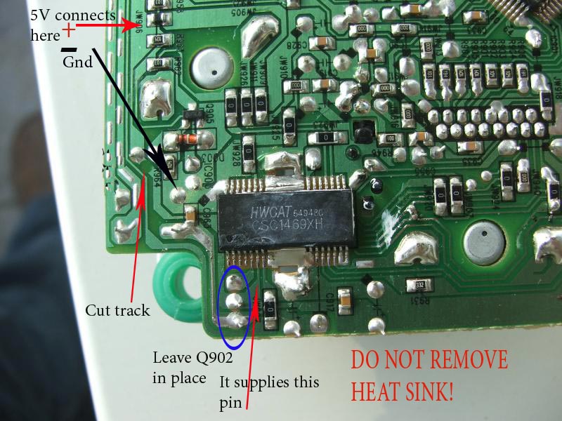

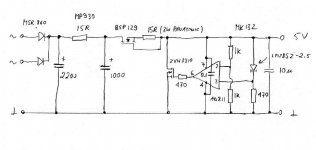

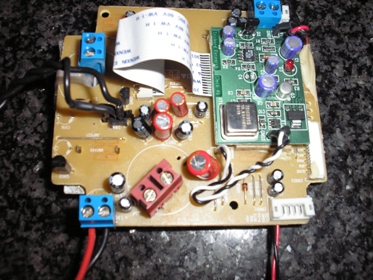

ALWSR +5 volt power supply.
What strikes me is that there are no more than a few people that have tried a separate ALWSR +5 volt power supply.
And a separate power supply plus ALWSR Regulator for the Trichord clock 4
Everything about the sound quality is told here in this thread.
Rudy

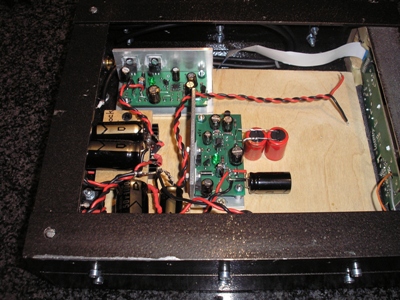

Hi I have been testing bouth Nichicon muse and Black Gates , I cant tell the differents if someone takes a blind test on me i will not be able too tell what is what
I was actually meaning to post the results of my capacitor tests, but somehow never got round to it... hope they will be useful to someone:
PS Capacitors
Black Gate STD 1000/50 plays with crisp and clear sound, it seems to add something of a "loudness" effect, putting emphasis on the treble and also highlighting the mid-bass slightly; two of them in a PS will result in a sound that's bright, with slightly boomy bass.
BG FK 2200/35 plays in a mellower "analogue-like" manner, but if you put two of them in the PS, the effect will be a sound that is a bit dull.
I can se why Peter likes the combination of the two - the FK takes the edge off the STD, and STD gives some spark to the slightly boring FK sound. It is a very natural sounding combination, and pleasant to listen to.
I also did some experimenting with BG N 100/50 (simply because I have quite a few at hand). 100uF before and 100uF after the regulator was causing problems with spin-up, but connecting 100+100uF in super e-cap configuration before and after the voltage regulator worked practically fine, played with wonderful midrange (in fact, probably the best midrange I've heard in my system), in a typical BGN mellow/laid back manner, wonderfully natural and detailed. Unfortunately, bass was relatively too quiet (it still sounded very natural though and it took me a while to notice that something was actually missing).
Combining BGN 100/50 with the BG STD 1000/50 was a good move and that's what I was using for a while, but some bass was still missing, so I reverted to the conventional (i.e. recommended by Peter) capacitor combination and I’m very happy with them.

C906
This capacitor (the original C906) should be labelled: “Here be Shigaclone magic”. It is insanely difficult to find anything that could even come close to it.
I first tried substituting it with a 0.1uF Black Gate NX Hi-Q (as we all know, possibly be the best electrolytic capacitor ever made), and while I liked its natural, relaxed tonality, there was no question that it had less of the original C906 “magic”- this ability to tell you who’s playing where and capture those minute reverberations and “live performance” feel.
I also tried a few film capacitors in 0.01uF value, as suggested by some in the original (Polish) Shigaclone thread - none of them worked well though. Even Vishay MKP-1837, a decent film cap by any standards, fell a long way short of the original C906 electrolytic, giving a flat, un-engaging sonic presentation.
The only cap that came close, and even surpassed the original in some ways was a 0.01uF/400V Multicap RTX. It actually gave slightly more resolution, although the presentation was a bit “in your face”, and it didn’t sound all that natural to me either, so I reverted to the original C906, and that’s what I’m still using.
Final Notes

IMHO i think you need to rerun this regulator experiment with the regs soldered in place. They dont work properly without the input output caps close to the legs. Im not quite sure how a diode can be louder! :confused:
300VA seems total overkill for something that pulls less than 200mA.
Thats just my opinion.
But thanks for sharing the info Leon. :)
Thanks hotiron. I agree that the socketed setup is less that optimal, but every regulator had the same conditions, so I think the test was still fair. And sockets are infinitely more convenient for testing ;)
I'm not saying that diode was actually louder (well I don't know, I didn't measure it ;)), all I meant was it gave an impression of being louder: A bit more detail was audible, and instrument "attack" was more pronounced - just like it happens when you turn up the volume a bit. Anyway, the difference was small and not that important.
I agree about 300VA trafo being an absolute overkill, but my previous experiments with Gainclone showed that bigger (oversized) trafo is clearly better, so I thought the same would be true for a digital circuit. In the end, it didn't make this much difference, and if I were to make another Shiga, I would settle for some 120VA (still well oversized, but hey bigger is better:D).

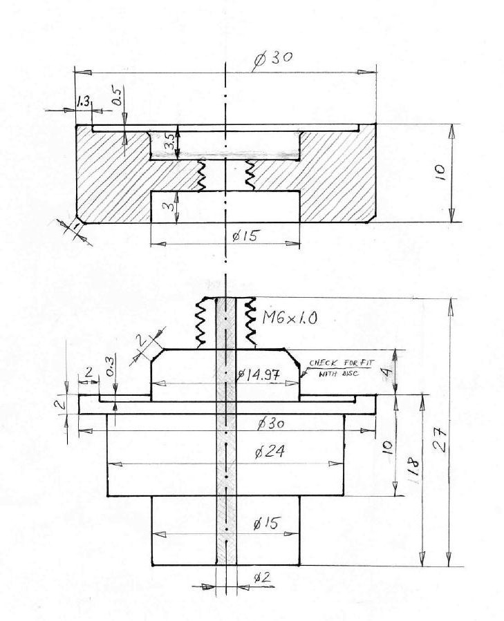

CD Platform with Puck for the Shigaclone
CD Platform with Puck for the Shigaclone.
Have just joined the company and have had a good conversation.
I put the price here on the forum so that there are multiple people that can benefit from this item.
The cost for a aluminium CD Platform with puck is 150 euro’s including polishing and anodizing (you can chose the color) excl. Shipping.
He found this a fun project and has a new machine where he can make this aluminium CD Platform with puck.
Please note, if I pass the order next week, I expect that the amount will transferred first, in order to avoid cancellation, I hope you all can understand that.
This weekend you can respond via Email if you want to order this item.
Here you can see the company website where I order the CD Platform with Puck: www.dondorff.nl
Rudy
