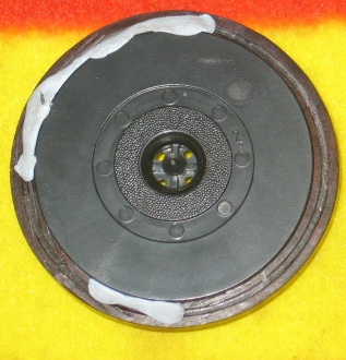

coupler new mods
ebony puck gives a smoother more refined and tonally more accurate sound. ??slight loss of detail or rather midrange obscuration but realism from tonal accuracy is worth the effort. Also if you remove the magnet from the original puck also better - surprisingly stable, gives more presence.
exchange the clock caps with 100pf polystyrene caps. Dramatic increase in dynamics and detail slightly less refined sounding though.
Need to burn them in.
Using springs or wood under the transport surprisingly less obvious changes noted.

Get a grip on reality before you start going on about tonal accuracy
You obviously need to burn in your ebony puck also!!!!

audiojoy said:please see attached photo
ebony puck is from a set of cup 'mats'
drill a hole in the middle and fit the puck without magnet or magnet holding cap.
It seems plausible that you are actually just having a laugh
