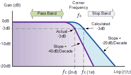

For example here is a good basic article Low Pass Filter - Passive RC Filter Tutorial and I don't believe there is a mention of Q. Anyhow I have attached a figure from it, and as you said, you can see how the -3db point changes with the order of the filter, but this is nothing that you couldn't adjust in your design. But you wont get a flat response like the Linkwitz-Reilly in the crossover. When summed the butterworths have the center hump. But if its for a speaker system, you're probably not getting a flat response for most consumer type systems anyhow, a lot happens between the crossover and the ear.
The reason I'm chiming in is because I'm hoping someone will want to explain the concept of Q in low and high pass filters, it just seems a little nebulous to me at this point. I have seen damping and Q factors in equations, but I just don't understand what they're talking about.

My question is really, what is the definition of Q for a low pass filter for example? I'm just asking because I don't know. Is it a measure of the slope of the curve at the -3db breakpoint? I see people talking about this a lot, but I haven't really found a definition that is intuitive.
Thank you Nigel for you're comments I have been learning a lot from your posts.
