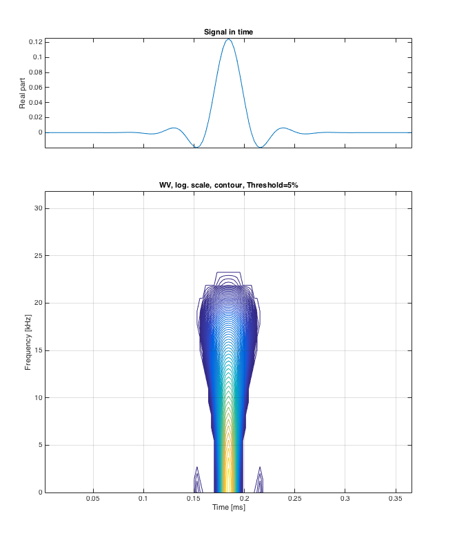

I haven't listen to zfe's NOS filters, so can't comment directly, but a lot of what is going on is to do with perception of frequency response. There are at least two things happening simultaneously as far as I can tell.
Altering the transition band and/or window has a greater or lesser effect on the roll off in the audio band. Some of the filters are 2-3dB down at 20kHz and can be 0.5dB down at 16 or 17 kHz. The C128_100 is down by 0.05dB at 14kHz, 0.1dB at 15kHz for example.
This seems to change the tonal balance of the DAC to make the bass and lower mids more prominent rather than just making it sound rolled off.
You can see this occurring in the wv plots. The main part of impulse below 5kHz essentially doesn't vary.
The second thing that appears to be happening is that as the frequency increases the amplitude of the impulse decreases but it's spread in time increases, so the energy from the impulse smears in time.
What I'm finding is if you use aggressive windowing like the Chebyshev with 180dB side lobe suppression (see attached for C128_180) is that the HF time spread is reduced, but the amplitude remains roughly the same, meaning there is less overall energy in the mids and highs, which tends to make the bottom end sound a bit more weighty.
The main sidelobes seem to have an influence at low frequencies, and these may well contribute to perception of "better" bass by spreading the energy in time.
So I'm a bit torn. The things that look like they might contribute to "better" bass are precisely the things we are trying to avoid - steep roll-off and lots of pre-post ringing. On the other hand the things we think we like - slow roll-off and little pre/post-ringing by definition will reduce the amount of smearing, and side lobes, meaning the impulse is cleaner, and the sound more tightly focused.

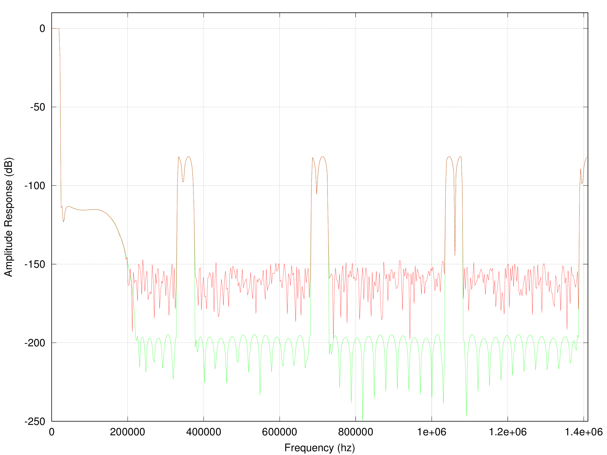

While experimenting with frequency response plots (with octave) I noticed two things:
1. For plots of details the standard setting (length of the DFT) is too short.
2. The effect of the reduced resolution of the coefficients is only visible in the stopband attenuation.
As Illustration. I use the stock FIR1 and FIR2 filter, the plots are for the combined filter (FIR1, upsample, FIR2).
First plot the frequency response up to the Nyqvist frequency. Green the full double resolution of the coefficients, red reduced to 30 bits.
You see my second point.

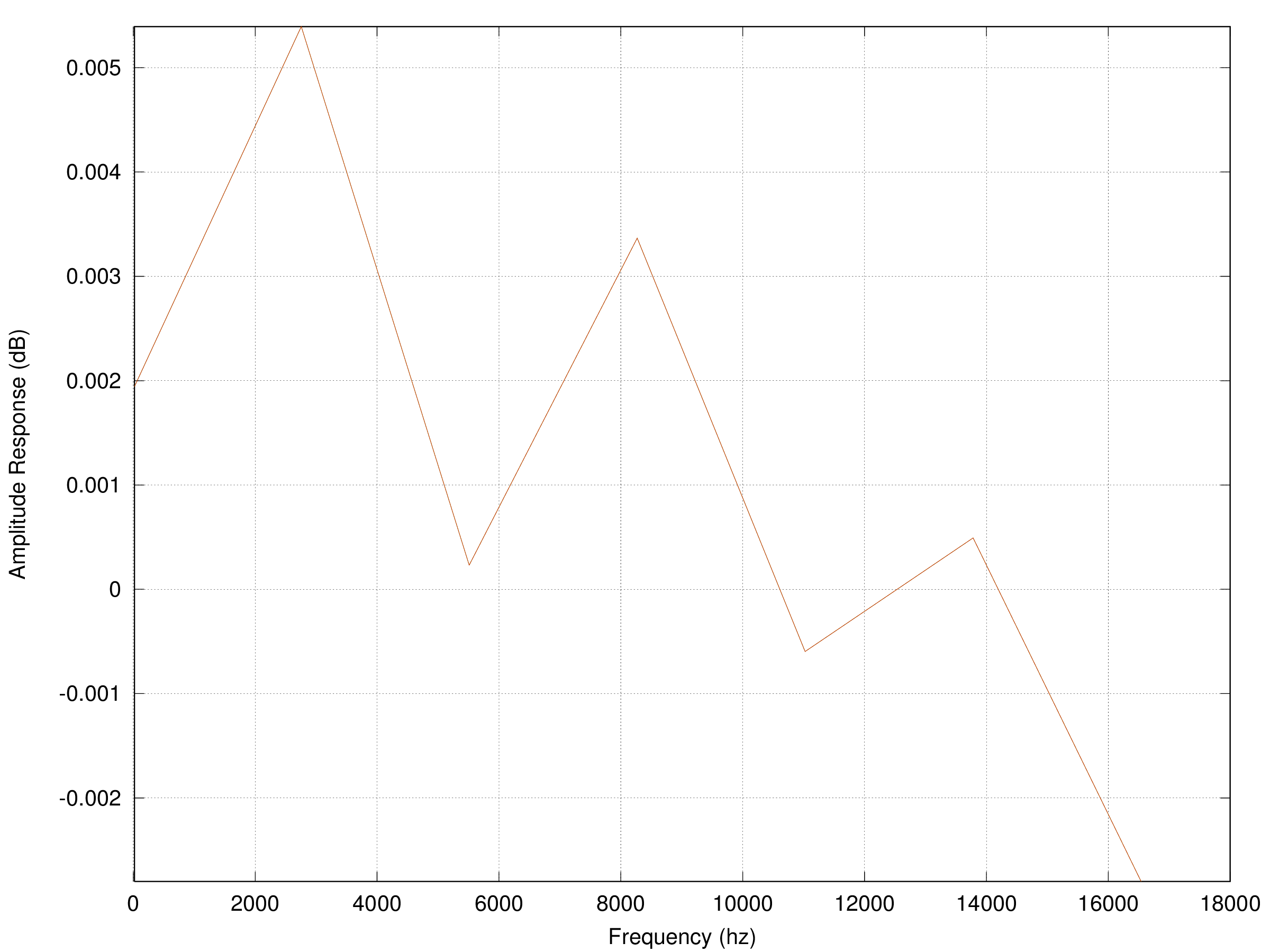

Next plot detail of the passband 20-18000Hz, obviously we have a problem with the frequency-wise resolution.

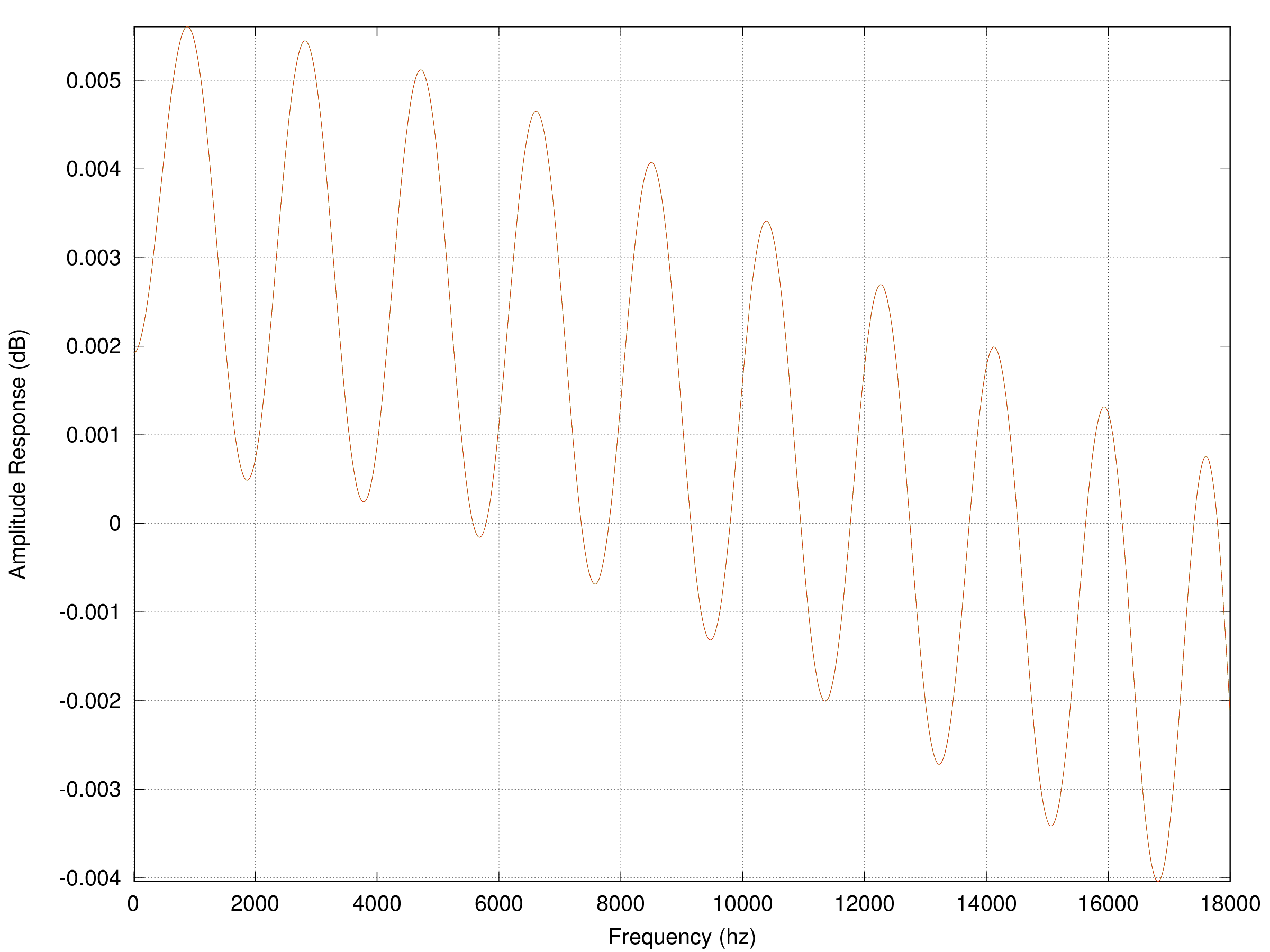

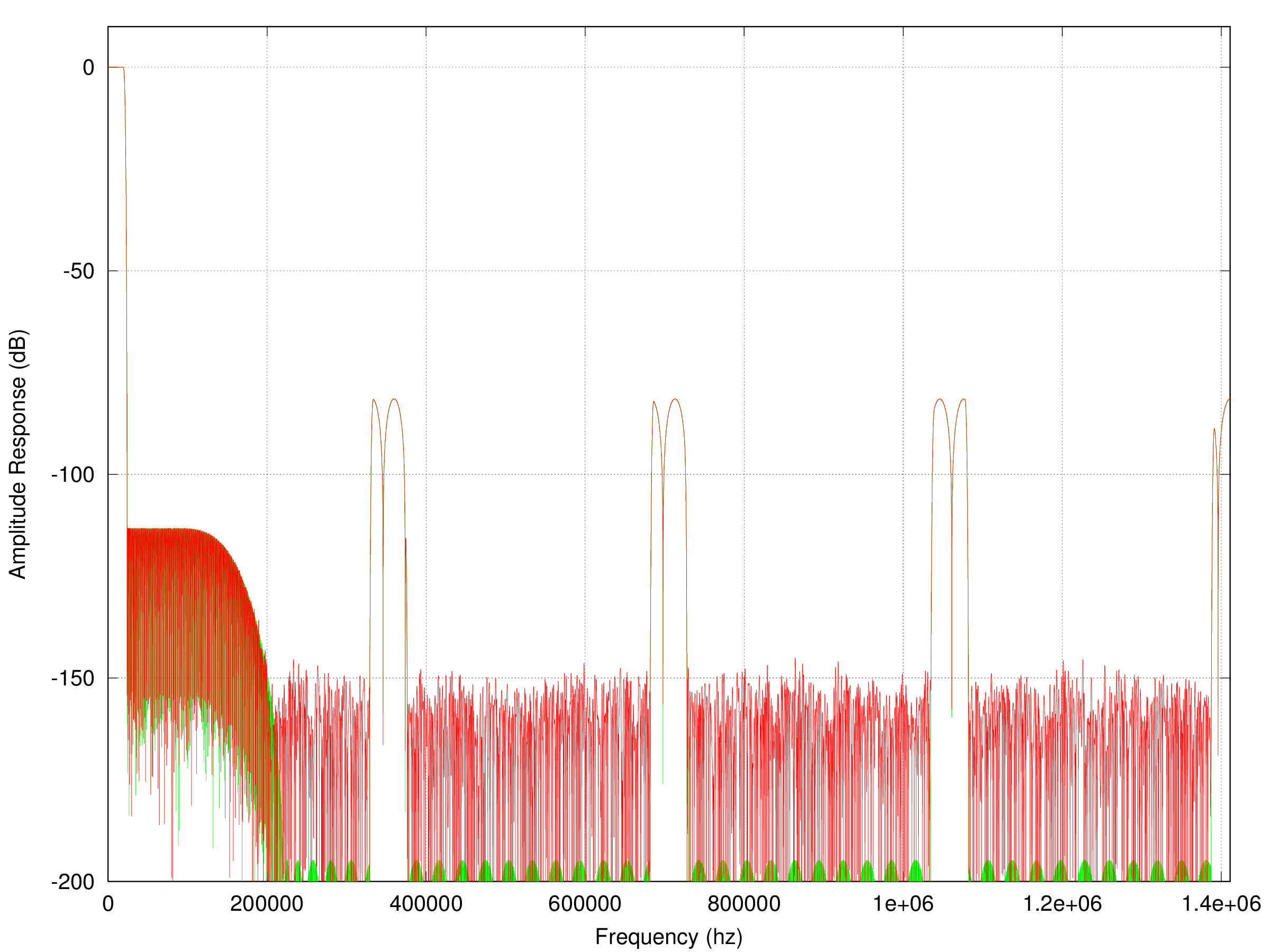

Next plots with DFT length 2^18
For the full frequency range we get not much more information, only more oscillation in the stopband.
The detail plot of the passband now looks nice.
